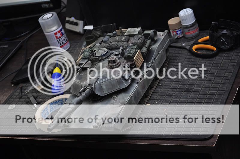

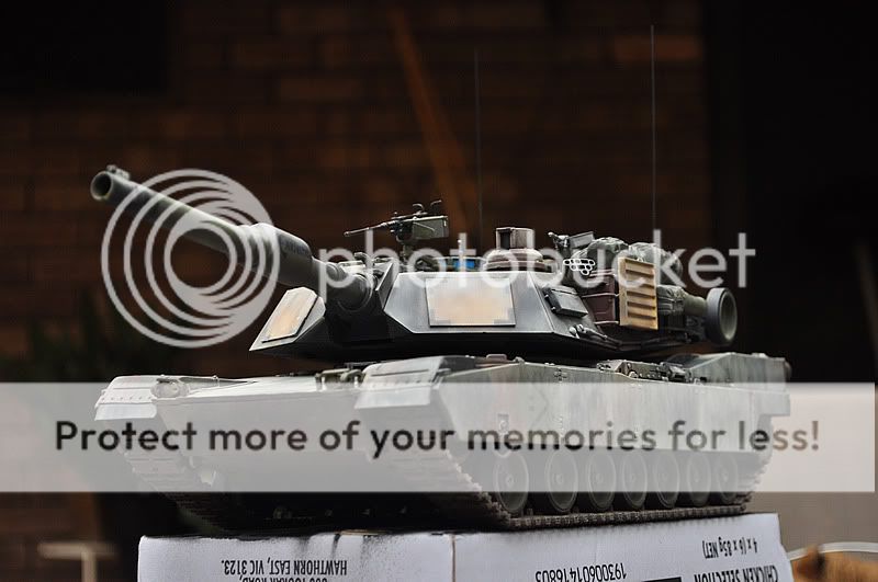

Hi Matt, im new here, looking at your suggestion above, is that mean that there's no coat to protect the white-ish weathering on the model? I'm in the middle of completing my weathering finish on M1A2 tank. I'm using Tamiya Weathering Master NATO paint M1A2 to have the desert dust look on it. I then sprayed Tamiya Flat Clear (TS-80) on it, resulting the weather finish to disappear. I guess it reacts towards the wet spray paint. So i have to re-do it again. This time i decided to join in here and find out what's the solution for this type of problem?
Ref photo
Thanks in advance.

Welcome to Armorama! Yes, if you use pigments, pastels, or any kind of weathering powder, you have to leave it exposed to retain the dusty look. The best thing to do is mount the model on a base so you don't get fingerprints on it.
If you apply a clear carrier to a pigment - you get paint. And you lose the effect.

(deep Breath... Siggghhhhh)
Thanks Tom, your feedback at least clear up my mind thinking about this... Appreciate it..... is there any other way instead of usign the Weathering Powder?
SSGToms
Connecticut, United States
Joined: April 02, 2005
KitMaker: 3,488 posts
Armorama: 2,984 posts
Posted: Tuesday, January 03, 2012 - 06:16 PM UTC
You can apply dusty layers by misting the model with your airbrush, using Tamiya buff and deck tan.
