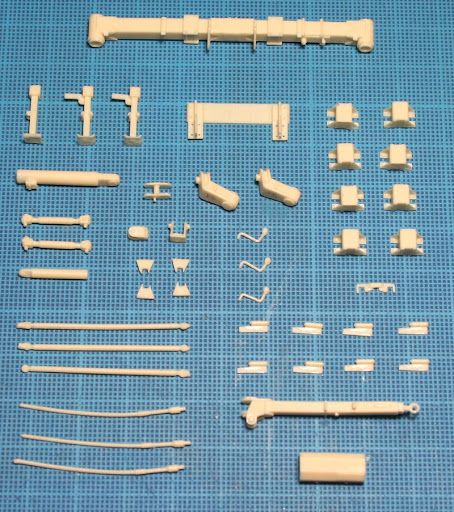

I've finished the SPARK..except for the tiny bits which I will leave for the last..
Made some simple modifications and the thing is positionable!
I had a lot of trouble lining up and gluing the rollers and arms to their base so they will sit leveled on the ground. I still need to make some minor repositioning to equalize the gaps between the rollers..as you can see.
Blast-models had not made firm alignment joints, so a very slight difference between each set of roller assemblies and the whole thing was off! But then..I am quite picky on perfection.
360 degrees Rotating Rollers...
Workable Arms......
Using 0.13mm styrene sheet, I'm also making the covering for the floor... quite the b*tch.
