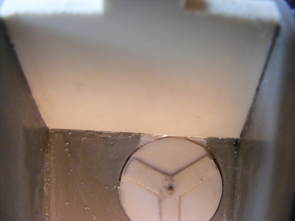

The Porsche Typ 205 was indeed a remarkable vehicle. Its width was 3.71 meters, while the Tiger was 3.70 m wide, the maximum permitted for railway travel. Each track had to be as wide as possible (1.1 m), so not that much room left...
Its internal layout is as follows: in front were the driver and radio operator, to their sides were the fuel tanks, the internal combustion engine was next, with its auxiliary systems to the left and right. The generator was behind the engine with some ammo storage above the tracks. The electric motors were last, you can see the rectangular depressions where they were located in the picture above.
I've finished the escape hatch, this is how it looks on the outside:
...and the inside:
