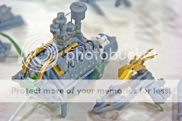

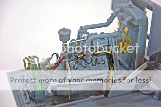

To get started, I did go with the kit's recommended step number 1, the full engine build.
Riich gives the builder a very complete Ford Flat-head V-8 engine that I found a joy to build. In fact, it was so nice that I couldn't resist adding and few missing details and then planning my completed build around some way to display the engine. More on that idea later.
Here're a couple pics of the completed engine:

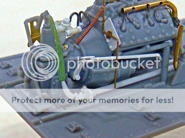

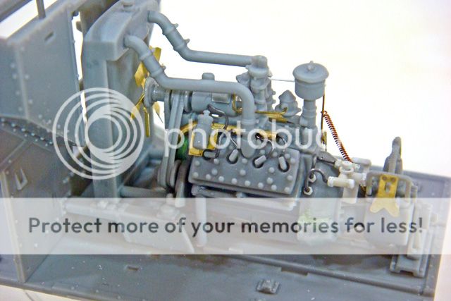

These two pics show the engine dry-fitted into its compartment. Note that the engine mounts, radiator, fan and generator, and forward firewall are all just press-fit on. It all comes apart for painting later.
Here's a pic of the engine removed with the radiator, fan and generator and motor mounts removed:
Just about everything in the photo that's not gray plastic has been added. (The fan and coil mount are kit PE.) The major missing parts are the "crab" distributor on the front, the conduits for the ignition wires and the clutch lever and linkage.
I've also added the fuel line from the fuel pump-filter to the carburetor and the throttle linkage to the carb.
I have extended the transmission shifter lever down about 4 mm and terminated it with the socket to receive the shifter linkage ball (scratch built but not shown yet).
Still to add after painting are some of the electrical wires (coil to ignition, generator to driver's compartment, and the water temp and oil pressure).

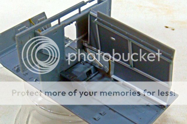

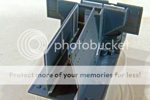

Terry Ashley made a very good suggestion in his PMMS build review that the kit assembly sequence should be modified to allow the floor and interior to built more easily.
Riich would have you add the hull side walls and then build the steering and brake linkages, add the engine and compartment, and then complete the driver / gunner forward compartment. This is just possible, as Terry demonstrated in his review, but it really makes no sense. It also makes any interior painting very difficult, if not impossible.
Also, I intend to add all three crew figures. In order to fit the crew into the vehicle, they must be assembled at the same time as the carrier or it will be impossible to get them to fit later.
With this in mind, I've skipped all over the instructions to build sub-assemblies and finish the hull floor and much of the front crew compartment first.

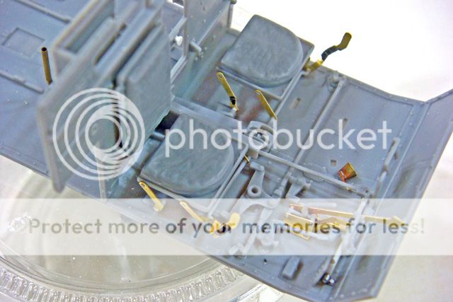

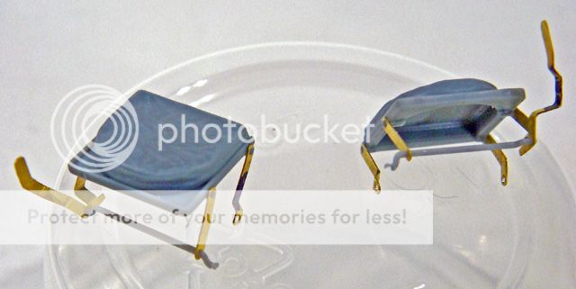

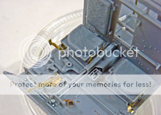

After the engine, I added the floor hing-mounts for the front seats and then built the seats.
The seats were quite challenging, and I had to clean-up and dry-fit the lower hull sides in order to get the kit PE adjusting levers folded and fit. These levers will actually be trapped into a plastic crescent-shaped brackets on each lower hull side. However, I wanted to leave the sides off until later so that I could access the floor.
The seat floor hing-mount pins were short molded in my kit, so I replaced them with cylinders punched from sheet styrene that will hold PE the seat frames.

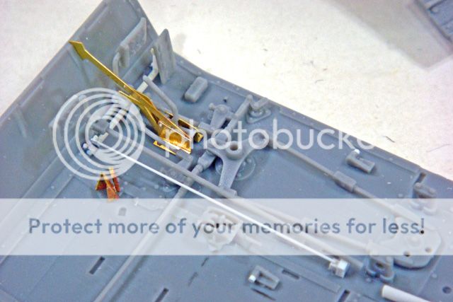

After building the seats, I finished up the steering and braking linkages. I have added the throttle pedal crank and linkage (white styrene).
The PE parking brake assembly has to be fit at the same time as the brake pedal linkages. Note the PE parking brake linkage also attaches to this same pedal.

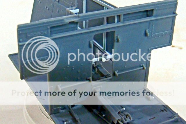

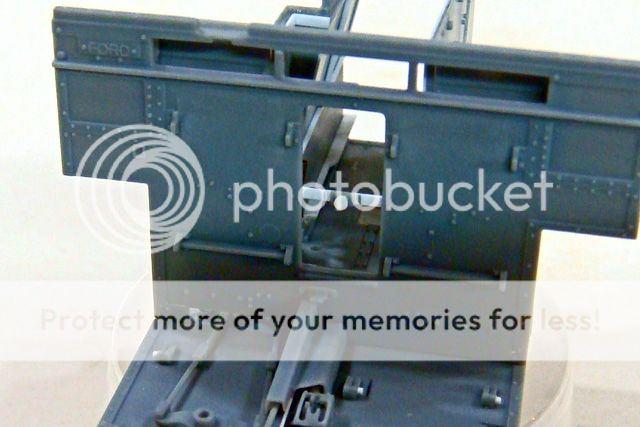

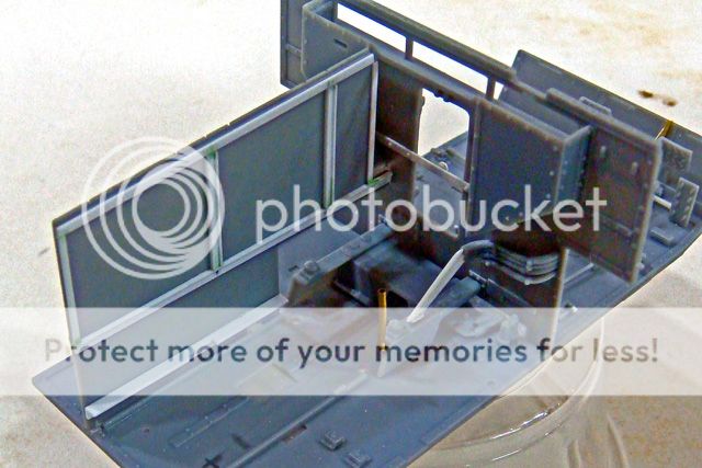

Ok, so all this has been building up (no pun intended) to getting the front driver-gunner crew compartment organized so that I can pose / fit the driver figure.
Here's the compartment with the firewall and seats now dry-fitted:
The fact that all of this is pretty much just press-fit together and holds is a testament to the precision of the fit on the kit parts.
I have found a few short-molded attachment pins and/or alignment holes that are too small, but once these have been adjusted, the actual parts fit has been most excellent.
The instruction assembly sequence is crazy, and I particularly could have used front and rear elevation views of the seats and some folding measurements for the seat PE. However, with these few exceptions, the kit has been very well designed.
To be sure, some might find the parts count a bit excessive and others will not like the fact that the kit PE must be used (no plastic alternatives are included). But I personally like the extra detail and I have no problems building PE, so for me, this kit has been very enjoyable (so far).

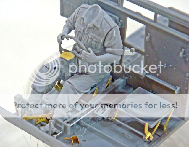

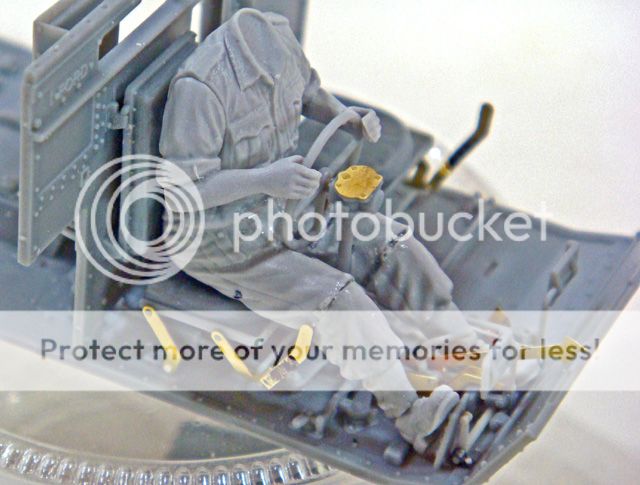

So, on to the driver figure.
The figures would seem to be the exception to the excellent design and fit of the rest of the kit. My advice is to build and fit them at the same time as the main kit. Perhaps the other two figures will be a better fit to the kit, but as for the driver...
I simply can't believe that the sculpter made any effort to actually fit the figure to the space. He's not even close.
To illustrate what I've done, here're a couple of in-progress pictures:
I started with the lower torso and legs. After cleaning these up and gluing them together, it was obvious that a lot of work was necessary to get the driver to fit.
I cut the legs apart at the knees and feet and then fit the driver's bottom and lower back to sit flat on his seat. I then angled the lower legs to bend quite a lot at the knees and finally added the feet back sitting on the floor (left foot) and on the throttle pedal (right foot).
Next I added the upper torso and temporarily attached the steering wheel to its column. I then dry-fit fit the steering wheel and column so that the column and wheel were vertical. This required quite a bit of grinding on the figure's upper thighs and lap area to create clearance room for the steering wheel and column.
Next I added the arms with the hands dry-fit to the steering wheel. That's the point shown in the photos above.
My plan is now to cut the figure's arms off at the rolled-up sleeves. I will then cut the fingers off of the hands leaving the palms.
Next, I will make the permanent glue bond with the steering wheel and column and allow that to dry hard. Once the steering wheel and column have dried hard, I will glue the palms of the hands to the wheel and while those joints are still soft, I will temporarily reattach the arms to the body.
The driver with his arms and the steering wheel-column assembly will be dry-fit back into the compartment and the hand-steering wheel joints allowed to dry hard.
I'll then detach the temp joints with the arms to the sleeves leaving me with two major driver sub-assemblies - the body and legs and the arms and steering wheel. I'll use epoxy putty to make new fingers gripping the steering wheel and clean up all the joints from re-posing the driver. I'll use a Hornet resin head as a replacement for the kit figure head.
Hopefully, I'll be able to paint the figure in three parts - head, body and legs, arms and steering wheel - and then bring them all together in the finished driver's compartment during final assembly...
Well, that's may plan. We'll see how it works.

Ah! I almost forgot one last photo.

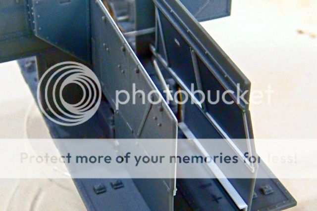

This picture shows all the above dry-fitted components and sub-assemblies disassembled. I took it after I removed the driver as posed in the last photos to show how I'm approaching the construction and finishing.
Like I mentioned, Terry Ashley suggested that the kit essentially be built from the inside out, and that's what I'm doing.
This will allow me to finish and paint all of these interior parts, assembling as I paint and work my way from the inside of the carrier to the outside.
Again, the fact that all of these parts and sub-assemblies can be built and simply dry-fit / press-fit together to test assembly and allow separate finishing is a testament to how well the basic parts fit really is.
With the exceptions of the instructions and figures, Riich has done a very commendable job with the engineering of this kit.

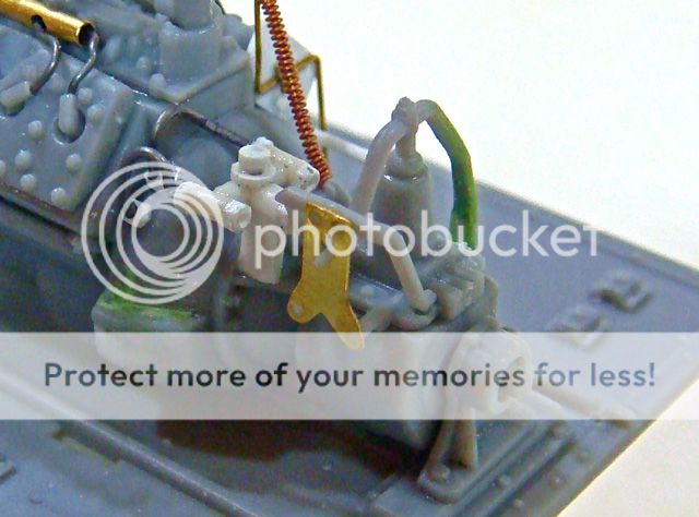

Well, after a couple of happy hours at the workbench cleaning up the driver figure, I moved on to a couple of small engine details.
The shifter-transmission linkage is an unusual affair. I was quite puzzled about how it could have worked since Riich doesn't provide the linkage parts. After some research spent looking at restored carriers and carriers undergoing restoration, I finally found a couple of pictures that showed the missing details.
The Riich kit part G1 is the inverted transmission shift lever. It needs to be extended about 4 mm, thickened up a bit with a socket drilled into the bottom end.
What's missing from the kit is the shifter linkage bar that runs diagonally under the engine and then extends upwards in a J-bend. This J-shaped part is tapered and terminates with a ball that fits into the socket on the inverted transmission shift lever.
In this photo, the inverted transmission shift lever is the thick, green-colored part (G1) and the J-shaped shift linkage is obviously the white styrene part.
I remade this part today as I wasn't satisfied with my initial attempt and the above photo shows the new part. There are two rubber (leather or canvas) boots that fit on the shift linkage tube on either side of the floor mounting bushing if you're of a mind to add even more details.
(I left the boots off of mine - Chalk it up to poor maintenance by the RCEME mechanics. Maybe they couldn't get the spare parts?)
Another engine detail missing from the kit is what I assume to be the engine oil cooler manifold on the top left rear of the bell housing. Research showed several minor variations in the design of this part, and I will eventually add the two hoses that run from the manifold to the ends of the oil cooler (kit part G11) located forward of the radiator.
Note that the oil cooler, part G11, is a pipe with sheet metal cooling fins all along its length. The restored examples all appear to be bare metal in color. This kit part was the most difficult so far to clean up while preserving the cooling fin details.
BTW, the disk on the top of the manifold is, as far as I can tell, either the oil pressure sender or perhaps an oil temp sender and will get wired up after the engine is painted.

I then set the dividers for the distance from the top edge of the firewall and the top edge of the kit's opening and scribed lines extending the kit opening to the sides meeting the earlier vertical lines.
I measured the radius of lower kit opening corners using my drill bits until I found a match (~.030 dia). The, using the matching drill bit as a broach (pushing vice twisting), I opened the new top corners until the edges of the radius met the top and side scribed lines.
The, using a brand new no. 11 X-acto blade in my knife, I carefully carved the new opening to match the side and top scribed lines. I cleaned up the edges a bit with regular files and a Flexi-file and had the new rectangular opening.
I replaced the cross brace with a strip of .010x.040 styrene strip, and added the kit knob and mount back after sanding away the excess plastic on its reverse. I added the rivets / bolts on the backside with .018 dia x .010 punched disks.
This was a quick and easy correction / change, and I appreciate Ron (who PM'ed me) sharing his research findings.
One more note: Paul Owen removed the "Ford" placard from his kit's firewall (located to the rear of the driver's head area) because he couldn't find a match in his references, but several of the photos in one of James' galleries clearly show a "Ford Canada" placard in the same location, so I've left this detail on my kit.
(Thanks again, James!)

Because I'm going to show off my kit's engine, I wanted to add some detail to the insides of the engine compartment walls.
Curiously, Riich didn't add any interior details to the side walls of the compartment. I say curiously since all the other surfaces are detailed.
Anyways, on the actual vehicle, the engine compartment is made of a frame of welded, bolted, riveted angle, U-channel and flat straps covered with removable sheet metal covers.
Because of the thickness of the kit parts, it's not possible to replicate all of the dimensions of the actual compartment frame. If this was done, the engine and walls would interfere with each other. It might be possible to thin down the kit side walls and then add the frame.
However, because of the restricted view that I'm expecting, the interior of the side walls can only be viewed at a angle from above, so all that's needed are additions that add the horizontal and vertical lines that will be visible from that direction and angle.
Here are my engine compartment walls:
The prototype carrier has a pair of longitudinal channel braces that run the full length of each side of the compartment along the floor. I replicated these with L-angle strips.
The interior side frame members were made with .010x.040, .010x.030 and .010x.020 styrene strips. I did notch along the beveled top edges of the compartment side panels using a small cutter in my moto-tool, files and sandpaper.
The final results are not a perfect match for the prototype, but they look "right" and because I did use the locations of the prototype's frame members as a guide, it's actually pretty close (given the compromises between scale-sized sheet metal and injection molded plastic).
Happy modeling,
