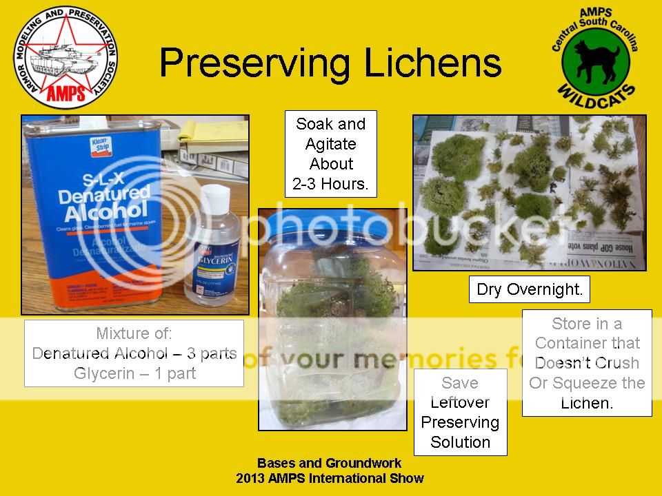

You want glycerin and denatured alcohol mixed to a solution of about 1 part glycerin and 3 parts denatured alcohol.
You can get both ingredients at Walmart or maybe Carrefour - the glycerin in the pharmacy section and the denatured alcohol in the hardware-paints section.
You must soak the plant material in this solution. Spraying it on will not work.
The alcohol will penetrate into the plant material deeper and more thoroughly than water, and it will also dry out much faster leaving the glycerin inside the plant. Simply spraying the solution will only leave the glycerin on the surface and will not give the preservation results desired.
If you want, you can add green food coloring to the preservation mixture, but even afterwards, you'll want to paint the materials to get more realistic colors. After the plant material has been preserved and dried, it can be painted with either acrylics or enamels. Airbrushing will give better results with less paint and more complete coverage.
The example in this picture was just for lichens, so for "woody" plants with stems or waxy leaves, you'll have to experiment with the time required for soaking. The colors in the examples are the natural colors, which will, as John has noted, fade over time. However, the plant material will remain soft even after the colors fade.
