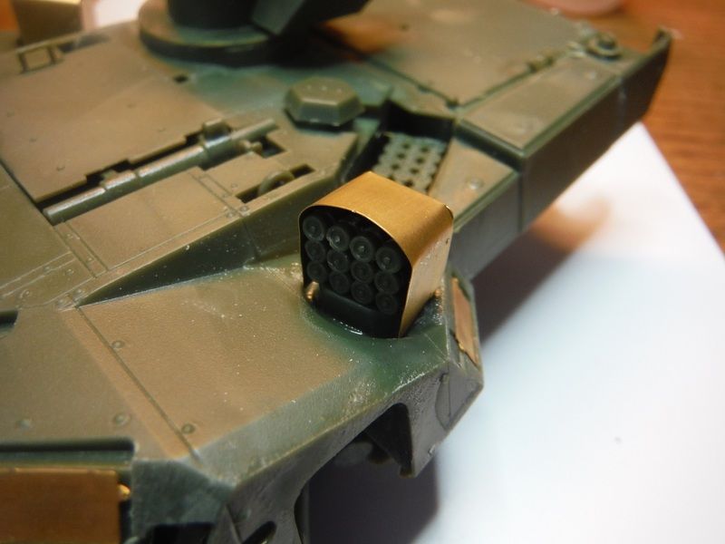

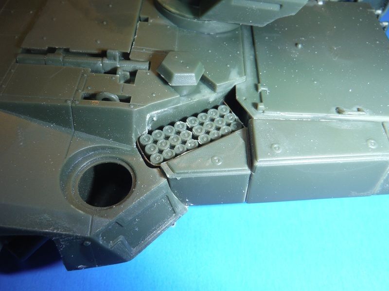

Well, is the first build update on the Panda Models T-14 Armata and Bumerang IFV. Looking through the instructions, I thought I would jump to the turrets of each since it looked like the hulls would take a bit longer with suspension and tracks.

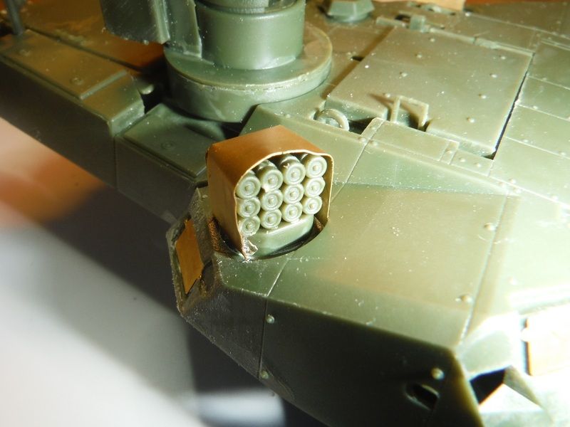

First up is the Bumerang turret. The turret starts on step 11 with the PM133 Kornet anti-tank missiles. Then in step 12, you glue the turret halves, add sights, antennas, lifting hooks and handles, and main 30mm gun and 7.62 coaxial.
Kit parts had little to no flash, but seem lines are visible, especially barrel and antennas.
Gun mantlet cover has nice folds in it and fit with out any gaps.
Right and Left sight didn't need any putty and no problem with fit.
Right, left, and rear of the turret: Fit of the turret halves was good and no putty was needed. A light sanding where the halves meet eliminated the seem and blended the halves together. Take very care with the antennas, I managed to snap the front and left rear in two a couple of times.
The 9M133 Kornet anti-missile pods needed the seem between the pods halves sanded. The photo etch cover is stiff, so annealing needs to be done on the photo etch to help bend.
Not sure what these two holes are on the bottom of the turret is. Couldn't find nothing in the instructions for them.
So far no corrections are needed to the instructions for step 11 and 12.

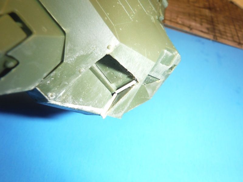

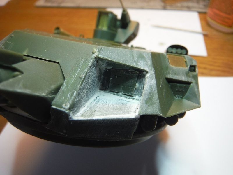

Like the Bumerang kit, I started with the turret in the T-14 kit. The turret is covered in step 9, 10, and 11 of the instruction book. Like Mark said, the plastic reminds me of a Revell German kit with the green color plastic and very brittle.
*****NOTE******* DON NOT, I REPEAT, DO NOT REMOVE THE SHADED AREAS ON PART E1 IN STEP 9. THERE IS NO NEED TO DO SO.
As you can see here, I did cut the shaded areas and in step 11 where you have to attach the top of the turret (part B6), it came to my attention that cutting was not needed. I was lucky to make the cuts clean enough to where i didn't need to much glue and putty to fix.

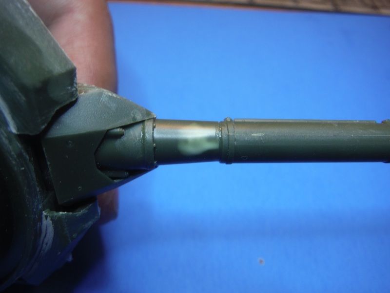

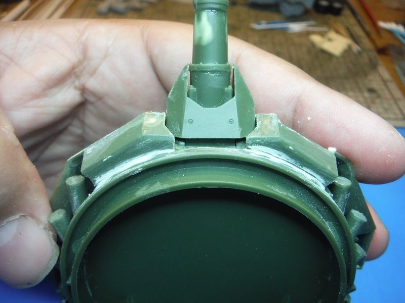

The main gun barrel had problems. To begin with, part E7 was not keyed to part D56 and D57. The hole was also to small. Sanding and carving away plastic is needed to get the barrel to fit.
And even with all that I carved and sanded, the barrel was still a very tight fit as you can see with the dis-colorization of the plastic.

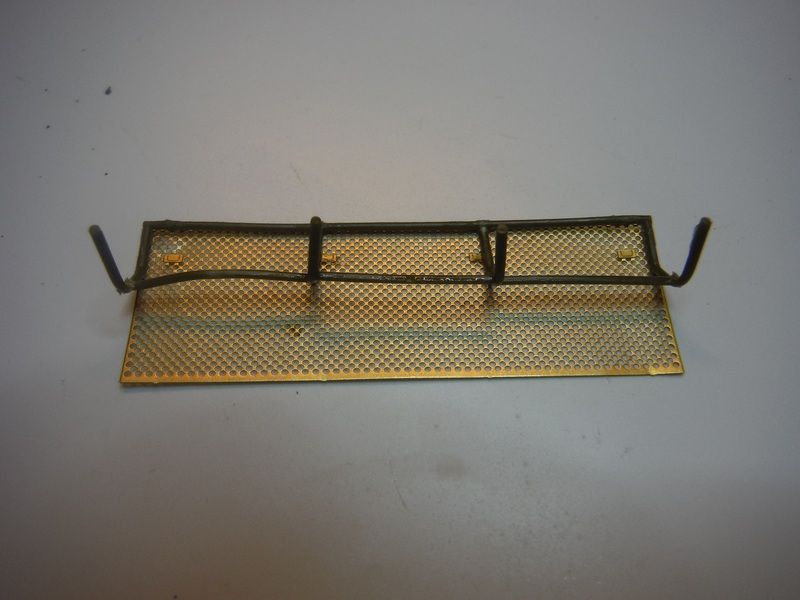

The turret basket frame in my sample kit was broken. Luckily the photo etch mesh was very soft and easy to bend. So I started gluing it to the basket frame a section at a time. Can't even tell it was broken.

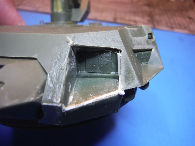

The gunners sight area of the turret was another issue. Part D40 is the piece that closes the area around the gunners sight along with the lower turret, E1 and upper turret, B6. Big gaps could be seen and pieces of Evergreen stock and lots of putty kind of fixed the issue.

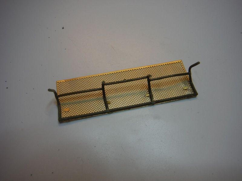

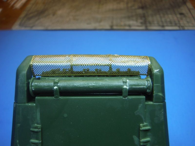

And the issues keep piling up! The photo etch coverings on the Afghanit Active Protective System seem to be to big. Looking at the picture of the real thing, the covers are squared and not curved like on my kit.
Part E9 and photo etch part PE-10 proved to be difficult. Again, it seemed that the photo etch was a tad to big or not shaped properly. I t glued just fine during step 9, but when it came to step 11 and attaching the top turret, part B6, there was an issue with fit. I had to remove part E9 and cut off the locating pins and "forced" the part back on to shape the photo etch properly.
In step 9, it is labeled next to part A33 "optional." It was unclear to what that meant, leave off or another part to replace it with. Well after fighting with attaching B6 to E1, it came to me that "option" meant "leave off." Part A33 along with part D50, D43, D44, and D51 are not seen, so there fore not needed.
In step 10, E5 is marked wrong and should be E3. In step 11, part E10 should be part C24.
Photo etch part PE-2 and PE-9 don't square off real good, so soldering will be needed to get a good shape.
In step 11, when gluing Part C24 to D34, there is no key to align parts. Glue part D34 down first to upper turret, then after putting together the rest of the 7.62 machine gun, you can glue C24 to align the gun in any direction you want.
This T-14 kit has started out with issues, but unlike Mark, I can't just box it away till another day since it is a review sample from Armorama. Next is the hull, so lets see what that brings.

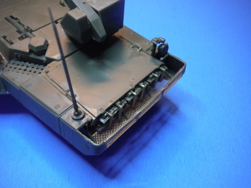

I went ahead a glued the upper hull to the lower hull to make handling easier. But first, the periscopes had to be installed. In the instructions, in step 6, the periscopes on the right are numbered backwards.
The rear of the hull posed a little problem. First, the part number for the guide horns for the spare tracks is wrong. There is no T1, so I used two T3 guide horns. Next, there was no length given for the tow ropes. I cut the ropes about 80 mm to 90 mm.
Here where the towing shackle is secured to it's latch was a bit tight. Care needs to be taken when trying to slide the shackle into the latch.
There was no issue with the front lower hull armor plate. Care is just needed when removing parts A2 from the sprue.
The suspension went on with out a hitch. Part A28 in step 1 should be A30. I left the road wheels, idler wheel and sprocket off to ease in painting the under side and road arms. I left glued the road wheels to the arms and left the idler wheel and sprocket off to that I can work on the tracks and put them on easier.
I will show better close ups of the tracks on the next update.
The rest of the upper hull parts went on with out a problem except for part D8. It is very fragile coming of the sprue and I almost broke it in several locations. Also, very much care needs to be taken when cleaning it up. Also D1 and D6 are very fragile coming off the sprue. On the engine deck, the instructions call out for two D4's and two D5's. There is only one of each. I placed them on the outside of the engine grills. The photo etch grills are very nice, easy to work with, and fit properly.
I left off part E8 and PE6, the flag staff in preparation for the flags and streamers. I placed the decals on typing paper and will use white glue to fold and secure them to the staff.
Last, I started on the slat armor on one side of the hull. The slat is a bit to thick and doesn't look to scale. The mounting bars a bit fragile when cutting them away from the sprue and ease is need when cleaning them up.
