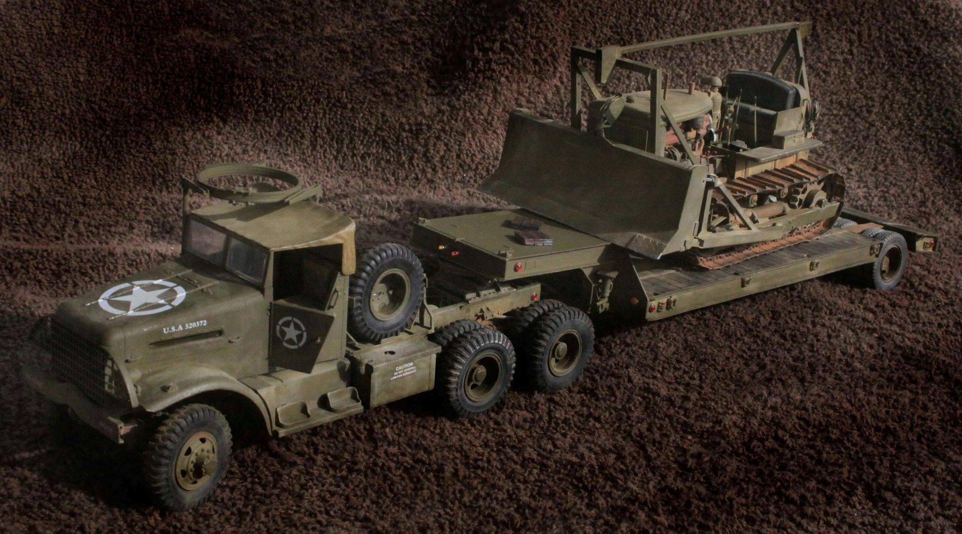

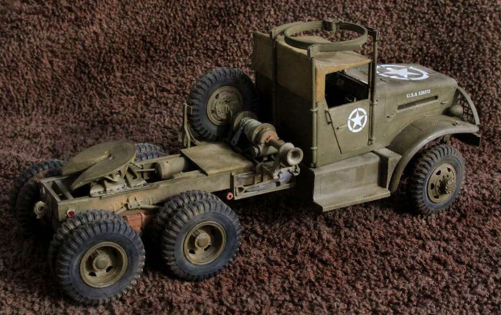

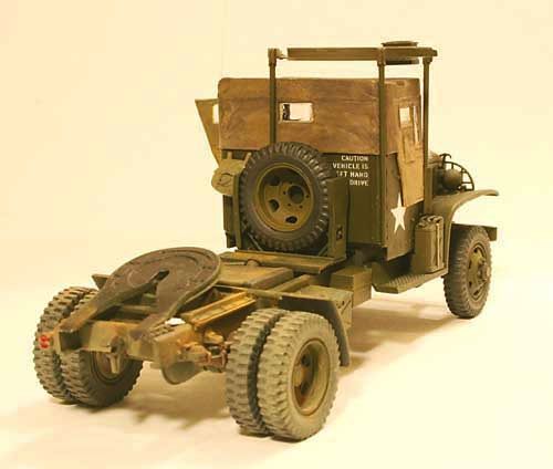

Some of my efforts at converting to fifth wheel semi-tractors:
White 666 conversion using fifth wheel from Custom Factory:
Chevy Semi-tractor using a very nice fifth wheel off a toy truck:
(Yes, I know. Did not learn till after the build that these were never manufactured as open cabs. Although I have seen a photo of one post war conversion/restoration that does utilize the open cab.)
With scratch built stake bed trailer (Italeri Deuce wheels and springs):
MAZ 8x8 semi-tractor (not a conversion but super detailed):

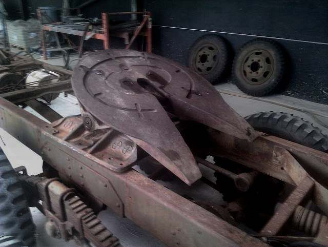

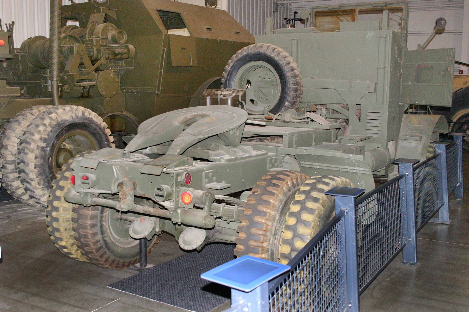

Tom I realize you already finished your beautiful 3D fifth wheel but perhaps these images might still be helpful in some small way.
Victory Museum - Auburn, Indiana
Posted: Tuesday, September 08, 2020 - 11:33 AM UTC
I saw a few of these on the web, and that modern measured drawing was indeed useful! I also found a few useful numbers in various TMs regarding the Dayton plate. One thing I noted was the original G7113s seem to have left the factory without any ramps on the frame rails, unlike that preserved example in your pics. It seems odd, as ramps would have been useful...
