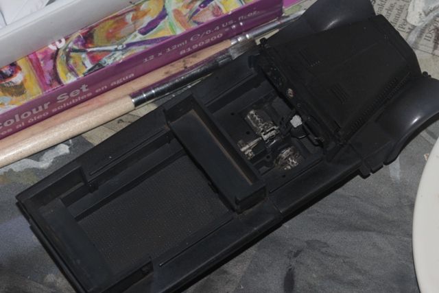

ok i did a black wash all over it, started to look pretty cool, then i tied the same for pin wash and wow its working (except for tide marks??) but then when it dried it didnt look like i had put any pin washes on it? was i not useing thick enough paint? too thinned out for pin wash? what other colours should i do the panel wash? the black wash gave it a dirty look and it aint to bad but still feels like im missing something? help? thank you.

Terry;
A pin wash is not just putting on spot washes, but rather adding tiny dots of oil paints and then blending them with thinner across an area. Search pin washes here and I am sure you will find some good tutorials. Cheers.

this is with the first black thinned out wash,,

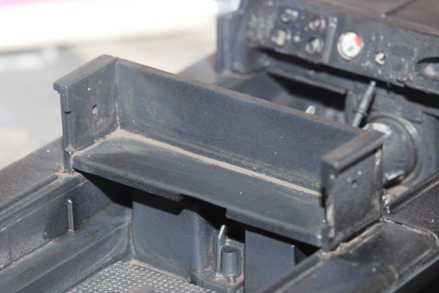

I am at the wash stage - so mixed my oils with white spirit (water soluble oils but found it mixes better with WS). Now I "think" I am making them 90:10 (thinner:paint) but when I apply to the model I end up with:
a horrible dusty mess (well to my eyes it is a horrible dusty mess)... Can you think where I am going wrong. Looking at it i am thinking
1) not thinning the paint enough
2) applying too much wash
3) a bit of both
if anyone has any photos of one of their kits before/after a wash showing how it ends up looking, or could offer some advice, it would be very much appreciated....

From your pictures, that' how a wash dries especially if you apply too much. It' puddles up in seams and corners, and generally dries unevenly on flat surfaces. Less will still tend to puddle up in corners, recesses, etc, but that's what you want. Using a Q tip dampened with the thinning agent you used, will help to clean up the areas you don't like.
Joel

cheers Joel... will get on that - dont mind it on the floor but thought on the bench(?) a little OTT
