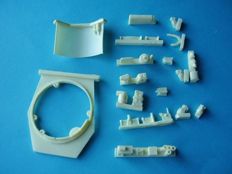

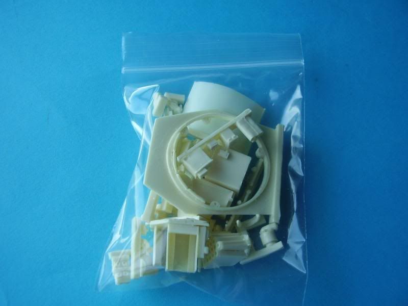

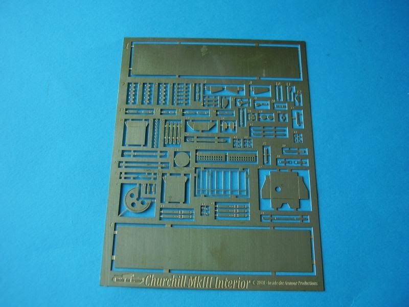

I was fortunate enough to get the new Inside The Armour interior conversion set. I'm workign on a review of the kit at the moment but thought I would give you a few tasters of what's to come.
Firstly the main kit will be the AFV Chuurchill Mk III kit, box yet to be opened!!

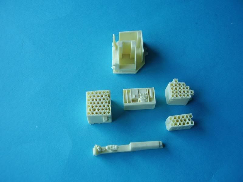

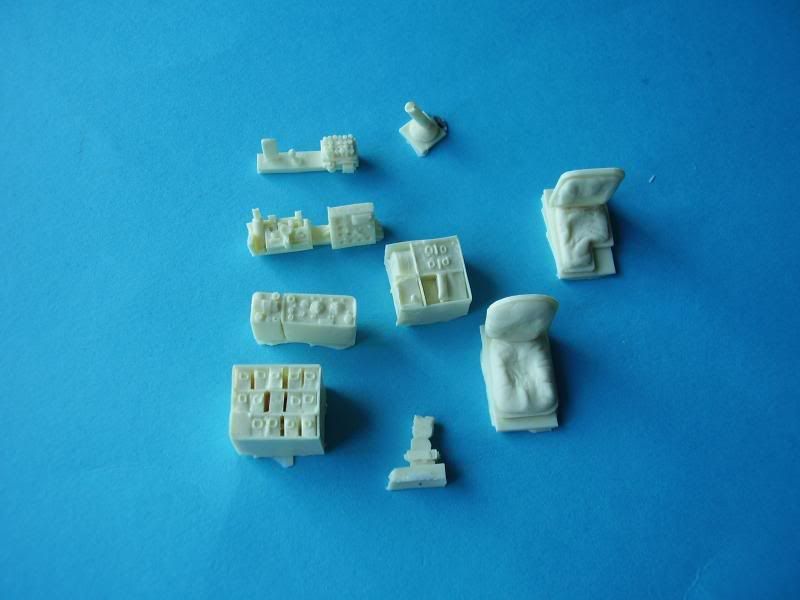

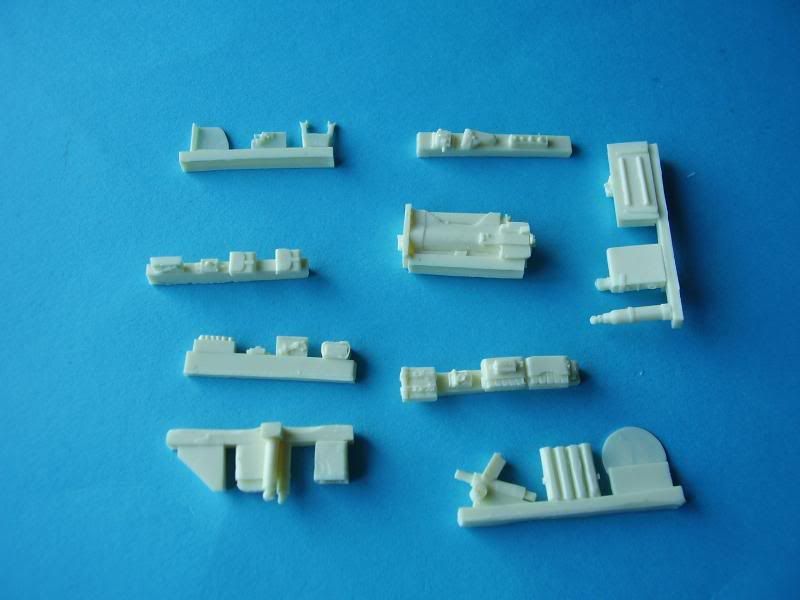

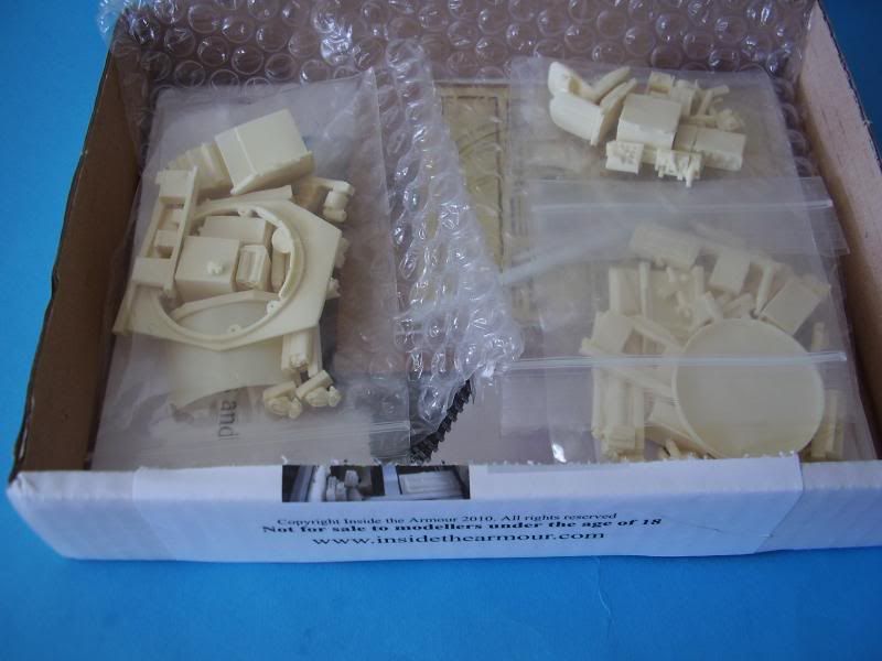

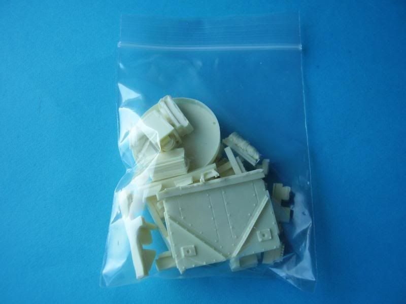

The Inside the Armour conversion set:

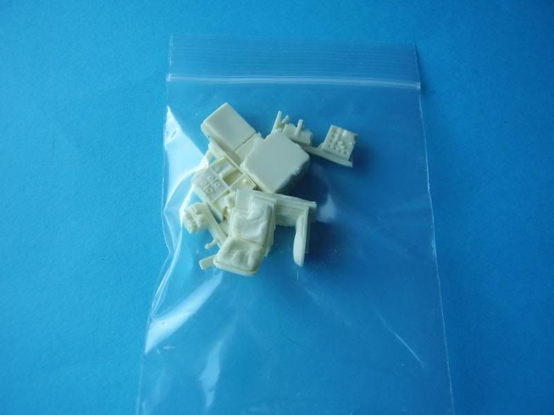

Some additonal Items from Resicast

Posted: Saturday, March 13, 2010 - 10:48 AM UTC
Hi Matan,
The parts look very well done, they will need a bit opf clean up and some study of the interior but should build up into a detailed re[presentation of the real thing. The bin boxes, 6pdr ammo racks all check out well with the stowagre diagrams, Nice no 19 radio, and underbin and the 6pdr breech parts look good.
Still checking the details but very impressive so far.

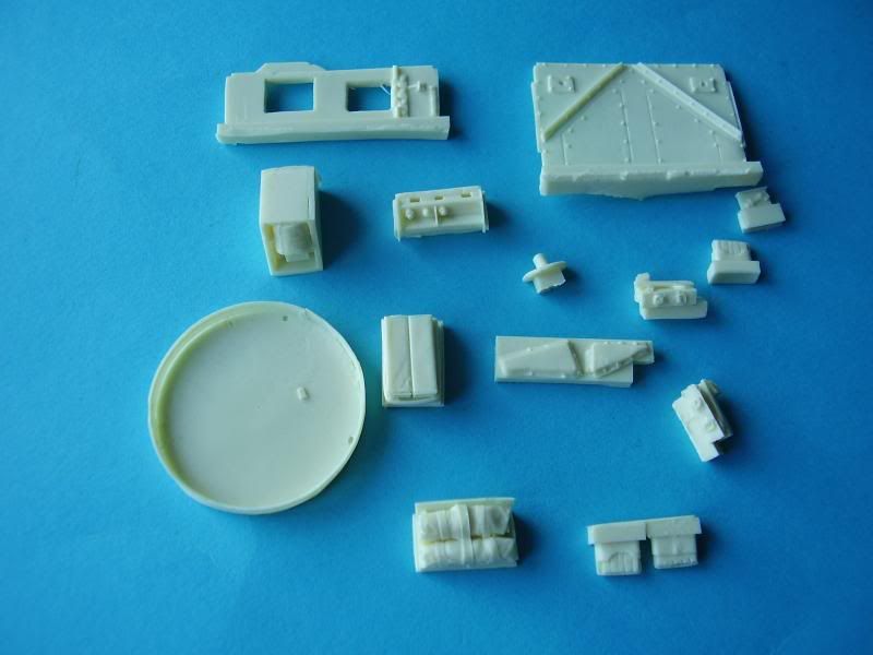

Hi Guys,
Well the review is now up on this one: Link here:
http://armorama.kitmaker.net/review/5014 Some pics of the parts:
Jim Rea did a review of the AFV Club Churchill Mk III kit here:
http://armorama.kitmaker.net/review/3918 and I did a brief review of the Resicast Churchill Engine here:
http://armorama.kitmaker.net/review/4012and their Churchill stowage Set No 1 here:
http://armorama.kitmaker.net/review/4067Now all that remains is to photograph the AFV kit and put things in the tub to soak and production can get underway.

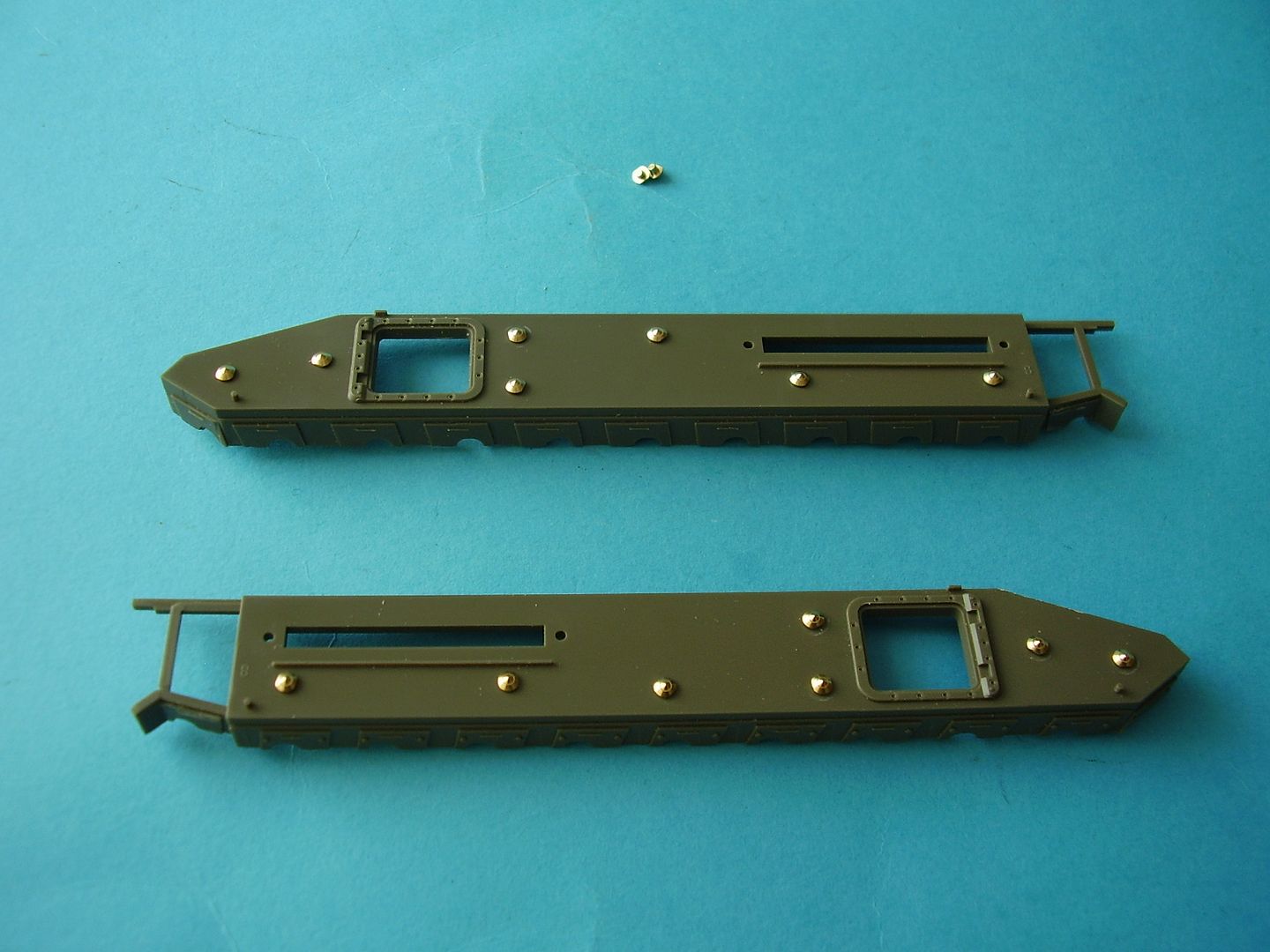

Righ back to some work.

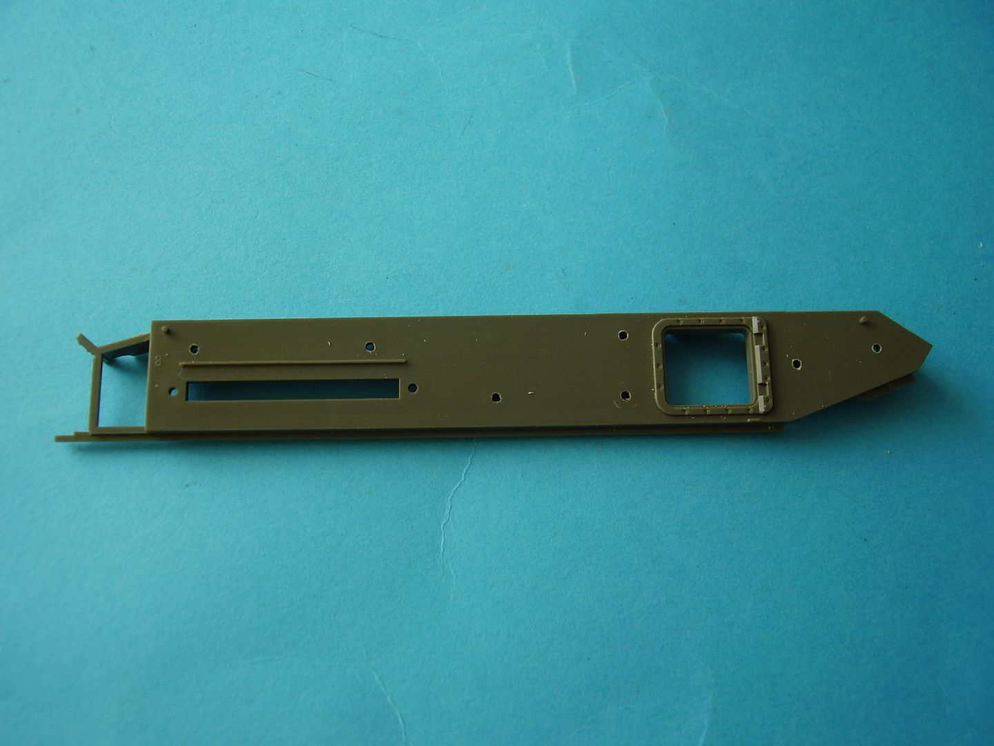

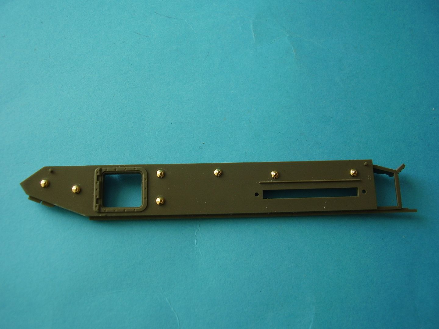

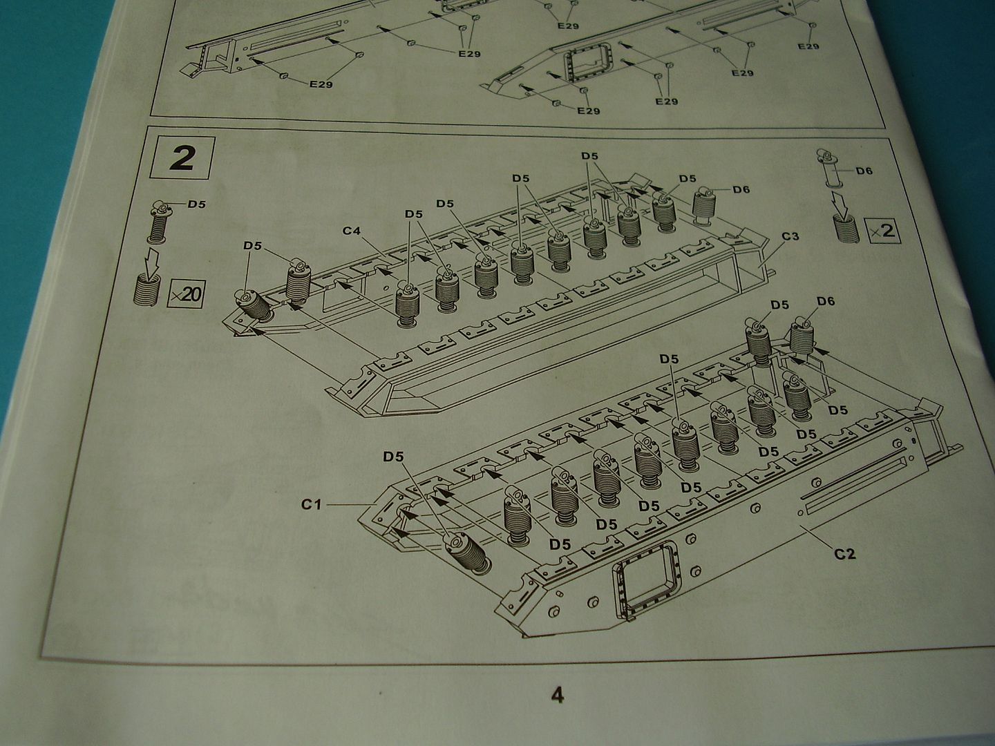

The first thing I did was to drill out the holes in the side panels. (Parts C2 and C 4). I used a 1.4mm drill bit and the AFV Club Riverts (which I think are a bit expensive), but save some work. I recommend you check Terry's review on PMMS as he has these clearly marked out so you don't drill the wrong holes.
http://perthmilitarymodelling.com/reviews/vehicles/afvclub/afv35153.html
These can then be super glue'd form the inside.
Next I started on cleaning up some of the suspension parts, lots more work to go yet.

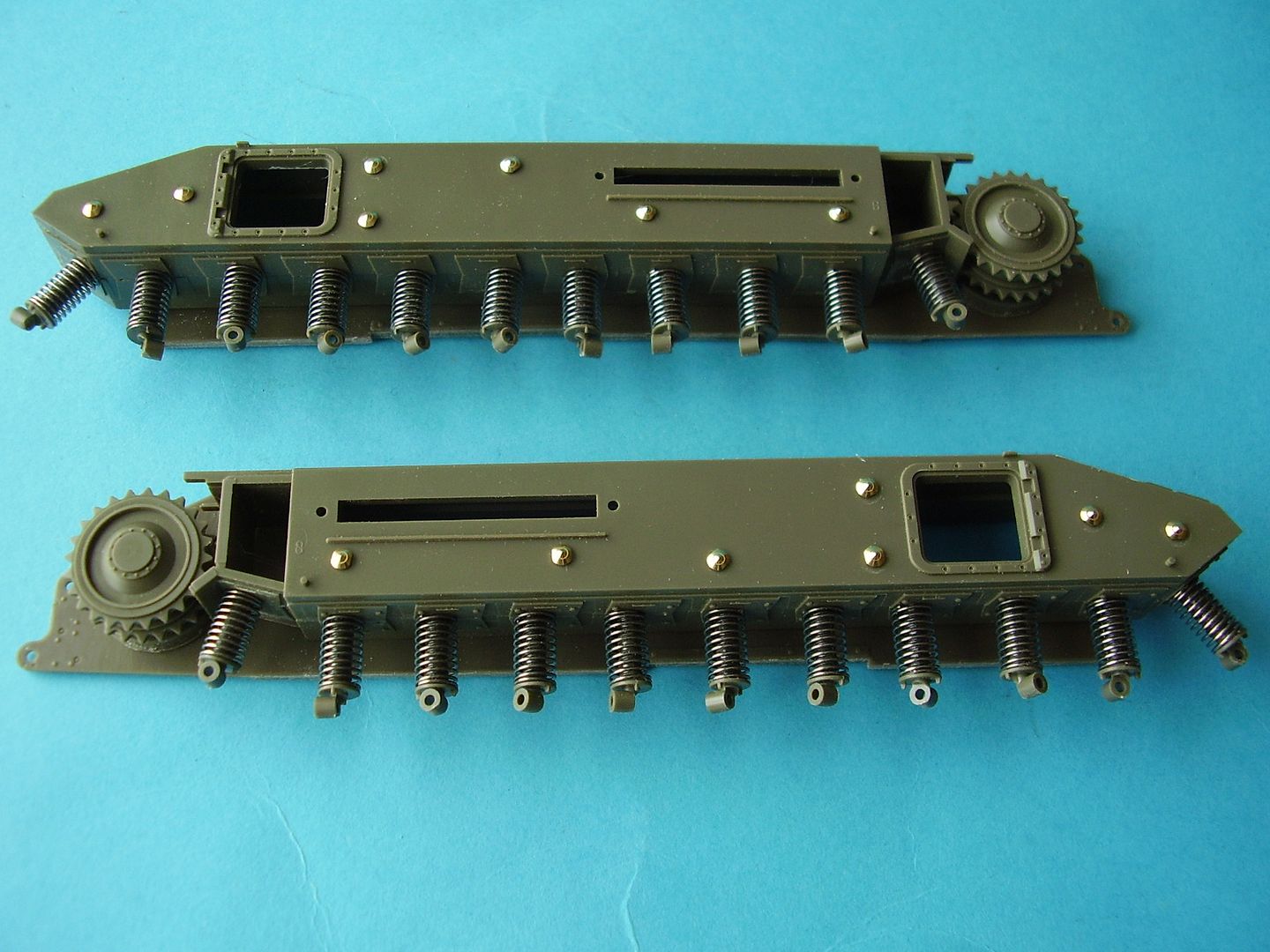

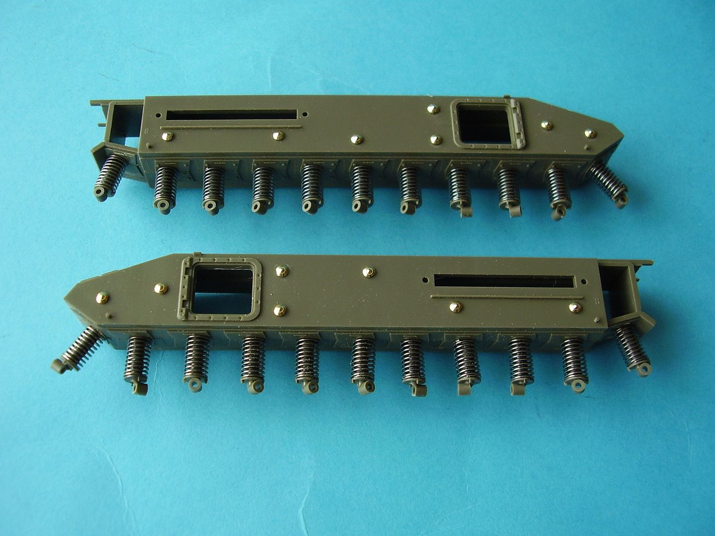

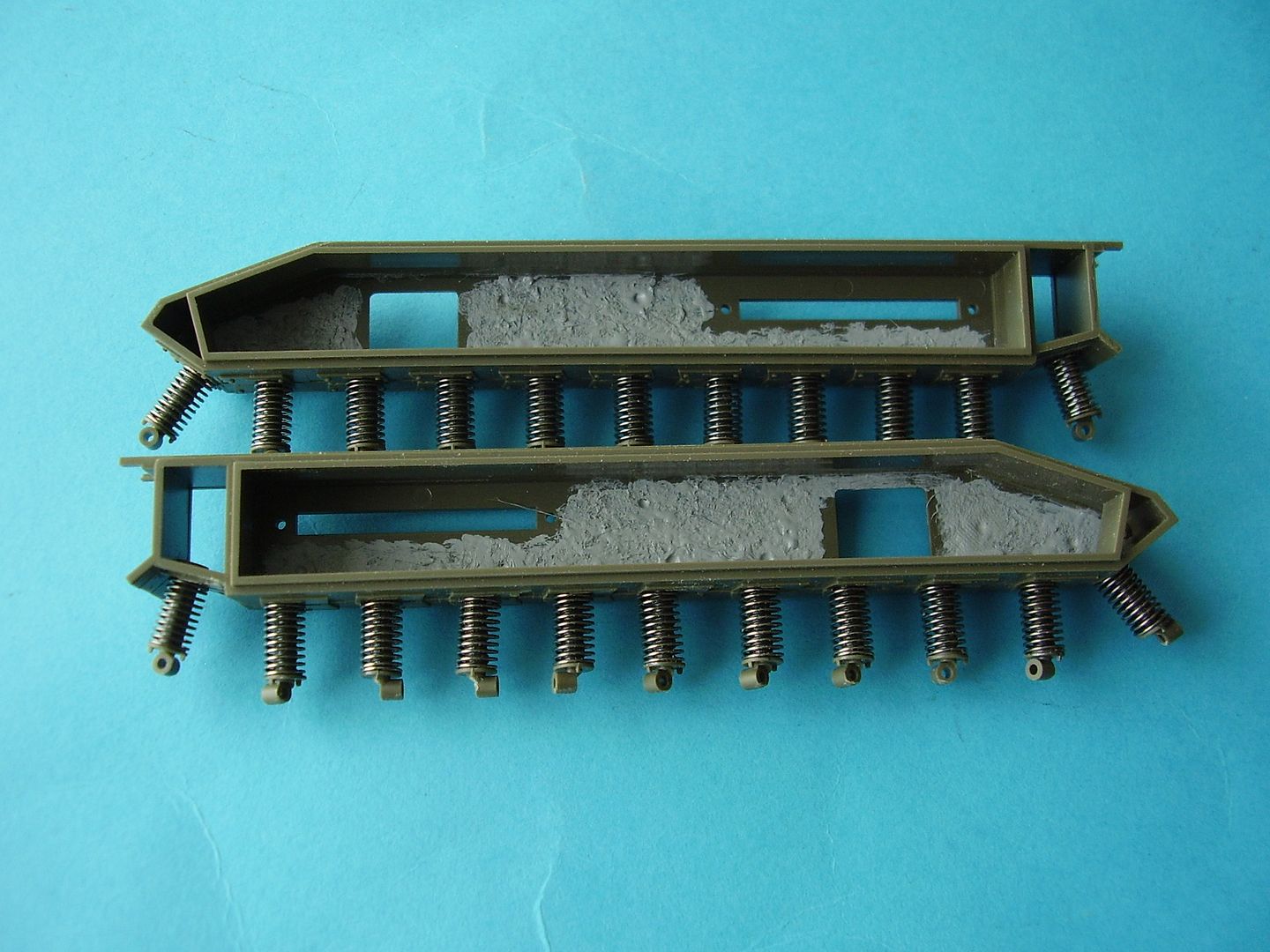

Ok next bit,

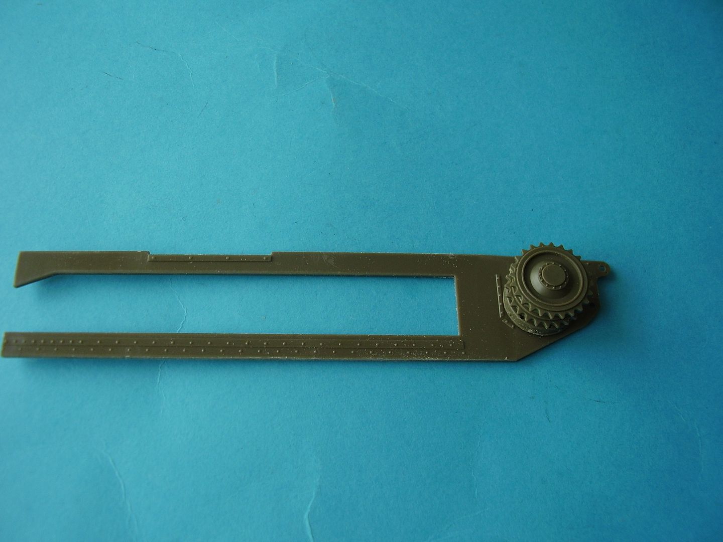

I painted parts D 5 and D 6 and then fitted the springs and mounted them on the frame. This was much more painless than I thought it might be. Whilst that parts C1/c2 and C3/C4 were drying I made the rear drive wheels. This caused a moments panic as parts T3 the poly caps are actually located on the end of the tracks and it took me a moment to realise this
Then I dry fitted the drive wheels into parts A1/A3. The next part of the suspension looks a little more complex but so far the kit has gone together really well.
I also used some Mr surface on the inside plates to cover the holes and pin marks but it needs a little more to fill in the holes.

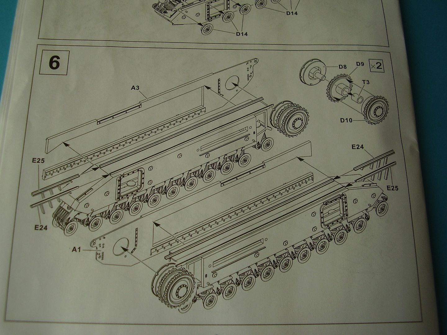

I shoudl really photograph the AFV instructions that might help
'Action this Day'
Winston Spencer Churchill
KitMaker: 14,499 posts
Armorama: 11,675 posts
Posted: Saturday, April 03, 2010 - 03:33 AM UTC

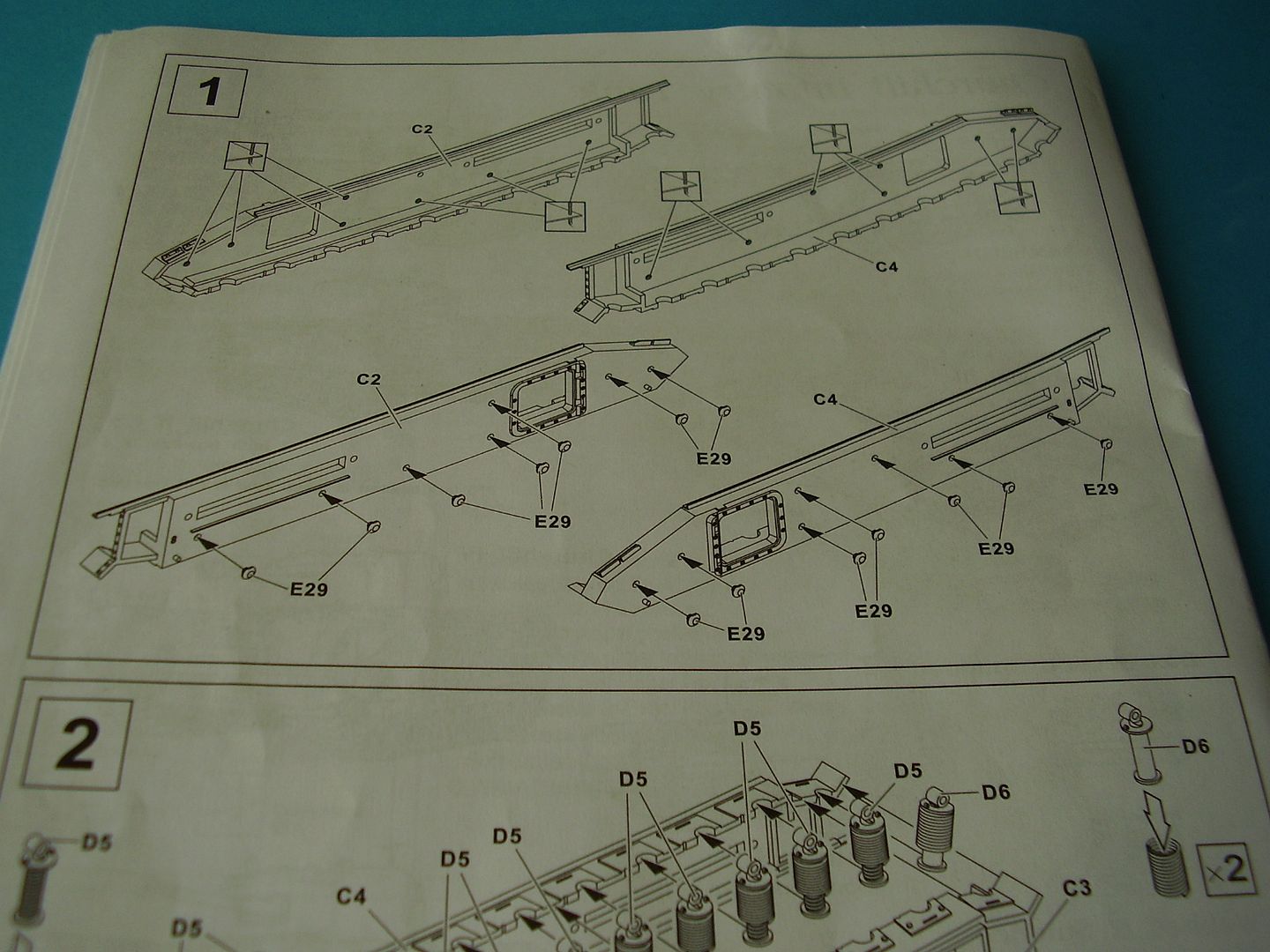

Unfortunately the edit button seems to disappear whenever you post another reply, this is a bit of a pain if you leave something out. Is this a new thing?
Anyway, part 1 and 2 of the instrcutions related to the posts above.

Posted: Saturday, April 03, 2010 - 05:41 AM UTC
Hi alan
Is the suspension in the AFV Club kit actually workable? It seems very complex just for some super detailing.
I assume though that it allows you to "pose" the tank over some interesting scenery pieces?
Posted: Saturday, April 03, 2010 - 06:39 AM UTC
Hi Jon,
Yes, you could position the suspension, although when I add the interior that will not be the case, although you could shorten the arms if you had a mind to and do it that way.
