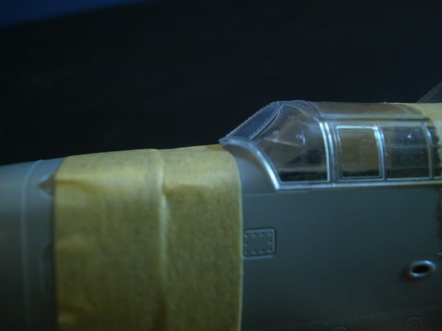

Very nice build and nice review Jean-Luc, since it doesn't overlook the numerous shape issues like so many others... You also mention the difficult fit of the clear parts, which many reviewers omit, including Brett Green, despite the poor fit at the front being visible on his finished model...:

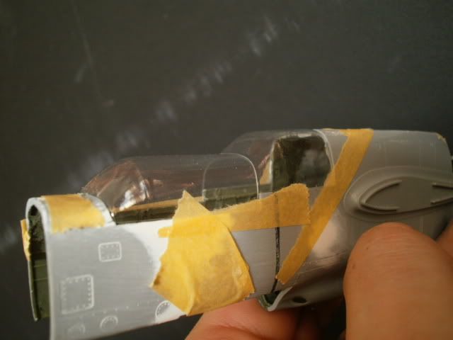

I agree that the model's basic research is undoubtedly copied directly from the Monogram kit, the only differences being incomprehensible additional errors, the cowling openings for instance, or here the rear canopy, Monogram being quite correct on the left...:

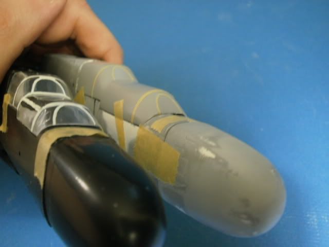

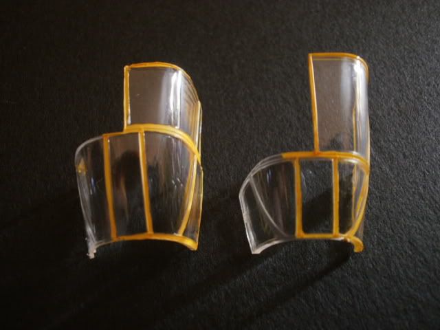

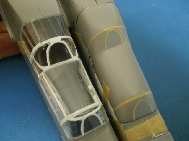

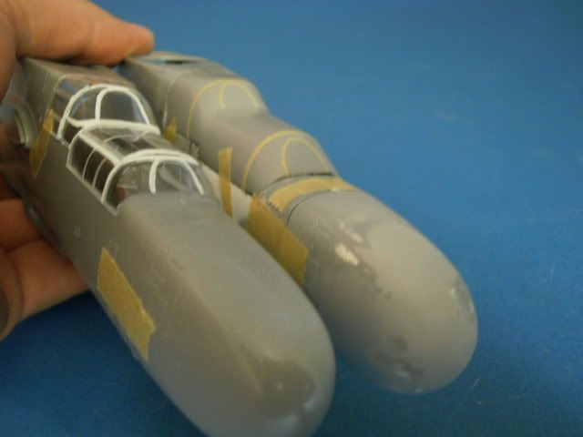

Just how badly off is the Monogram kit can be judged here from my canopy smash mould master put on a lenghtened GW fuselage: This is all based on dimensions I got directly from the MAAM restauration (the narrowness of the master is slightly exaggerated by the angle, and the need to undersize the master):
VS the Great Wall:
I will post later a more detailed article on the MAAM P-61 canopy dimensions, and what they imply about the availale 1/48th kits (mostly utter devastation and desolation, unless an entire resin front correction fuselage is offered: The whole front fuselage, nose gear bay, nose gear door and canopies were in real life much longer than in either of the kits!).

I will see what I can do with the spare clear plastic pieces I have: The master often has a lot of primer on it to smooth flaws out, and this makes it susceptible to surface damage from the heat of the softened plastic after a few copies: It is very little damage however, so I should be able find, or complete, one more useable copy...
