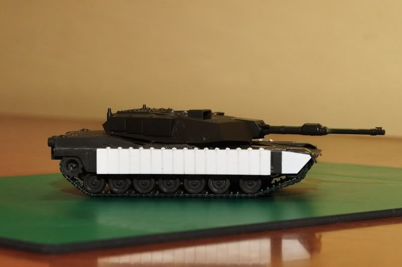

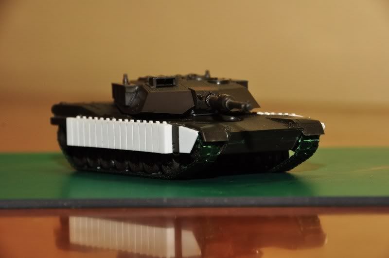

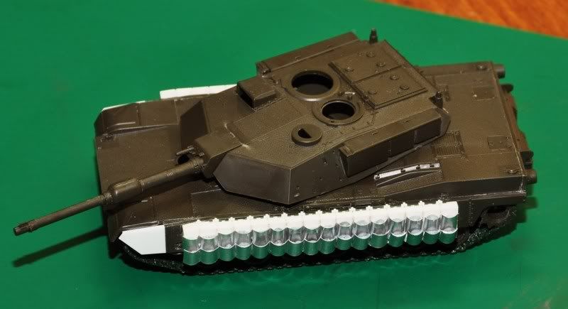

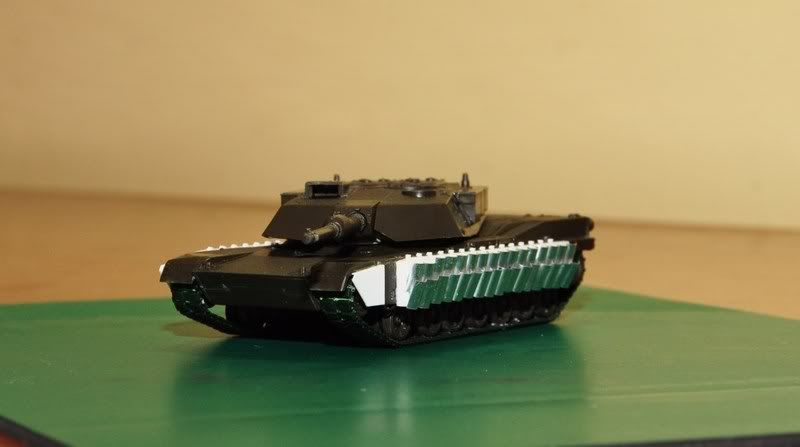

Just finished a long project and again I found my self hooked. I promised myself to have a break but here I go again. Nothing much to say about the kit itself and a lot of you guys know the ups and down. This again is a big task (TUSK) for me. Converting this old kit to M1A2 with a little twist. So sit back and enjoy the ride.
The kit......
The conversion........

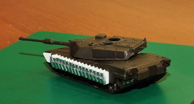

Getting the distance of the first road wheel to the rest of the wheels is crucial as the kit's stock looks strange. I have to cut it out and set the distance right. Next is the tracks, no aftermarket parts so I dig my spares and got me an updated big foot track.

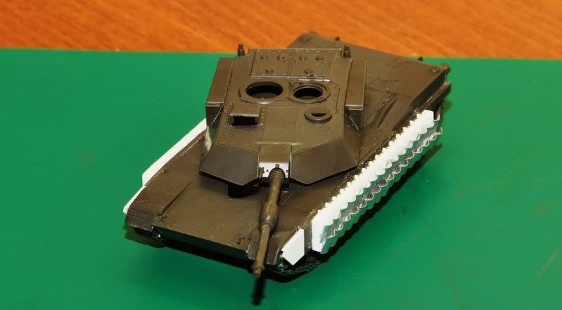

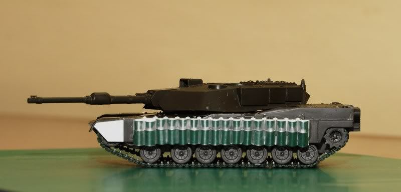

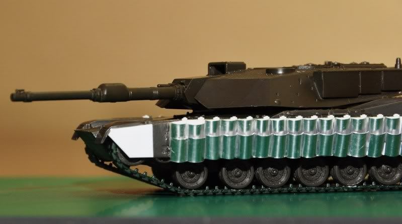

Here you can see the changes made to the front side skirt. I will fill a couple of areas in the fender as the current M1 don't have this stiffening "X" on it.
Now the fun part......I have added a "mock up" ARAT 2 tiles and this will be the version I'm going to make. This is temporarily tacked. This is going to be a full conversion and ofcourse in 1/72nd. No after market parts to be added.
This is going to be a long and slow build, stay tune fellas.
