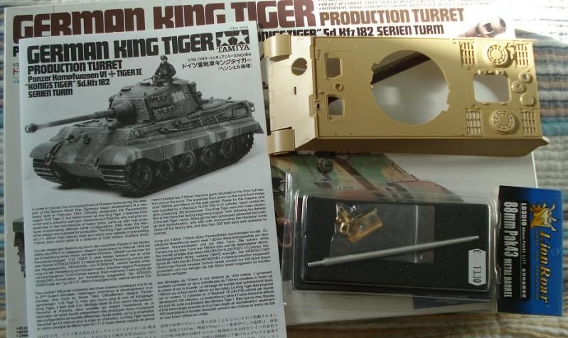

Lots of work today...
This is the kit and I added a metal gunbarrel from Lionroar.

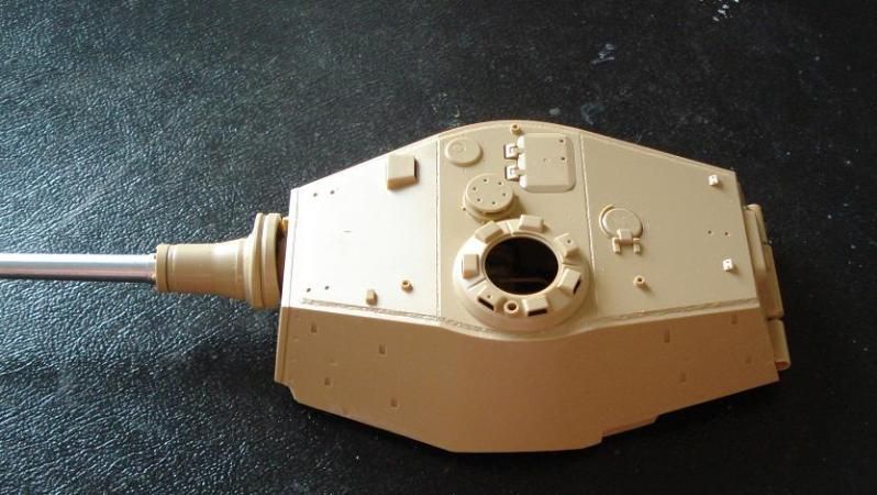

Started with the turret, for a change

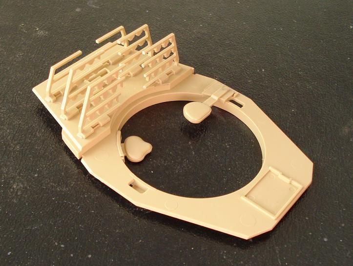

As you can see the interior is basic.

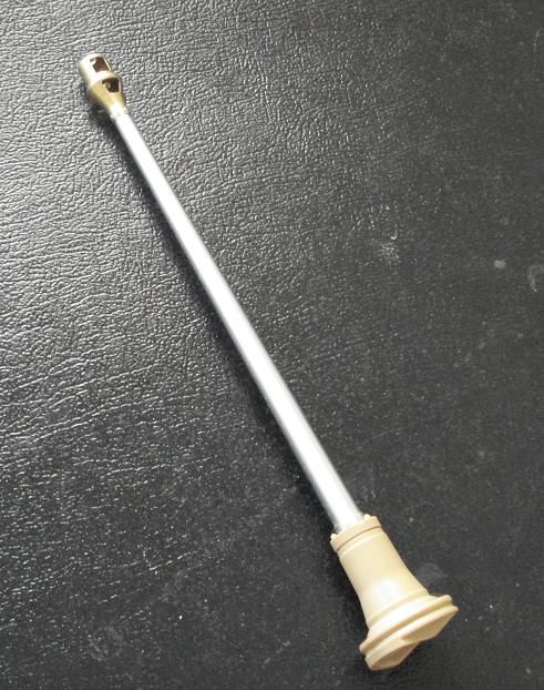

Here's the gun.

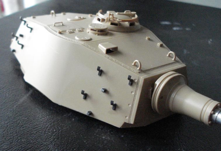

So no interior for this one. I started working on the turret details, hatches...
Only thing missing are the spare tracks holders & MG42, and of course the spare tracks.

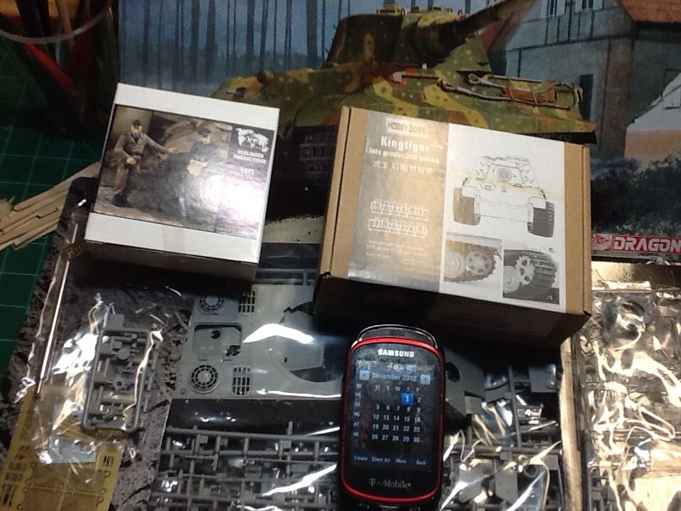

It wasn't my fault ,honest,it wasn't.Although I will admit that this photo thing and I really don't seem to get along very well
As you can see by the date and time I was ready to go bright and early
Have a roadwheel
The rest of the parts
Some nice PE with some REALLY small parts
This is my first Armor Pro kit and I must say,I am impressed with the detail.There is only one problem.and that is the color of the tracks.Fleshy,tannish colored tracks,really?I'm not looking forward to painting these and having any of that color coming through

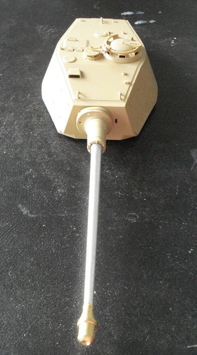

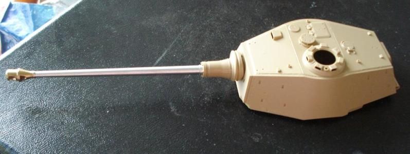

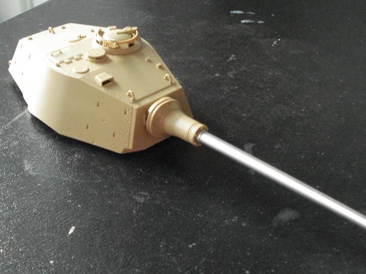

Today I noticed the LionRoar metal gun was quite different from the kit's weapon...
Since it was glued with CA.. oh well, that's an excuse to build another KT after this one
Today's progress:
More details on the turret
I'll work on the other side tomorrow.

John there are two types of barrel for the KT a single piece barrel which I believe was used on the Henschell turret or production vehicle, the one and two piece barrel was used on the 50 Porsche turreted KTs. Is that what you mean by different?
Nito74
Joined: March 04, 2008
KitMaker: 5,386 posts
Armorama: 4,727 posts
Posted: Friday, November 02, 2012 - 07:38 AM UTC
That's it then.
This one is a single piece. .. and fits perfect !

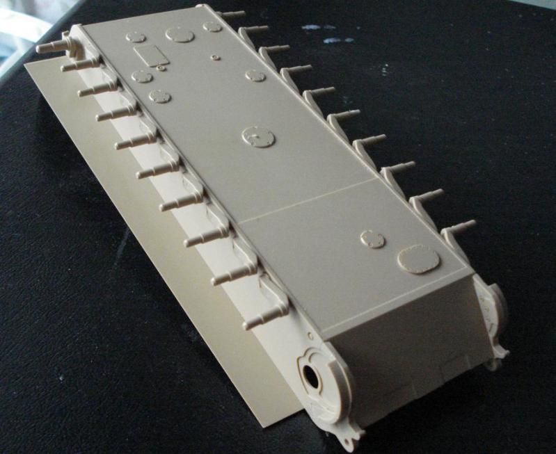

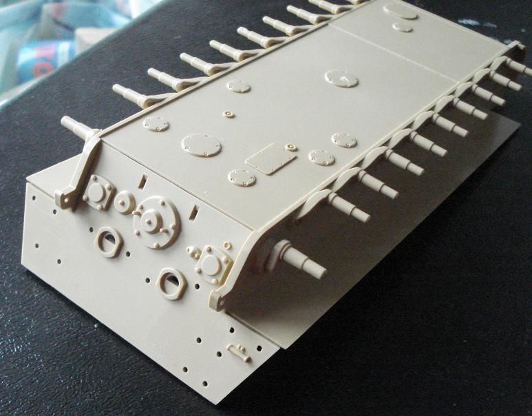

I have continued to remove detail from the hull and turret in order to add the Cavalier zimmerit panels which has the removed details attached to the sheets in resin. No real hassles were encountered with the exception of the front of the turret where I had to add heat to the pieces in order to get them to conform to the face as it curves in two directions which is why I still have a panel to add in the pictures below. I have also included a picture of the razor saw I used to remove the detail in case anyone was unsure what I was referring too.
I also started work on the hull and as can be seen despite being one of DMLs newer models it is not without issues such as push out marks that need to be filled. You will note that the drive cogs are from the set of Friul tracks I bought for this model which will now be replaced with the kit supplied parts as the Friul tracks I bought while used on this vehicle type are not the correct type for the vehicle the model will depict. While I have not included the a picture of the idler wheel DML has the inner and outer wheel of the idler numbered incorrectly as A9 should read A11 and A11 should read A9.
