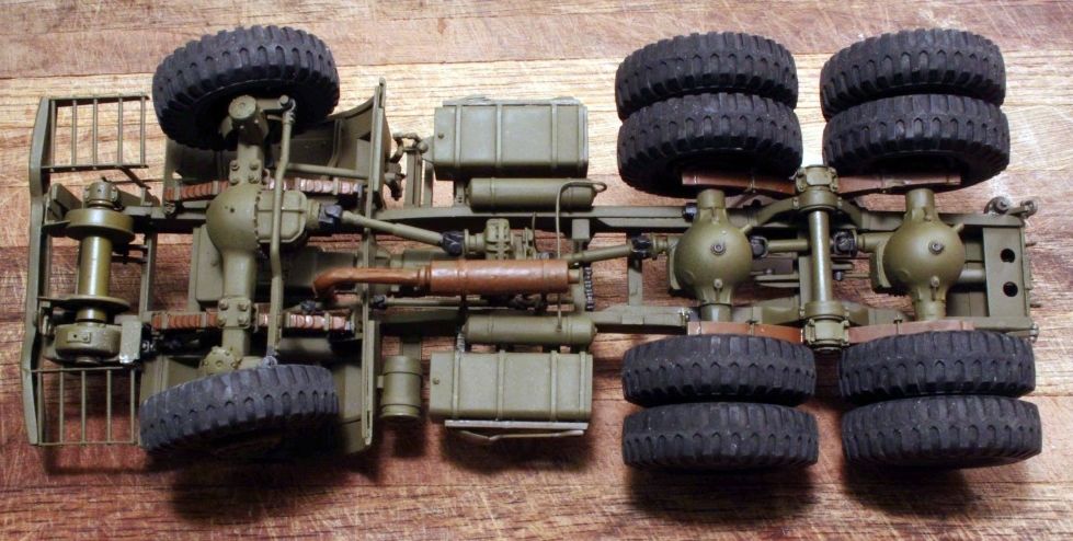

THE CHASSIS
As I have said earlier, based on my experience with the Tamiya Dragon Wagon I started with a totally straight frame, big mistake, as seen here:
I also started with nearly straight leaf springs (WRONG) mounted to the top of the rear axles, common practice for almost all truck makers, but not Mack!
Again as said previously, this resulted in a chassis that rode WAY too tall in the saddle.
If you will check the frame side drawing posted earlier you will see that the Mack employed an off-set frame where the formed frame members make a vertical jog up and over the front axle. In this photo I have now added that vertical jog to the frame and STILL the vehicle is riding too high.

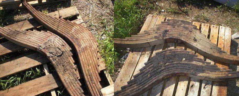

Some used Mack Camelback rear springs that I found tonight after a brief search on the web, up for sale.

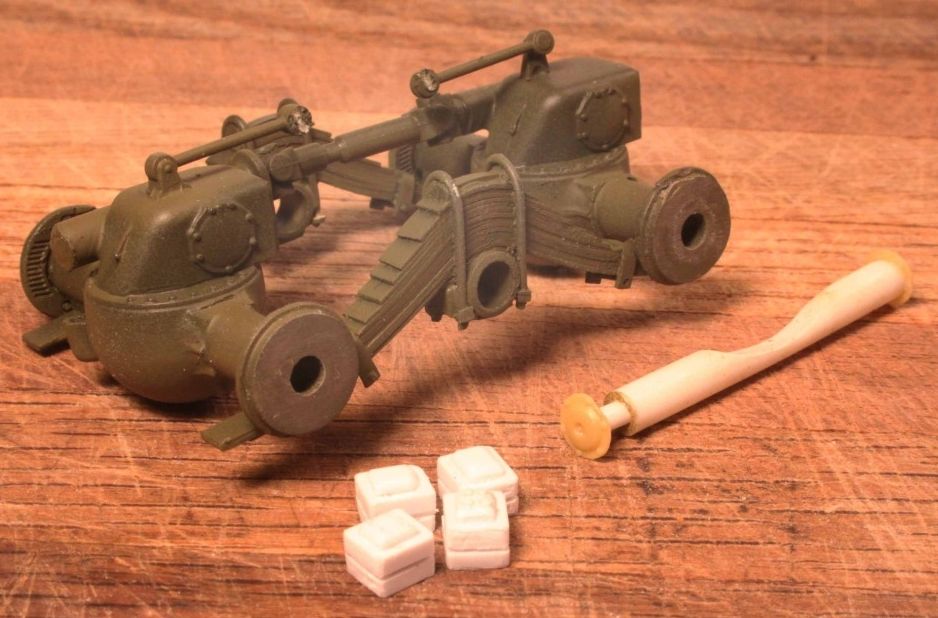

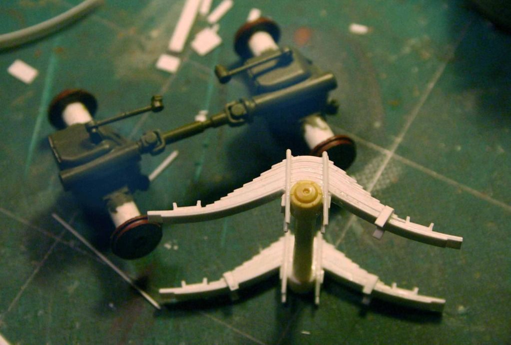

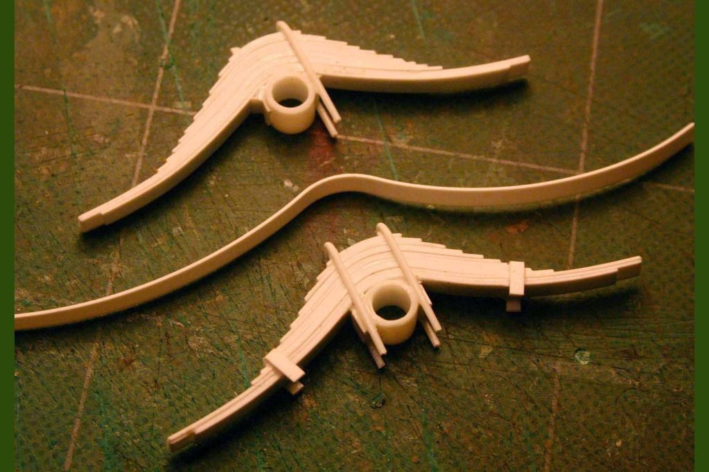

The revised rear leaf springs under construction:
Just bend em, glue em, strap em and ya got em!
F.Y.I. - Yes, that is a Panzer IV road wheel bearing cover plate being used as the bearing cover plate on the Mack rear axle assembly. (Problem is on the real truck this cover plate has the script letters "Mack" stamped into it. Could not figure a way to simulate that!)
The square white blocks at the bottom of the photograph are the not yet mounted steel and rubber axle mounting blocks used to cushion and give flexibility to the spring and axle assembly. (8 individual pieces per block.)

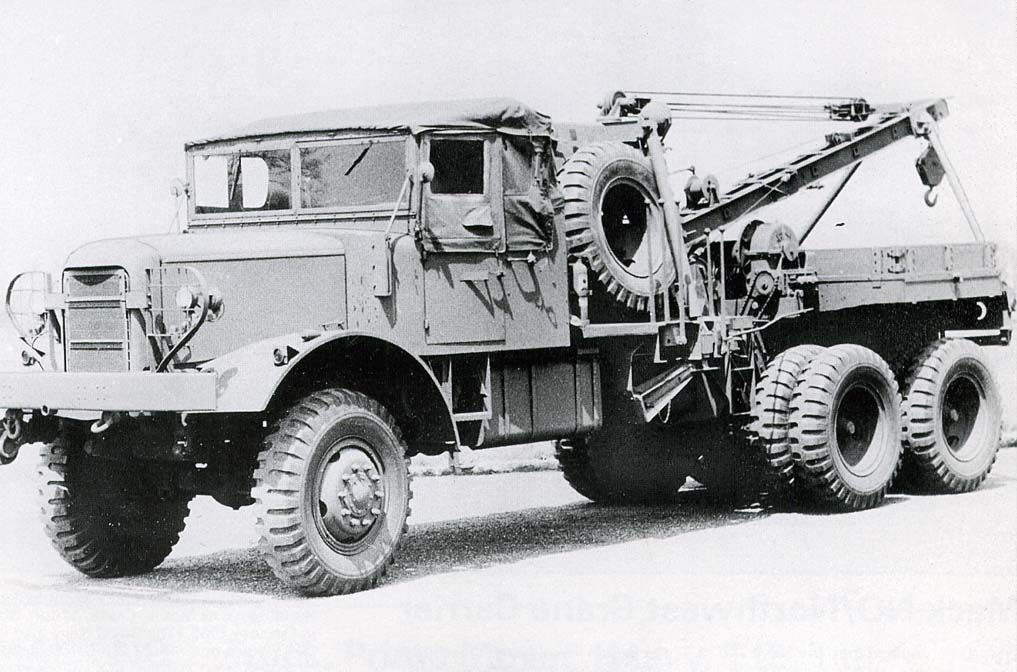

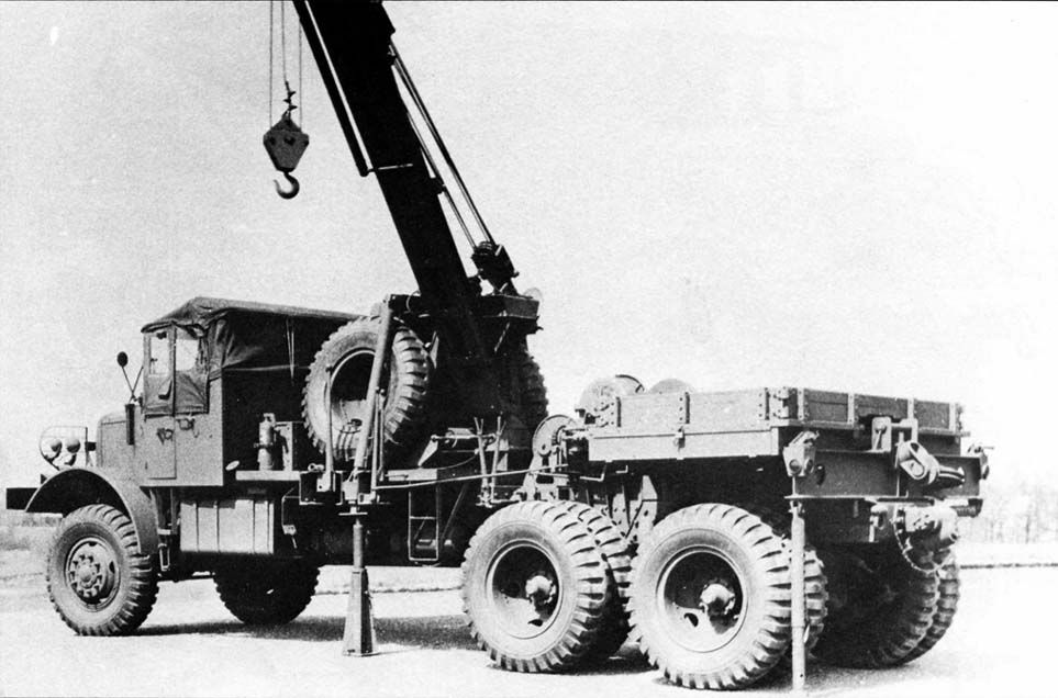

Let's break for something a little bit different:
Mack built two long wheelbase NO prototypes for the military with Gar-Wood cranes installed. One for the Army and one for the Air Corps. Unfortunately neither were accepted into full scale production.
Above is shown the Army version with double Gar-Wood winches and a small load box.
The third photo shows the Air Corps version with single winch and fifth wheel for towing an aircraft recovery trailer.
The Gar-Wood crane is, more or less, easy enough to scratch build but I just don't think I have the heart (or the years left) to build another Mack NO.

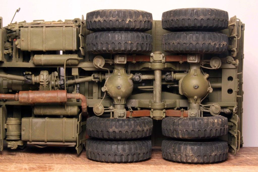

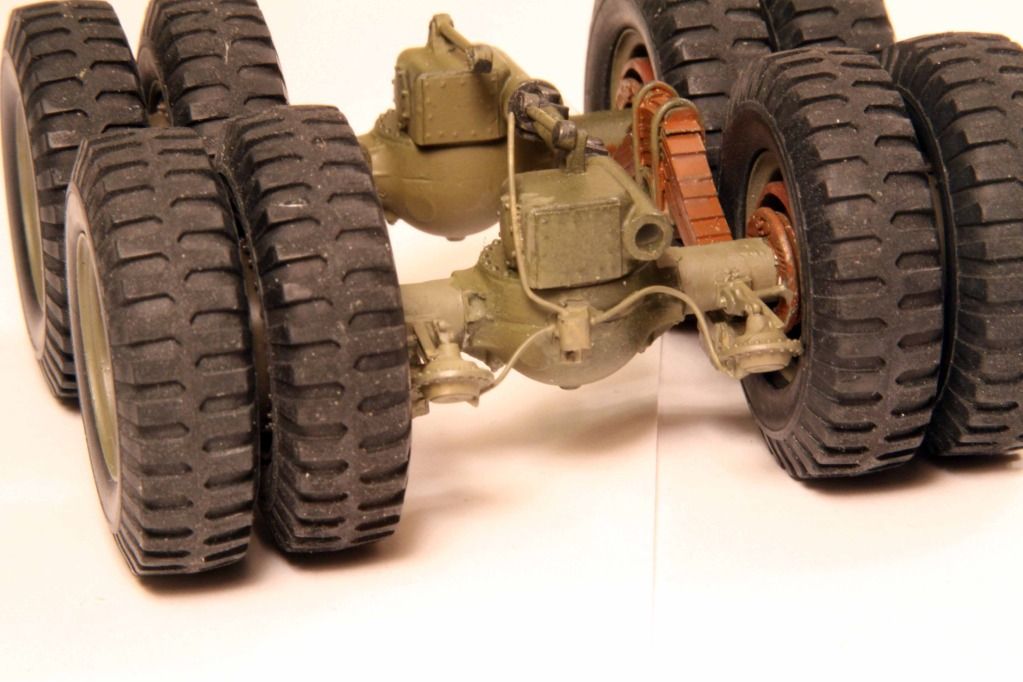

The nearly complete rear bogie. The round tube with the end caps is the bogie support tube that goes thru the axle bearings and thru the axle mounting tower pillow blocks (bearings)and is capped offf on each end with a bearing cover plate with lub fittings. (I could not find bearing cover plates that said "Mack" on them so I had to settle for Panzer IV road wheel bearing cover plates which serve exactly the same purpose on the Panzer as they do on the Mack.
Posted: Friday, May 24, 2013 - 06:43 AM UTC

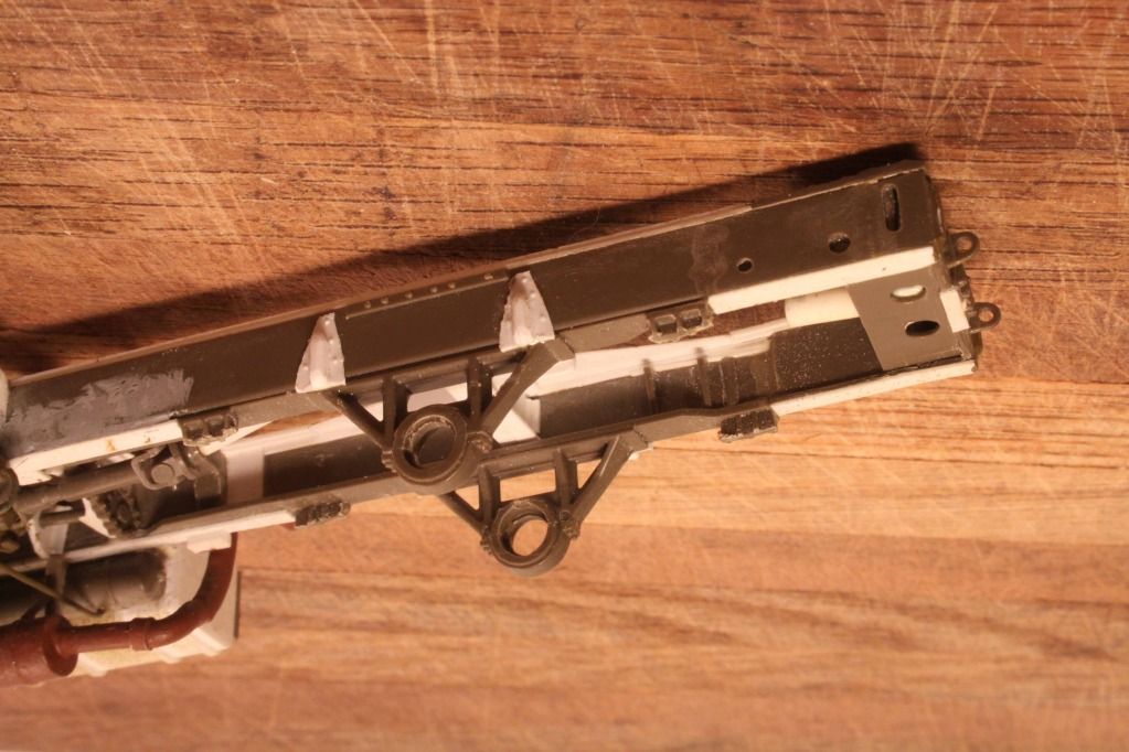

The nearly completed chassis and driveline:

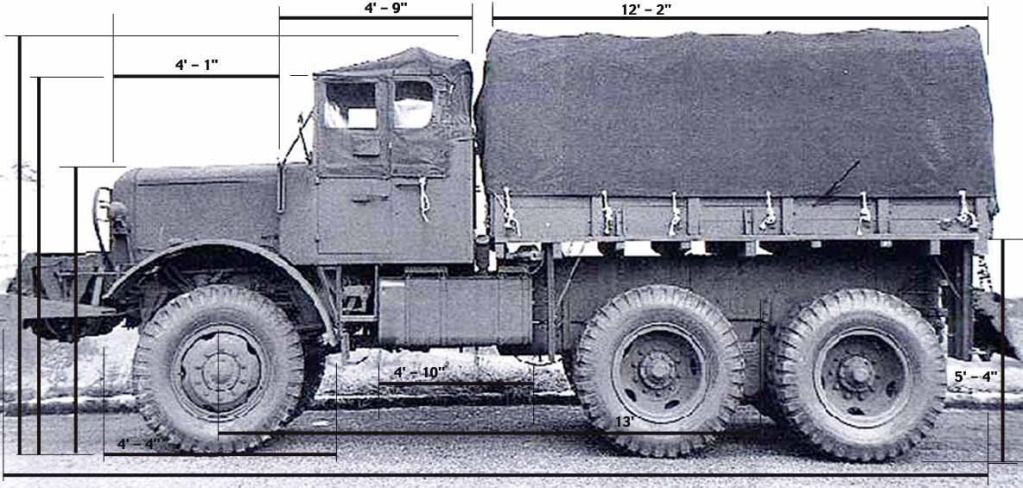

I scaled everything on my Mack NO off this photo. The only known measurement was the 24" wheel drums. Using a set of dividers on an 11x14 print I determined everything else. Remember the 24" is not the outside edge of the wheel rim in the photo but the next line in which represents the actual size of the drum.
Posted: Tuesday, May 28, 2013 - 05:22 AM UTC
As I said, take your 24" scaling measurement from the inside drum of the wheel and not the rim of the wheel.

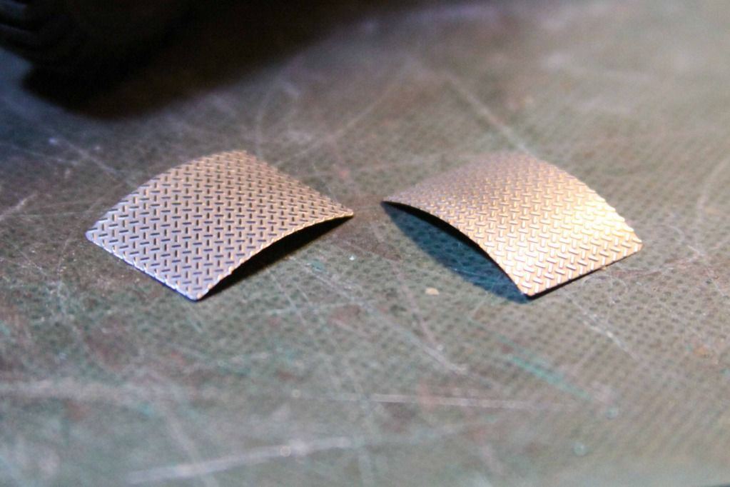

TREAD PLATE FOR THE FRONT FENDERS:
A fairly easy conversion using some of the tread plate that comes with the Dragon Wagon kit. I cut the plate down to size and very carefully worked it around a broom handle sized dowel to work up the curve. If you want to include even greater detail add 8 bolt heads, four along each side.

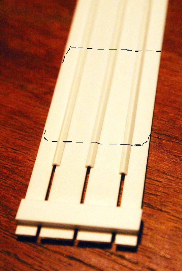

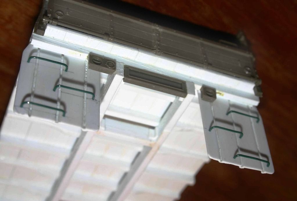

TECHNIQUE FOR MAKING EMBOSSED US MUDFLAPS:
After a failed attempt to actually use brass sheet to make these embossed mudflaps I came across a technique that in some ways is very similar to the method for making the ladder racks that we discussed earlier.
Posted: Friday, June 28, 2013 - 02:09 AM UTC
Again I start with appropriately spaced runners cut longer than the mupflap required. In this case I used runners long enought to give me all four needed mudflaps.
To this I glued on two horizontal spacer bars, one top and one bottom to keep the runners at the correct side to side spacing.
Finally I added small Evergreen angles to form the embossings and let all this dry completely.
The dashed lines represent the cuts I then made to give the mudflaps their final form.
Posted: Friday, June 28, 2013 - 02:56 AM UTC
The finished product..
