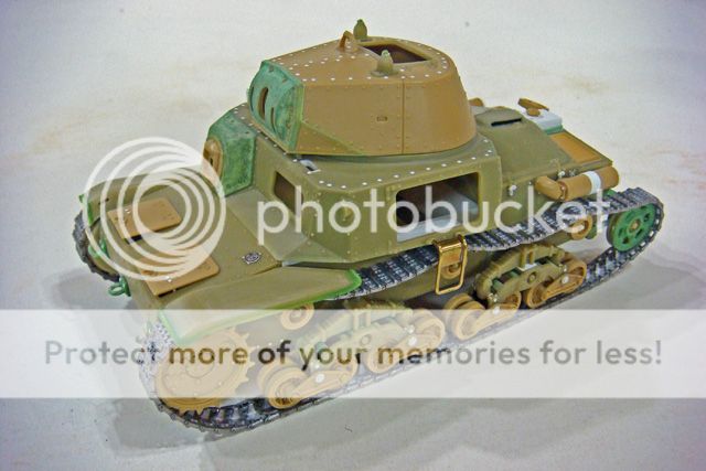

This is the Italian M13/40 from an early production series. The M13/40, like many tanks, received numerous modifications over its production run, from prototypes to a final series that was indistinguishable (externally) from the initial M14/41, thus creating several distinctive, but unofficial "production series". My model is representative of the first regular production series after the short-run initial series which followed the prototypes.

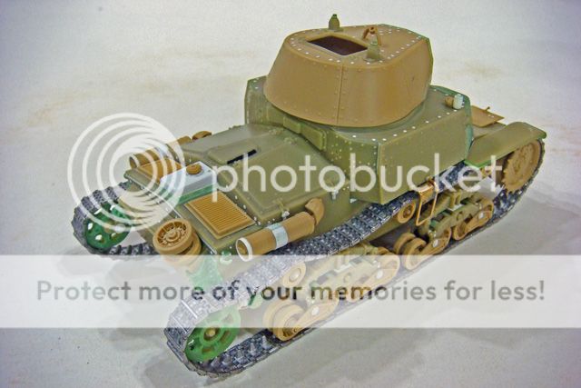

The main characteristics are the longitudinal cooling grates, the radiator box without ventilation, the early simple muffler mounts, the absence of the turret roof main gun "super depression" hump, short fenders, single spare road wheel, and repositioned jack.

In the photos, the yellow-green colored plastic parts are Italeri. The tannish colored parts are Tamiya. The white parts are, of course, styrene, and the dark green parts have thinned putty stippled on them to create a cast texture. The brass side steps have been scratched-up from K&S rod and sheet.

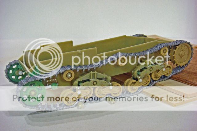

As you see, I combined the kit parts to articulate the suspension, and the link-to-link tracks are from Spade Ace (after I found that the Fruils that I had bought, cleaned-up, and assembled would not lay in a straight line!).
The tracks are assembled here about 1-2 links too long, and will be adjusted for fit after they've been finished. But, I've learned it's better to have to tracks a little too long than have to finish to match and add a link or two later.
The model as shown here is assembled dry-fit for a final test before I start the interior painting and close-up the superstructure and turret halves. You'll note things like the fenders are just hanging loose and still require some additional details (thinning and mounting flanges on the rear and front ends).
