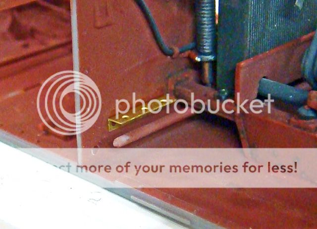

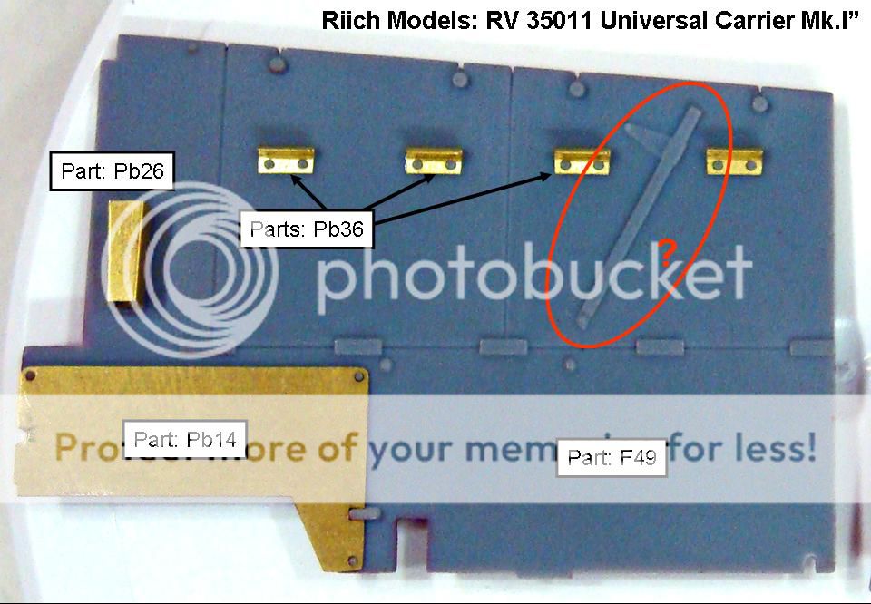

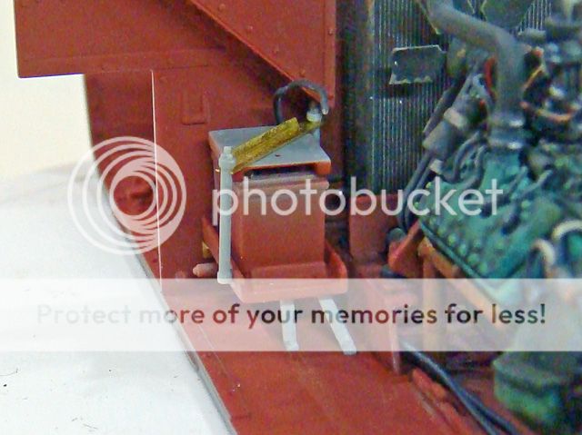

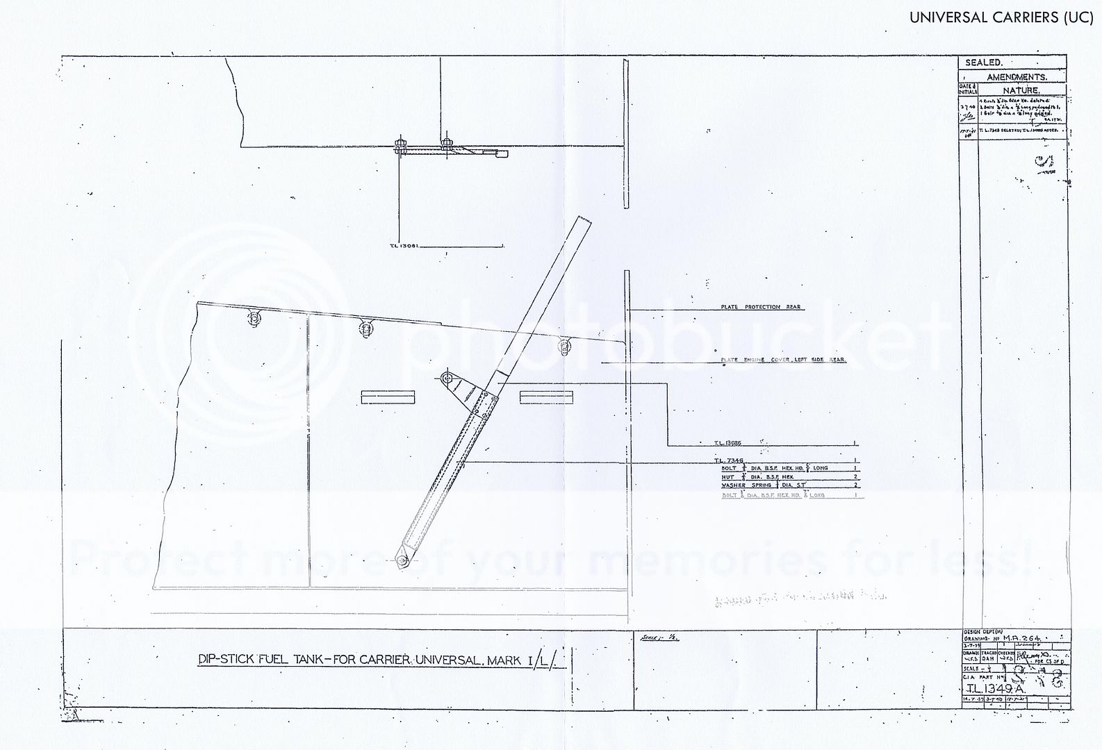

As I was looking over the kit parts, I noticed a detail on the left / port side of the engine compartment wall.
The detail is cast fairly shallow, and I couldn't quite figure out what it was. At first glance, it looks like a lever of some sort. But since it's on a removable engine maintenance cover, it doesn't make sense that it's some sort of control.
I then suspected it was a tool of some sort, maybe part of the vehicle's maintenance kit (give it's location). At any rate, on another forum, I posted this picture of the detail and asked if any one knew what it was and could they provide a photo of the prototype part.
Several folks responded, and the detail was identified as a dip stick for the fuel tanks.
Ron Volstad contacted me off-line and sent me this copy of the factory drawings of the parts.
Armed with this information, I set about improving the kit details. I used strips of .005 styrene and small bit of left over PE fret and constructed my own fuel tank dip stick and stowage bracket.
Because the .005 styrene is so thin, I actually used CA glue to put the new bracket together (so the thin styrene wouldn't melt). The new detail only took a little while to make, and it has much more depth and dimension along with a nice shadow line.
I think the extra work was worth it since by leaving the engine compartment open, I'm inviting folks to give this are a close inspection. Also, by doing a little extra research and finding out what the detail actually was, I now know how to paint and finish it.

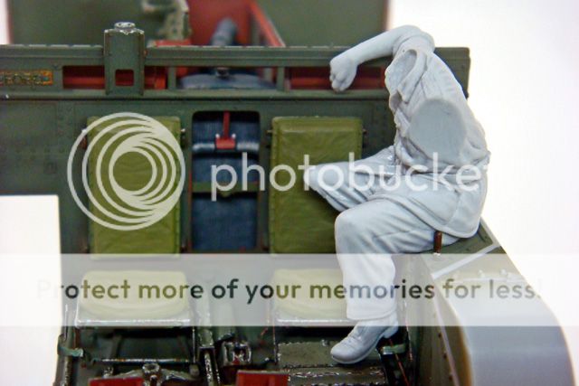

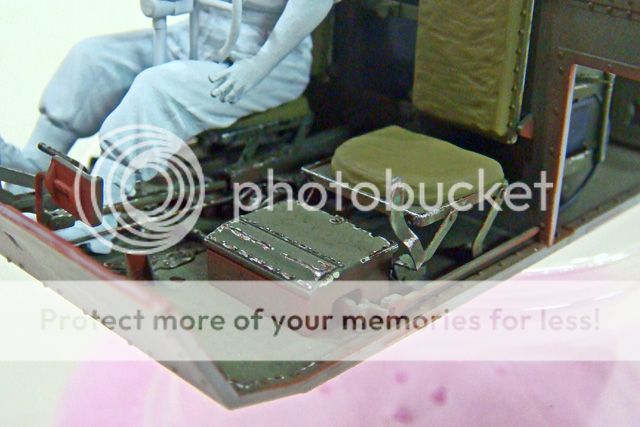

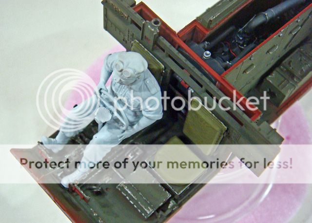

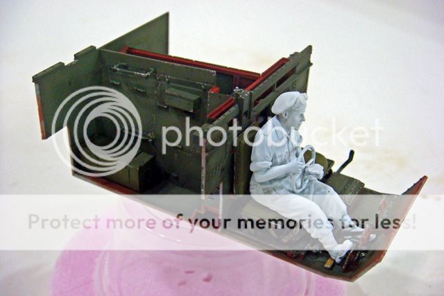

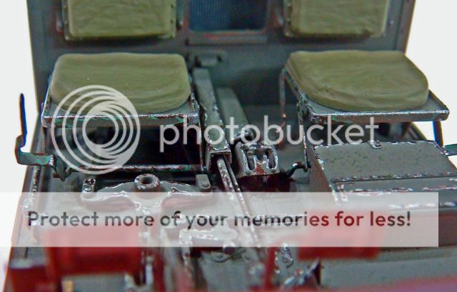

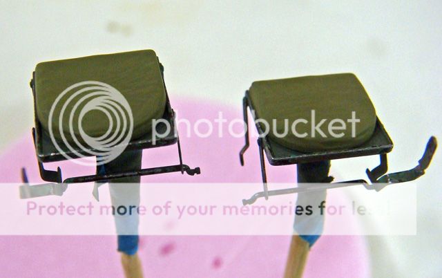

OK today's progress was mostly interior detail painting and some assembly.
The detail painting has been generally wear and tear type stuff - scuffing and chipping. I have installed the batteries and the fuel tanks in their permanent locations.
I still have some detail painting like the upholstery tacks on the seat back cushions (also for the radio operator - not shown here), but the next major step will be washes - pin washes and general washes - along with some rain and fuel / oil streaks. This will be followed by a dust glaze and then finally a coat of Testor's Dull Coat.
This is basically the same process that I used with the engine and engine compartment. Right now, the scuffing and chipping looks very stark and "contrasty," but the next weathering steps will tone it down some and and create consistency.
The last four extreme close-ups of the front seats are for anyone trying to figure out how they are assembled. I believe that I have mine correct, but that's not due to any help from the kit instructions which are very deficient in this area. In particular, note how the inner end of the front cross bar on each seat rests on the outside "ears" on the shifter cover. On the driver's seat, this bar has to be slid under the outside edge of the linkage tunnel, too. It's all very fiddly, but can be done.
I don't know how you're supposed to build these if the lower hull sides are in place. It's hard enough to get the floor attachments right when you can see them from the sides, but if the lower walls are in place, the seat cushions and walls block your vision.
I'll also start work on the gunner and radio operator now that I have enough of the vehicle assembled to test their fit and poses.

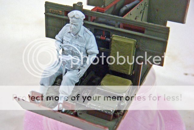

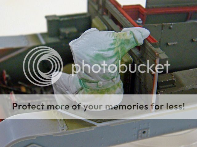

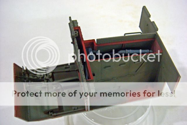

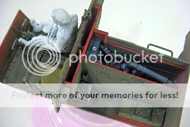

So, today, a break from painting. I installed the brake rod linkages that run through both sides of the rear compartment. These rods are absent from the kit (a strange little oversight by Riich). The forward portions are in the kit as well as the exterior brake cranks on each rear corner under the brake drums on the drive axle.
Anyways, just a couple sections of styrene rod were all that were necessary.
No picture of the left side since I've dry-fit the lower left hull side and fender so that I could work on posing the gunner figure.

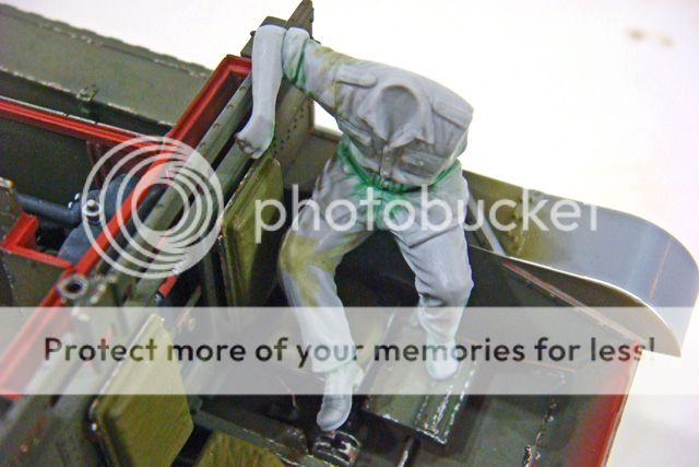

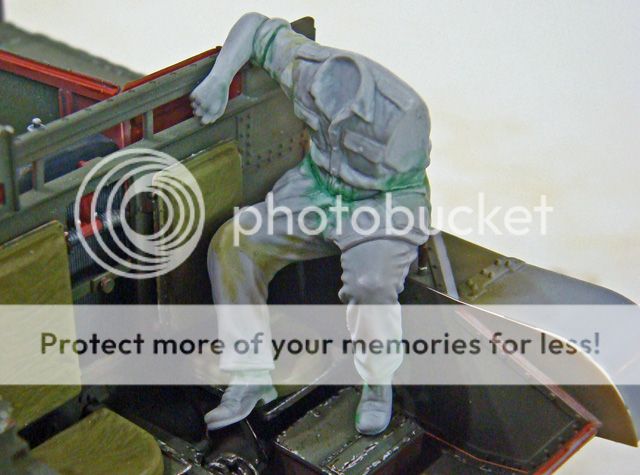

This guy is actually a lot more work than I anticipated. The kit includes a pair of open top stowage boxes, parts F5 and F6. Riich would have you add these boxes to the fender top right where the gunner is sitting. After some tests, it was obvious early on that they had to be omitted from the build since they prevent the gunner from going onto the fender.

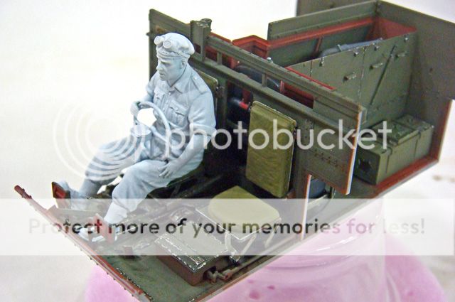

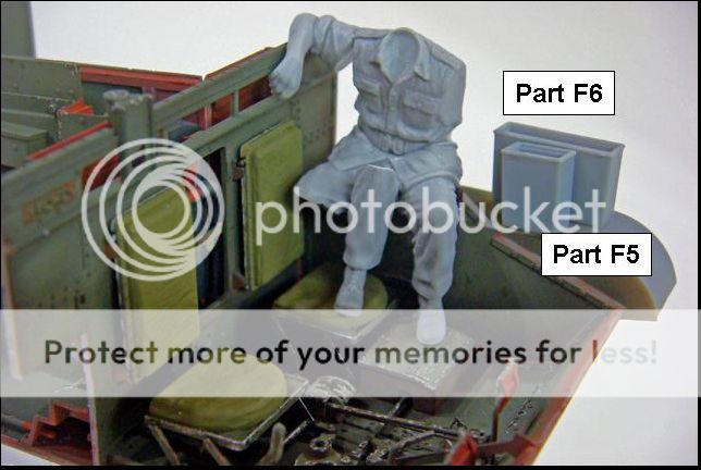

(Also, I didn't see these boxes on too many reference pics. Either they weren't fitted to all carriers, or the crews unbolted and moved them.)
Early test fitting showed that the gunner's right leg would have to be modified, but I kind of expected (HOPED!) that the rest of the figure would fit. Unfortunately, his right arm is either sculpted too low (if the boxes are left off) or too high (if the boxes are installed).
(With the boxes installed, the gunner sits so high that his left foot actually rests on the top edge of the fender.)
My first step was to fit the left leg and buttocks after cutting the right leg off at the knee. A bit of work to get a flat sit on the fender, and then I added the torso.
A bit of work was needed to get a good fit between the torso and lower body. While I did this, I sharpened up some of the other details, like pocket flaps, seams, etc.
I then worked on the right arm. Quite a bit of time was spent cleaning up the hand, and then after test fitting, I used a file to create a smooth area to sit on the rail on the top of the firewall. Once this joint was nice and tight, I fit the shoulder joint. This is the point where I stopped today to let the torso and shoulder joints set hard and dry.
Tomorrow, I'll reinforce the right shoulder joint and work on the right lower leg.
I believe that the lower leg will rest with the calf-Achilles tendon on the edge of the seat cushion. This will require posing the foot bent forward in a more relaxed attitude, shaping the rear of the leg and calf, then "crushing" the edge of the seat cushion. I'll then add back the folds and creases for the lower pants and the seat.
(Of course, this means removing the seat, adding material to the bottom, then grinding away the "crushed" edge for the leg to fit into.)
Unfortunately, I won't be able to pose the left arm until the carrier's upper front hull and glacis have been constructed, and that will have to wait until I have the upper hull sides finished (on their insides) and glued on. That will have to wait until I've built and fitted the radio and at least reposed the radio operator. (Hopefully I can add him after the carrier sides and radio are glued on. If he won't fit, I'll have to paint and install him first.)
And so it goes....

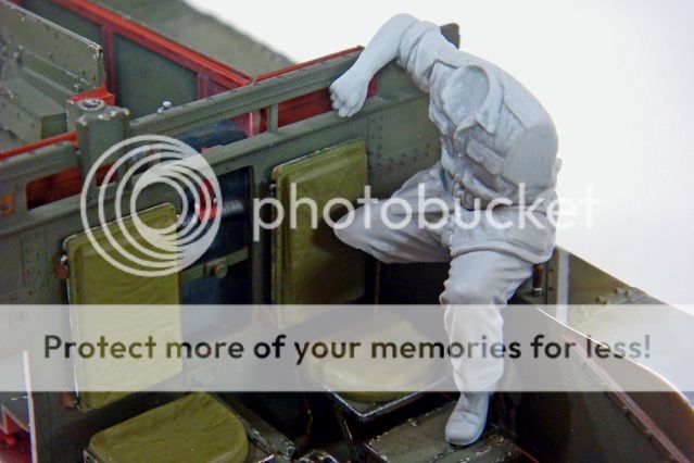

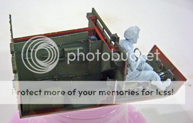

OK, well it's been a few days since I posted anything new, so maybe it's time to catch up.
Several areas are getting worked more or less at the same time. No need to repeat the whole explanation of how the build sequence has to be modified. It's enough to just say that all of these things have to come together during final assembly of the interior. Also, they all have to be done separately, but because they all effect each other, there's a lot of back and forth between one then another and back again...
First up is the gunner. He's about done as far as I can take him until the upper hull sides and front are done, then his left arm will be posed. Exactly where it'll go, I can't say just yet (except on his left shoulder ).
After some consideration and experimentation, I settled on his right foot and boot heel resting in the right front corner of his seat. I really didn't want to have to grind the seat cushion up and re-sculpt it, and in the end, this position looked more natural than what I initially thought.
He still gets a holstered pistol on his right hip and new uniform buttons, and I'll add those by and by, but until the upper hull get's done, that's all for the gunner.
More to follow...
