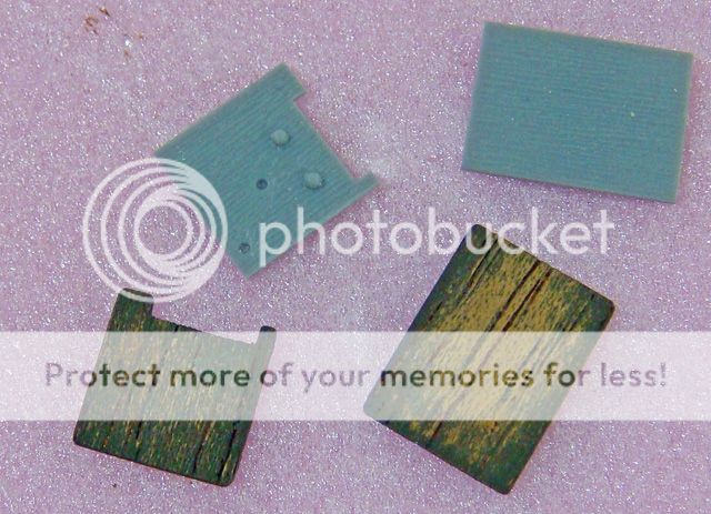

The first thing necessary was to make the duck boards that sit on the floor of the carrier. The radio operator SHOULD (!) have his feet resting on the duck board on his side of the fighting compartment.
The kit parts, F36 and F37, were fairly uninspiring, so I made replacements by laminating thin wood (used to wrap cigars) on to some .010 styrene. After painting these the base dark green color, I used some fine steel wool to rub some of the paint off and expose the wood grain.

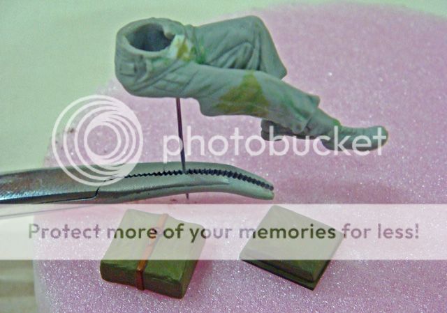

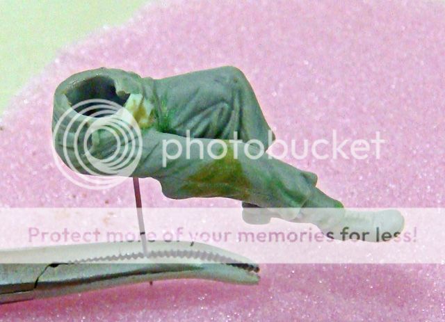

A quick test fit of the radio operator's legs showed that not only are they spread too wide to fit into the compartment, but if the B6 cushion is used, his feet cannot touch the duck board floor.
My first change was to move his knees closer together by trimming the two halves at a slight angle. This got his legs into the compartment, but the kit sculpted pose has him sitting at "attention" - very unnatural looking.
So, I pried his legs apart, move his right leg and hip down so that this knee was pointing more forward. I then cut his right knee apart and moved his lower leg to point forward. Both of his feet were cut off and the toes pointed down in a more natural position.
In order to get him to sit flat on the seat cushion, B7, I had to trim the back of his right thigh and buttock (after back filling the hollow kit parts with styrene). This looks odd in the photos below, but keep in mind that some of this in real life would be the back of his thigh "squishing" as the leg muscle relaxed. Also, the real seat cushion would "crush" under his weight. So the material I removed, in real life, would be accounted for by these two action.
Once positioned in the model, this area of his leg will be invisible to the viewer.
In this photo, you can see the reposed legs and the two seat cushions (B6 and B7) for comparison.

I've actually wanted to try laminating the cigar wrapper to see how it would look for quite some time, but this is the first project where I could use the technique.
I'm pretty happy with the results and can see that it has a lot of potential for some applications.
For these duck boards, I cut replacements out of .010 sheet styrene and pre-painted them in a medium brown. After that had dried over night, I used medium thickness CA glue to attache the thin wood veneer which was trimmed and sanded to size. I then painted that in the dark green base color, allowed that to dry, then buffed with the steel wool to expose the raw wood and grain.
I could easily see some nice effects with more than one base color used and buffing to reveal an even older, more worn look as if the wood had been painted several times over a period.

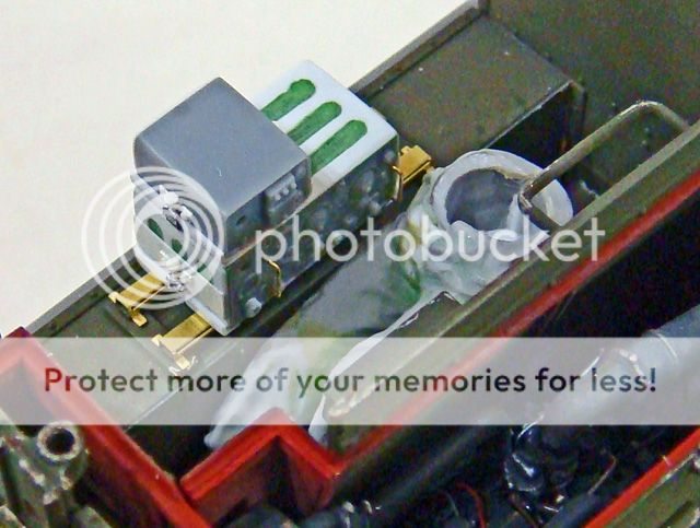

Some progress on painting and assembling the No. 19 radio set.
I've used the PE guard on the radio and will use the plastic guard as a part of a sculpting tool to press the creases into the radio operator figure.
Hopefully, the new mounting clamps show up better in these photos than they did in the last pics.
The wire sticking out from the right bottom corner of the radio is the ground wire which will be attached to the fender. The other wires will be installed as the interior goes through final assembly stages.
The radio and power supply case (as well as the variometer - not shown) are painted in the later SCC2 Brown since on my model, the No. 11 set has been replaced by the later No.19, and the whole thing, when finished, will represent a vehicle in Italy in 1943.
The radio and power supply faces (as well as the control unit No. 2 - not show - it's still under construction) are painted in a gray with white instruction plates. Other combinations are the gray with black data plates and a pale, greenish-yellow ("glow in the dark") color with black data plates. I considered the pale greenish-yellow, but didn't know when the glow in the dark paint was introduced (also, most of my reference pics show the basic gray or light gray).
I have a few other interior details on the carrier that I'm working on at the same time as the radio (while waiting for the paint to dry, etc), but I'll show those later.
For now, the radio is ready to install in the carrier once the radio operator has been painted and glued into position (the guard on the radio will prevent the operator figure from inserting after the radio).

Well, the research corollaries to Murphy's Laws were really beating me up after I got Steve's photos. Not only did his photos show all the details of the radio power cable conduit, but it also showed the missing choke control lever and cable.
Riich molds the cable onto the surface of part A15 (step 6) next to the driver's station, but this detail is very shallow. Until I saw the prototype photos, I thought the detail was just some UI wire. However, with the prototype photos in hand, it was obvious that there's a pretty substantial fixture and device missing. What to do?
Oh you know...
Again, this wasn't too hard to fabricate - layered sheet styrene and a scrap of twisted leftover PE brass. As with the radio power cable conduit, working around already painted and partially finished sub-assemblies was the risky bit. Before I could add the new parts, I had to scrape off the original molded-on detail.
So, Steve's photos also showed a couple of easy improvements in the painting and finishing.
Next to the radio operator is a stowage box for signal flares. The top of this box is painted green, white and red, to indicate which color flare are located in which part of the box. Sounds a little overboard, but apparently, this was a standard practice on Commonwealth AFV's. The photo below shows the re-painted box on my model, the box on the Ditsong carrier, and another flare box removed from a British tank (I don't recall which).
The color adds a lot of interest, I think, and I'm glad I found out about it.
Another feature that I needed to repaint was the box located in the foot area of the gunner's station. I had assumed that the box was all metal, and had distressed and weathered mine accordingly. However, the Ditsong carrier photos clearly show that the box has a fabric pad on the top front edge. So, I repainted this detail:
So, almost done for this up-date, but one more post, I think...
