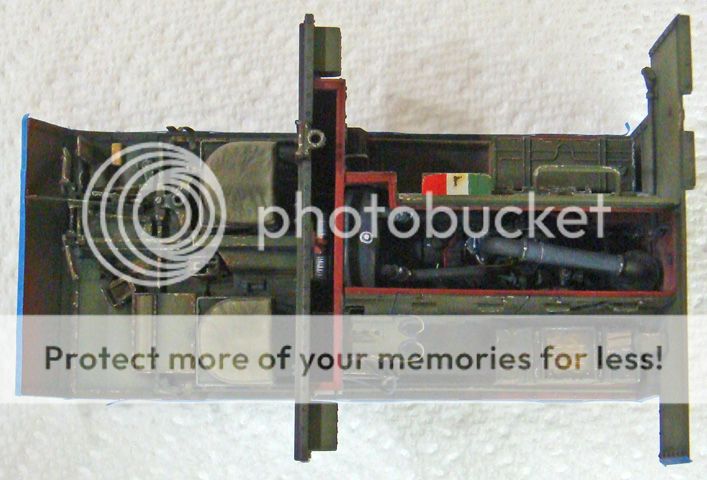

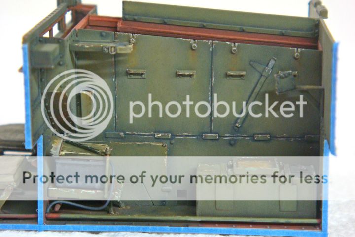

I've finally finished all of the interior paining (except the front hull and glacis) and am now ready to close up the hull.
As the following photos will show, I've decided to paint all of the hull component interors separately and then bring them together. This has allowed me to, hopefully, paint the interior to a high degree. The interior space is so very constricted that I didn't think that I could do an acceptable job after assembly. Not only were the interior areas pretty inaccessible with a brush, but I was concerned with trying to airbrush down into what are essentially three small, deep holes.
To summarize the basic finish:
1) Many areas received a primer coat of Floquil Oxide Red.
2) The base coat was a pre-shaded G3 Khaki-Green.
3) I then painted the details with acrylics (artist oils for all of the seat cushions).
4) The basic finish was "distressed" with "sponge chipping" and additional "chipping" applied by brush.
5) Color modulation, pin washes and rain / rust streaking was accomplished all together using artist oil paints and mineral spirits. All of this was done at once (with each color applied one at a time, though, to maintain the distinctions) since the areas being painted were so small.
6) A "dust" glaze was airbrushed all over.
7) A final clear flat coat of Testor's Dull Coat was applied.
These basic steps were followed for all of the separate parts as shown in the photos. (Note the blue tape strips were applied to keep the gluing surfaces clear of paint. This is just ordinary blue painter's tape cut into narrow strips with an X-acto knife.)

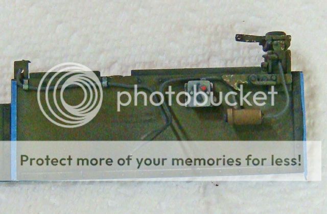

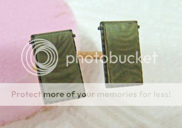

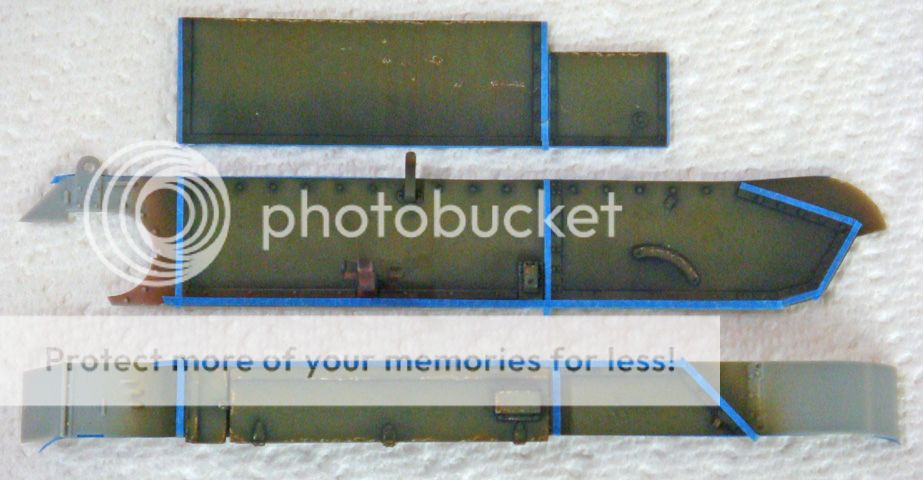

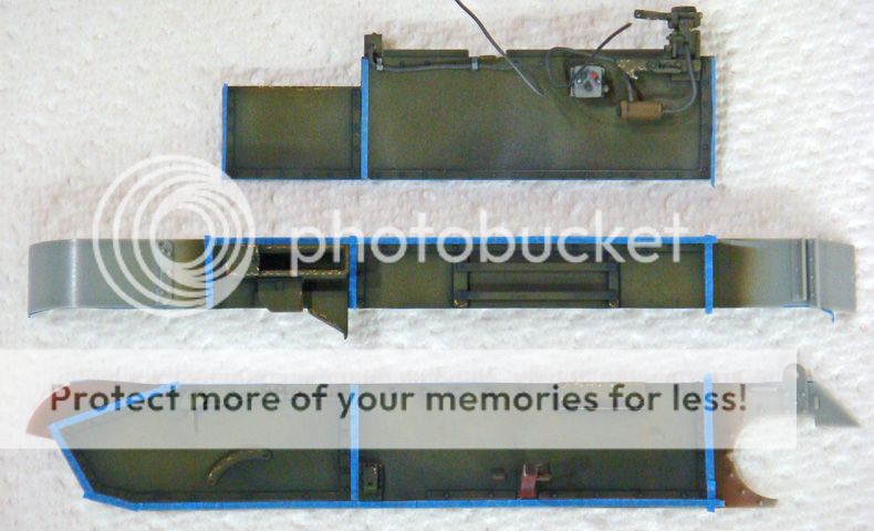

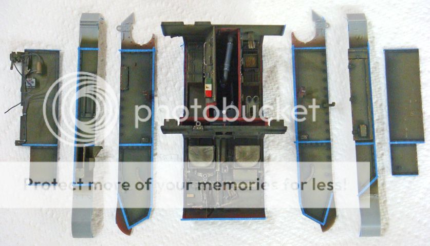

Here are all of the basic hull parts ready for assembly.
Here are a couple of close-ups of the right hull side parts.
Obviously some intermediate assembly was done with the antenna cables and other radio components.
Here are the left hull side parts.

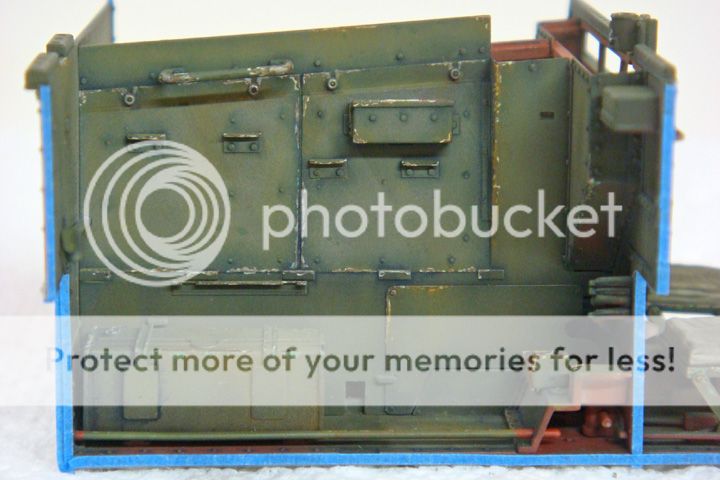

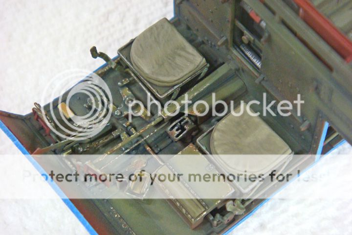

Here's an overview of the center hull sub-assembly and close-ups of the driver's and gunner's positions, as well as the sides of the engine compartment.
If you compare these photos to the earlier ones taken right after some of the detail painting and chipping, you will hopefully note how the high contrast between these areas and the base coats is now much muted.

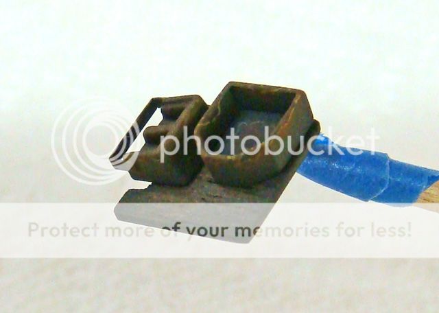

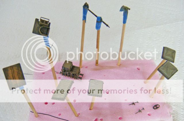

Of course, there are several details that I finished separately and which will be added in the next assembly stage.
All of the small details were painted exactly the same as the larger parts to maintain continuity of the overall finish. As examples, below are close-ups of some of these.

I was goofing off with the photos and rather liked the lighting on this one, so here's a slightly different angle.
Not bad Mike, the wood props (spacers) are bit 'underweathered' though!

Yup,I see those chips and dings look a whole lot better with the toning down. Looked a little cartoonish before.
Lookin really good and as I've said,more detail per square inch than anything I've yet seen!

@ Keith: What?! You don't like the timbers? I was experimenting around with a nautical theme - maybe a damage control vignette with the carrier badged-up in Royal Marine markings and submerged up to the fenders.
(That way I don't have to build the suspension... You know me, always looking for a shortcut!)
I thought I'd entitle it something like "Torpedoes off the Starboard Bow!" or some such...
But to hear now that you don't like it. I'm crushed!
@ Jerry: Well, I guess it's all about shadows, highlights and contrasts. I think that sometimes you have to start off with tons of contrast to compensate for the weathering and other scale lighting effects.
That, and the space involved is so small that without the contrasts the detail would simply go un-noticed.
The entire carrier is 4 inches long from fender tip to fender tip and only 2-1/8 inches wide.

So, after allowing the lower hull sides and fenders to dry overnight, I caught up on things today.
I have to say, the thing is starting to finally look like a carrier, but dang, it is small. I think I'll tease the airplane guys at the IPMS meeting about it being all cockpit and no wings!
Anyways, I added the final interior details, like the webbing strap handles on the Mills Bomb boxes, the flair box, and the retention straps on the "mystery" brackets (which are holding my Bren MG anti-aircraft mount). I also added the seat back cushions and the power cable for the radio.
The it was on to the upper hull sides. These fit pretty well, but I did shave off the "segmented tongues" for the "tongue and groove" locators at the rear corners. I just took my time and glued the upper hull side parts on starting at the rear hull corners holding them until the glue had a chance to set up some, and then worked my way forward, doing one side then the other.
A little touch up with some small "squirts" of Testors Dull Coat to blend in a couple of glossy glue marks, and with the exception of putting the figures in, I'm about done with the interior... finally.
Some picture form today's work.
A few close-ups of the details. Keep in mind that the entire rear fighting and engine compartment is about 2 inches by 2 inches in size.
Finally, a test fit of the driver and gunner shows that they will still go into their assigned spaces. I was actually a little worried when I was putting the driver in. The tolerances are so tight that at first he wouldn't fit, but then I got him oriented correctly, and down he went!
This was a pretty big milestone in the build - getting the interior closed-up.
