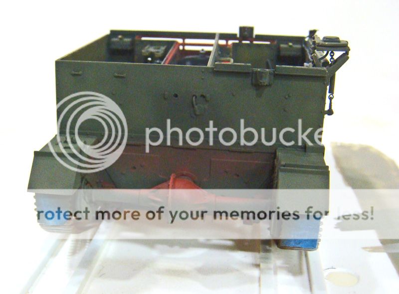

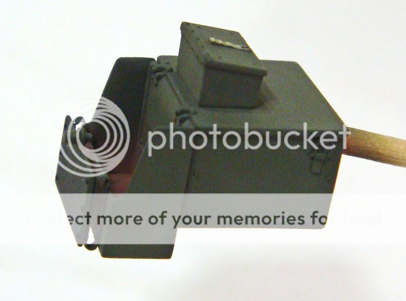

Progressing through the unfinished kit steps, I tackled step 42 today. This is where the radio battery box, the POL cans and stowage rack and the (elliptical spring sprung!) rear number plate are constructed.
Doesn't sound like much of a day's work, but this little sub-assembly has 21 parts, four of which are PE. It all goes together par for the course - that is, very nicely.
The only significant challenge is forming the two PE elliptical springs that the rear number plate is mounted to. These certainly give this area of the model that "classic" Universal Carrier look. The number plate appearing to hang suspended in the air is very characteristic, and FWIW, I think Riich has done the subject justice.
I used a .030 dia drill bit to form the two semi-circular bends on the PE spring parts, Pa6 x 2. Keeping these bends equal and the springs the same length is important to getting a good fit on the number plate. I would suggest slightly reaming out the three holes on each PE part that accept the bolts molded on the reverse of the number plate to give you a little "wiggle room" for adjustment. If you need more adjustment, then the molded on bolts can be trimmed around to make them a little smaller in diameter.
I soldered the joins on these parts, too, for added strength, but if they're formed well, they will almost stay closed on their own. CA should work with some care.
I did scratch build the short section of pipe conduit that the electrical wires for the tail light on the number plate. I basically made this the same way as the conduit for the radio power lead.
If I ever build another one of these Riich carriers, I will scavenge the injection molded headlight wiring conduit, part A37, step 30, to make the radio power and tail light conduits. Part A37 is not visible under the upper front hull / glacis, and the parts that are visible, A30 and A56, are all that's really needed there. This would leave A37 available to make visible missing conduits.
Anyways, here are a couple of pictures of the battery box assembly from step 42.
Like I said, IMO, Riich has done this quite well, and the details match available references closely.

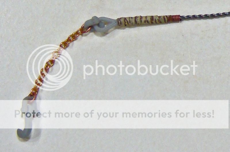

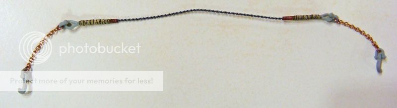

First, Riich gives us 15 parts to assemble the Universal Carrier tow rope - one piece of nylon string, 4 PE split rings, 2 pieces of chain, and 8 injection-molded parts.
After cleaning up the plastic parts, I checked the nylon string against the eyelets only to find that the string is much too large to fit into the slide molded holes. In fact, the string is larger in diameter than the tow-eye ferrules, so even drilling them out is not an option.
This was too bad, as I had planned on the color variation of actual hemp rope vice the typical wire rope. The prototype photo in Riich's instructions shows an original tow rope made of large diameter hemp, and that would have been an nice "vintage" touch to my carrier.
Oh well... Plan B. Checking out all of the tow ropes that I could see clearly in period photos showed that most were made of a thin wire rope anyways, so falling back on my usual techniques, I twisted a new rope from .010 dia lead wire.

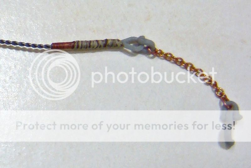

These photos also showed that most (if not all) of the small wire ropes had their ferrules (the portion between the rope and eyelet) wrapped in some sort of fabric or paper. So, after cutting my rope to length (57 mm), I added thin copper wire wraps and glued the rope to the kit eyelets. Next I added this wrapped material from thin tissue paper strips.
Since I was going through all that effort, I decided to replace the kit's PE split rings (which lack an appropriate thickness) with rings made from 28 gauge brass wire. I formed this by wrapping the wire around a 1 mm dia drill bit, and then cutting the rings from the resulting coil.
Riich does not specify the length of the rope or chain pieces. I estimated the length for my rope from photos. Studying the instructions, Riich depicts the two chain pieces in two different lengths - one 12 links long and one 15 links. I chose to go with 15 - just because...
All of the shackles and hooks are just press-fit to assemble. The split rings are simply spread apart, the chain and one shackle are threaded on, and split is closed.
Here's the result.
In these pics, I've pre-painted the material wrapped around the ferrules to protect the paper and white glue.

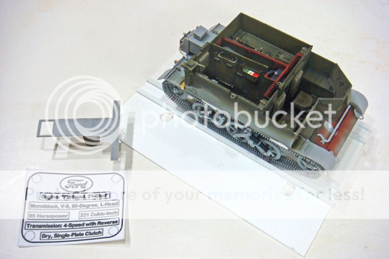

This is an initial composition test to check on the relative sizes of the main components of the planned display. The hull front is still just dry-fit pending installation of the driver. The model is really starting to look like a Universal Carrier now, though...
The paper tag with the engine data is a mock up to get a better idea of how large or small that should be. I plan to display the carrier with the engine compartment top off to the side so that the engine details can be seen.
I have some fairly firm ideas for the terrain and other display elements and will show those as I mock them up, too. Right now, I'm just testing various arrangements to get a better idea of how the overall space will work. Smaller is better, but there needs to be space for a couple of other elements needed for visual balance.
In regards to the rest of the build - I've completed all of the construction. There are still a bunch of sub-assemblies and parts that will be finished and installed as the carrier moves towards total completion. I'll post up a few pictures of these parts when I get a chance.
So, next is to move everything over to the painting bench.
I'll finish the inside of the front hull and then start painting the figures. Once the figures are done, I'll be able to install the driver and close-up the hull. I'll also add the radio operator and radio. This sequence will hopefully mitigate the effects of handling the carrier as I move on to finishing the exterior later.
(I anticipate a lot of handling as I install the radio operator and radio. This could be rough on the exterior finish, so do the figure installation first followed by the exterior finish.)

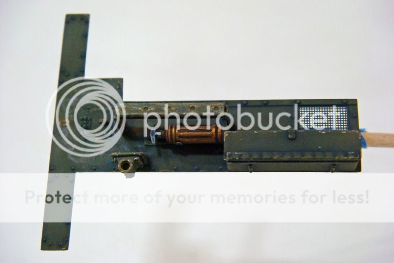

However, since you've asked, here's a little up-date. Sorry there's not too much to show, but hopefully it'll keep ya going... I hope to have some of the goooood stuff soon!
So, after I finished cleaning up all of the parts and readying everything left on the carrier for finishing, I did some preliminary painting on the rear hull sub-assemblies.
I wanted to get the "factory" colors on these sub-assemblies before I assembled them and moved to the weathering and field-applied camouflage. The way these parts overhang each other means that there are a lot of areas that would be hard to reach even with an airbrush. I'll also do some preliminary weathering up under the "luggage shelf" and in the final drive area before I permanently glue all this up.
Since I had the dark green mixed up, I went ahead and used it all up on a couple of other sub-assemblies, like the sand shields and the engine compartment top.

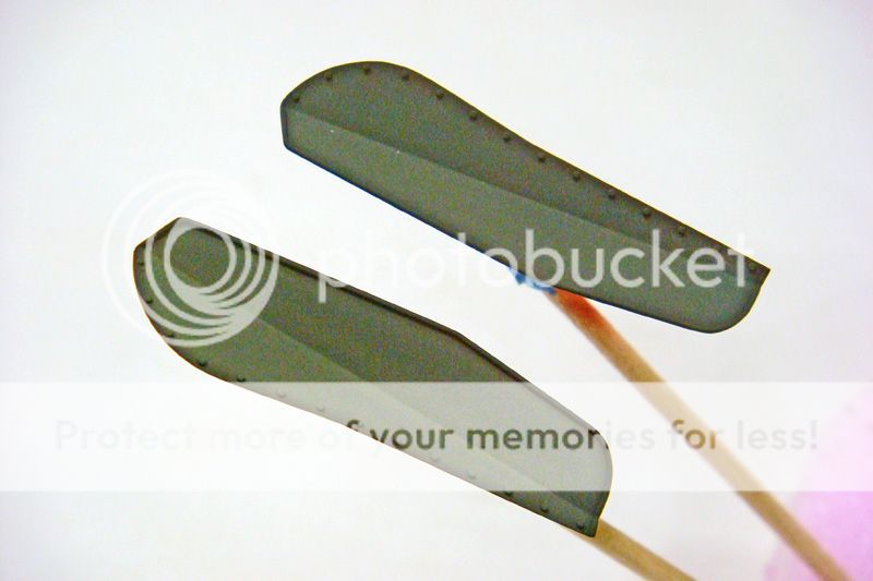

The sand shields have been thinned by sanding on their reverse sides. It doesn't show up in these photos, but they're almost paper thin now. This was pretty easy to do just using a small sanding block and patience.

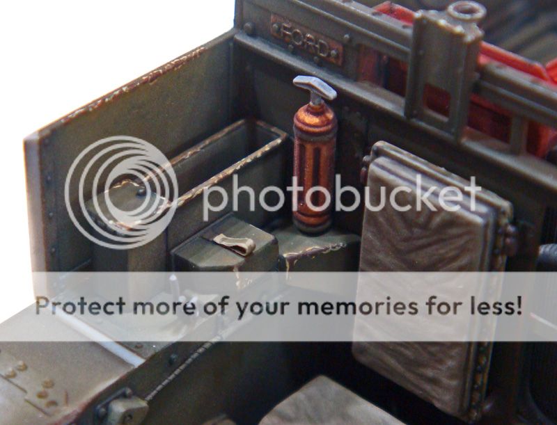

The engine compartment top still has its Pyrene fire extinguisher to add. The Riich PE fire extinguisher mount is very nice, but it's also a fairly complicated folding job. I also found that I had to move my mount slightly to the right (about the width of the molded on mounting bolts) to avoid the long stowage box. It's entirely possible that this requirement was my own doing given the difficulty I had folding the mount. But, hey, what's a 1/3 of mm between friends?
There's quite a bit more painting and weathering left to do in the engine compartment top, but you can see all the parts on it now.

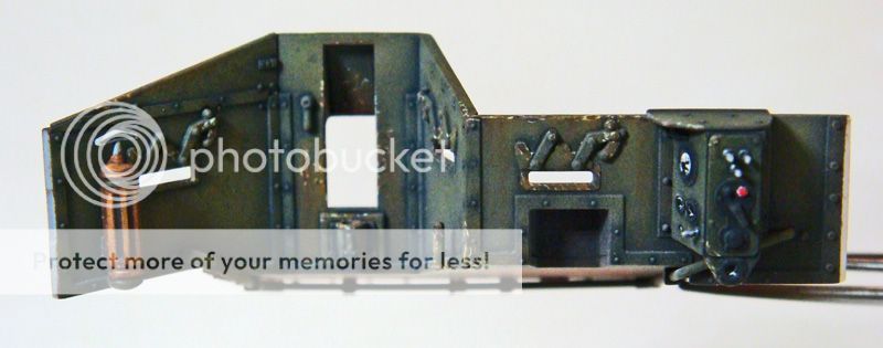

My main effort over the last few building session has been to finish the upper front hull so that it's ready to close up once the driver is painted.
I did a little extra work on the instrument cluster since it has such a prominent place. I replaced the molded on toggle switches with bits of brass wire and added a half-wing-nut switch from left over DML Pz IV parts. This required shaving off the molded on wing-nut switch. I also added a large button to the center of the starter switch.
The gauges are done with the kit decals. It did take several applications of decal setting solution to get these to settle into the molded on instrument faces. I finally resorted to Testor's Decal Solvent - Mocro Sol just wasn't getting it done.
The upper front hull is close to being done. Obviously, I still have to add the instrument cluster (when it's finished), and the entire sub-assembly will get a "dust" glaze followed by Testor's Dull Coat.

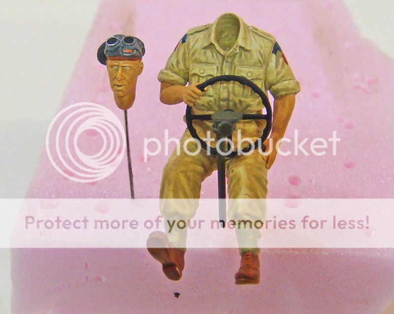

Once this is done, I'll get serious with painting the figures.

@ Keith: Oddball colors is right! The one bottle I special ordered was based on what I'm pretty sure was a typo in the paint mix discussion I was referencing.
At any rate, I think I have the "light mud" color mix sorted out. More on that when I get to the actual camouflage painting.
Still, that light sky blue gray threw me for a loop!
Odball color, yer durn tootin? Had me 'puggled'from the moment you asked for it but I have learned not to question your reasons as you seem to pull reference material out of thin air.
But then again, I am certain I shared some references to WW2 paint colors and the dates and timings orders for them, with you some time ago... May not cover Canuck items but still they may be helpful to you.

@ Jerry: Not too much with this next little up-date, but hopefully it'll tide you over a bit...
So, I've finished the upper front hull. It's now ready to glue on as soon as I have the driver painted.
I had intended to add the kit-supplied armored glass vision blocks, but they're slightly too large to fit. This fit problem is probably a factor of the paint inside the frame / openings. However, raw plastic is not an option. I also think that trying to trim them down and then polish out any resulting blemishes will be more work than making new parts.
I'm still thinking about what I'm going to do to replace them - either Micro Crystal Clear or .010 clear styrene sheet. More to follow...
I also added the Pyrene fire extinguisher behind the driver and added the wiring bundle that exits the chase next to the driver and curves up and into the space behind the instrument cluster.
I've also completed the engine compartment top. My plan is to display this off of the carrier, something like the initial mock-up posted earlier.

I've moved on to painting the figures.
As some of you may know, I'm something of a traditionalist when it comes to figure painting. I work in artist oils over acrylic undercoats. Artist oils are one of the three main mediums used for figures - hobby enamels, acrylics and oils - and oils are the traditional medium used by most figure modelers until the advent of modern acrylics like Andrea or Vallejo.
Some of the earlier posts have shown the figure conversion work with the priming done with Tamiya XF-2 Flat White. I like starting with the uniform white since it shows clearly where any additional work is needed and any colors applied over it will show "true." Also, the white needs very little in the way of acrylic paint for the undercoating.
The acrylic undercoating helps with the oil paints in a couple of important ways. First, having a color close to the desired final color means that less oil paint is required to get good coverage and also that the primer color won't show through if the oil paint is brushed out too thin. Oil paints need to be brushed out just about as thin as possible or else it's very easy to get too much paint on the figure.
Sometimes the undercoat color can be used as part of the actual final shading and highlights. For instance, on these figures, their boots will be black, but I've undercoated them with a burnt sienna color. When I put the black oil paint on them, I can deliberately brush it out to a semi-transparent layer on the high points in order to get the underlying brown to show as if the leather is worn.
Also, because the acrylics are not affected by the oils or the mineral spirits used to thin them, any details first painted with acrylics can be incorporated into the final look. The acrylic details can also work as "place holders" for later details painted on with oils. Again, on these figures, I have blocked in the regimental shoulder flashes and division insignia with acrylics. I will paint over these with oils, but the acrylics will hold those shapes for me. If I screw up the oils over them, a moist brush will clean the oils off leaving the basic acrylic shapes intact.
Finally, undercoating with acrylics can help in establishing the color pallet to be used. The acrylic colors don't have to be exact matches, but they can be used to get ideas about how to vary colors and tones from item to item and figure to figure. Using thin acrylic coats can also help show where the clothing folds and shapes are as well as help the details to stand out.
Anyways, enough about the theory. If anyone has any questions, please don't hesitate to ask, but since most guys now use acrylics and a glazing technique, I won't spend much more time explaining my oil painting technique. There's not a lot of cross-over between the basics of the two.
Here are my carrier figures. The undercoating is pretty much done. I do still have a few small details that I'll pick out with acrylics, like the belt buckle on the officer / gunner figure. But essentially, they're ready for the oils now.
The figures are all wearing various khaki drill items with the driver and radio operator wearing the Airtex shirts.
They will be badged out as members of "Princess Louise's IV Dragoon Guards," the recce regiment of the Canadian 1st Infantry Division. The 4PLDG shoulder flash was one of those that incorporated the Dominion name into the flash - no separate "Canada" shoulder flashes.
The division insignia is in a very dark red right now, but it will be highlighted in lighter and brighter reds later.
I decided to make the "gunner" an officer just for variety. Also, I intend to mark the carrier as a HQ vehicle for B Squadron, which was heavily employed in southern Italy starting in September, 1943. At any rate, an officer makes sense in one of the squadron carriers equipped with a radio.
