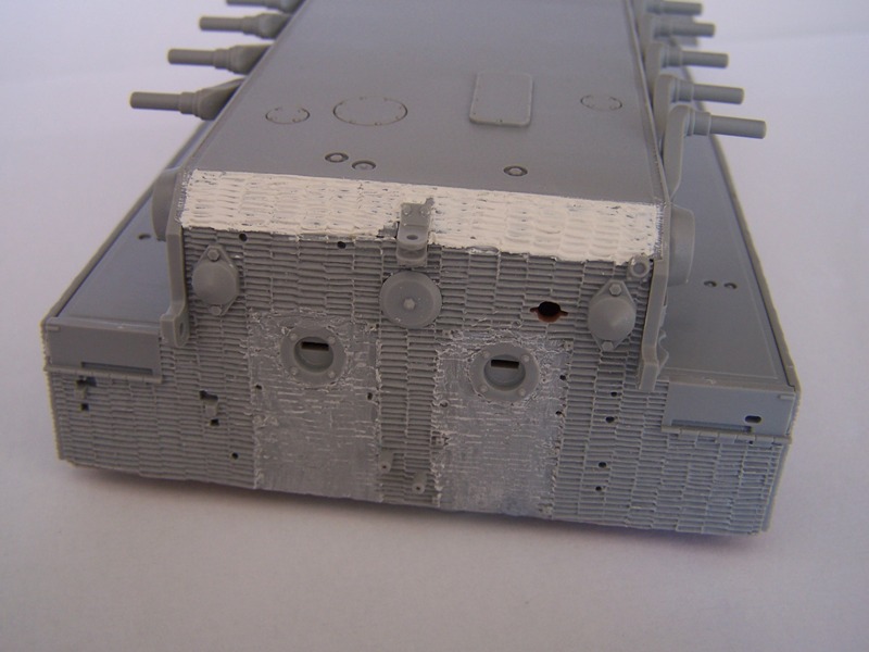

I'm presenting my work on 1/35 Dragon Tiger I Late with Normandy scheme-that of Will Fey (number 134) from 1/. SS Schw.Pz.abt 102
Now the panzer is painted, but I will post the previous steps one by one
Voyager set 35179 is used, and also will replace the DS tracks with AFV Club ones.
Some figures will be added after all the painting and weathering

I'm working on that Tiger for several months,so now I'm at the decals, they're put on with the help of Microsol. No problems laying them on the zimmerit
Also ready are the tools, some other small things should be painted and next is filter, washes etc.

The only things that I don't like are the DS tracks and some work will be needed to remove the zimmerit under the exhausts and add such below them.
