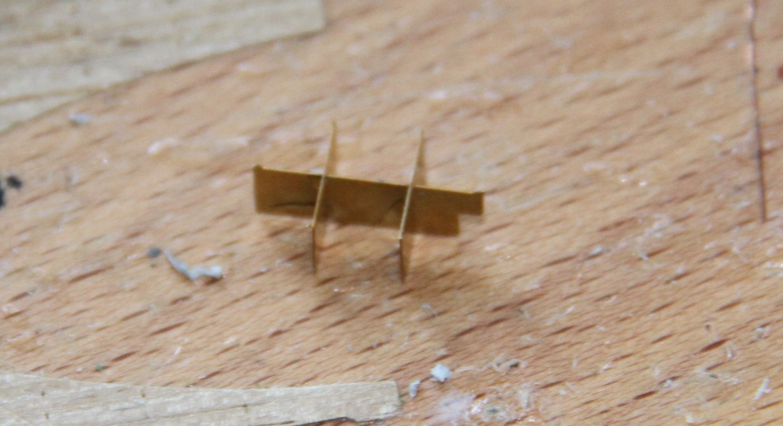

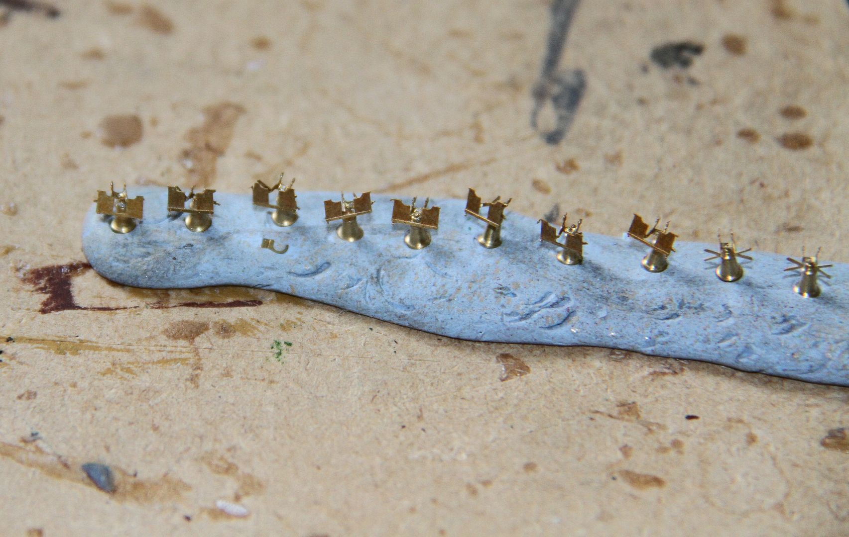

Having found the lead for my camera, on with the update on the Duke.

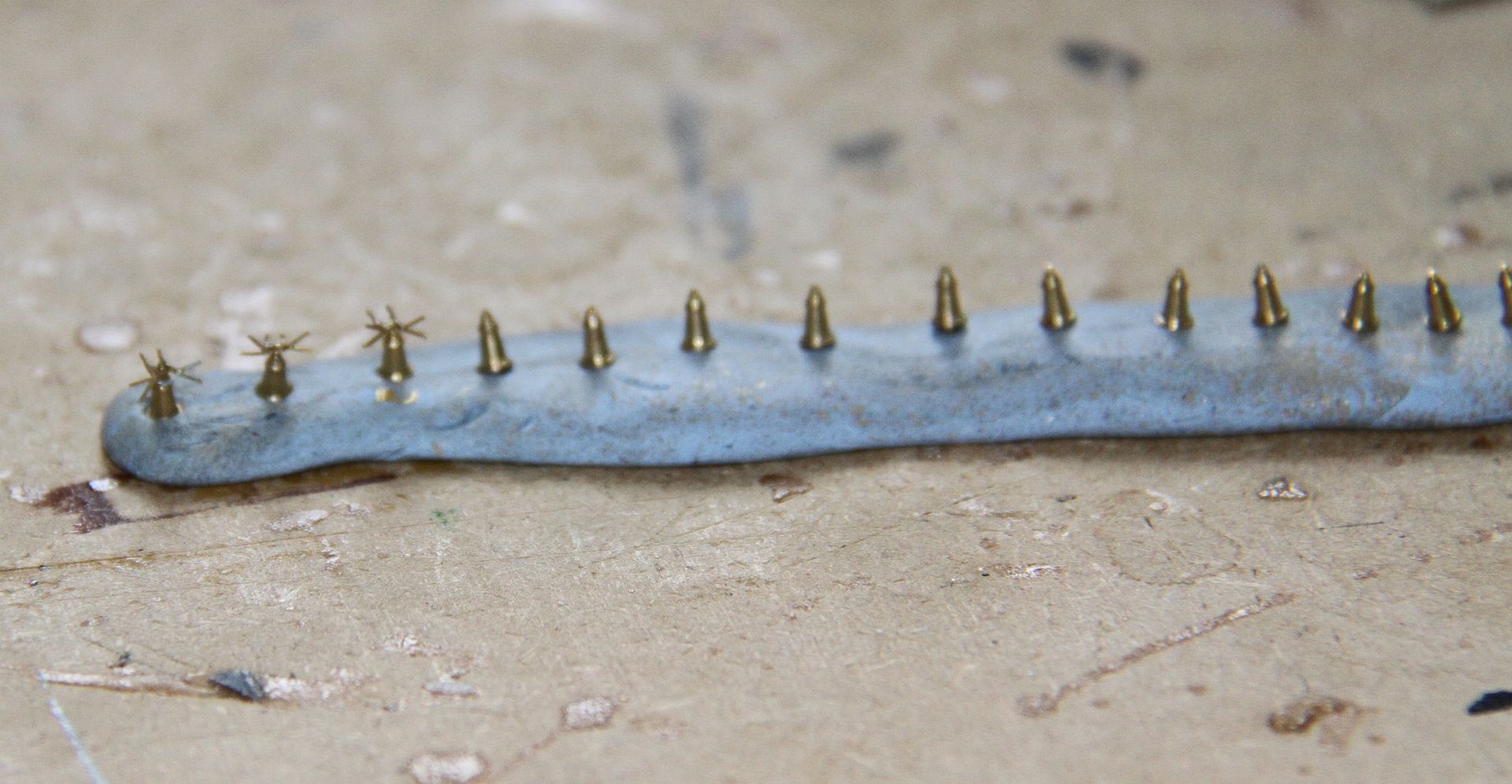

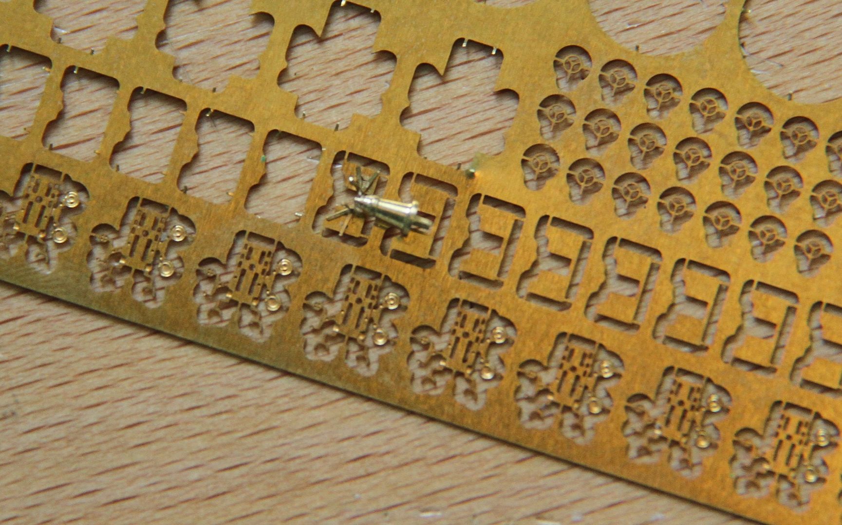

A production line for single 20mm has been started, requiring 28 for the build, I am doing it two batches, the first of 16 to cover the 10 in pods on the fo'c's'le and quarterdeck, and the six on the lower bridge deck.
The shield mounts were a little tricky as the holes in their base in most cases were smaller than the pins on top of the pedestal, also even stacked to the fret they did not react well to enlarging with a file.
Here is the first 3 in place.
One Trick I quickly learnt was to attach the shield whilst it was still on the fret.
Half way through the shields I decided that was enough of a strain on the eyes for one day.

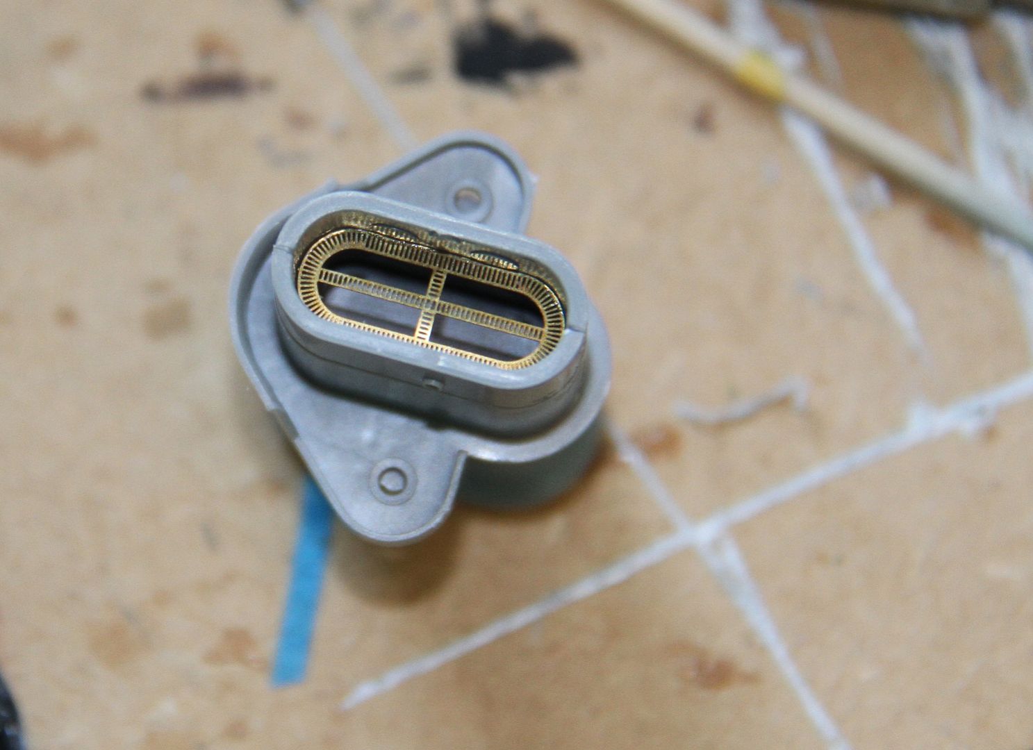

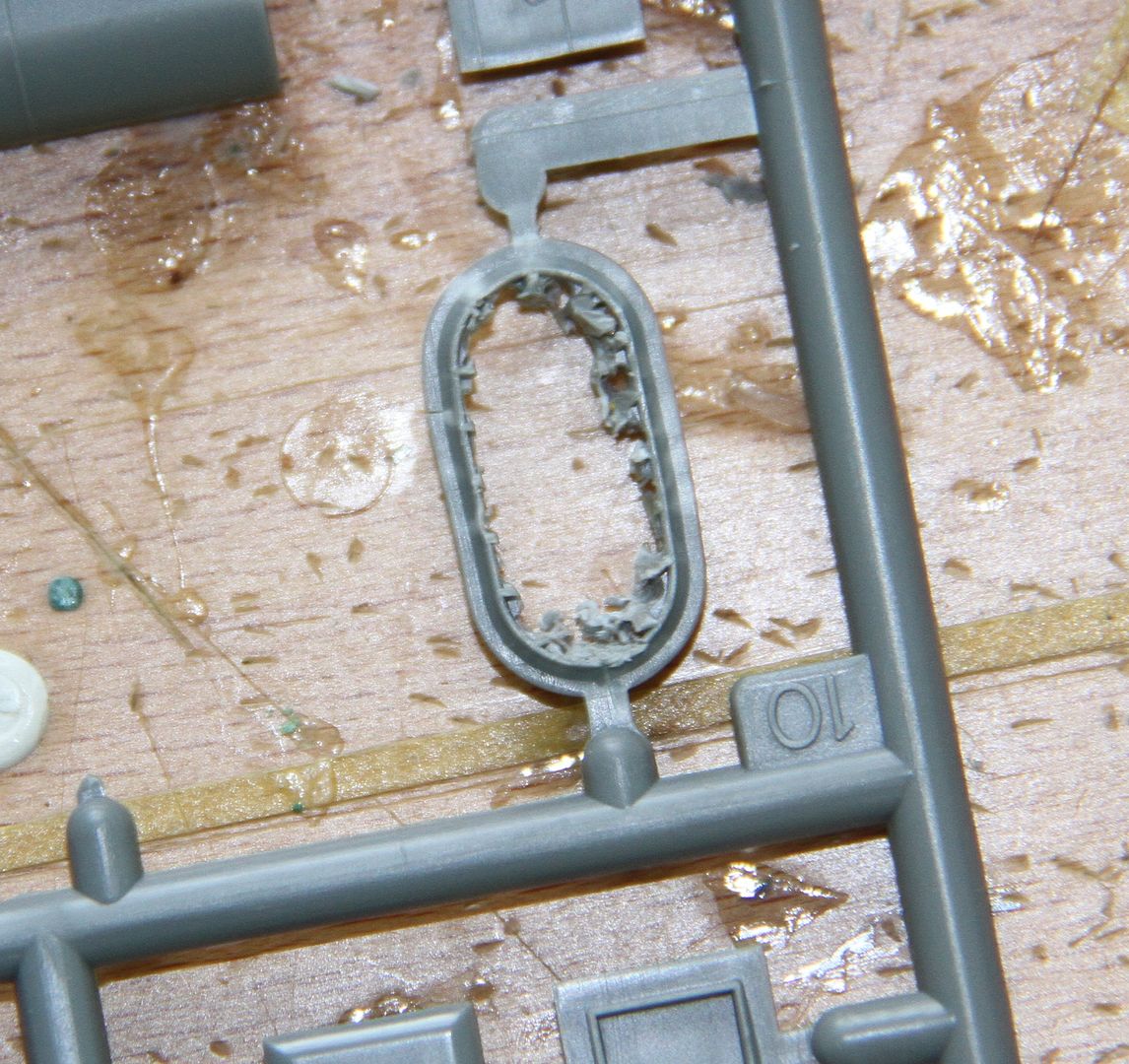

For a break I started on a bit more destruction, the moulded on funnel caps.
Firstly chain drilled.
And then the middle hacked out.

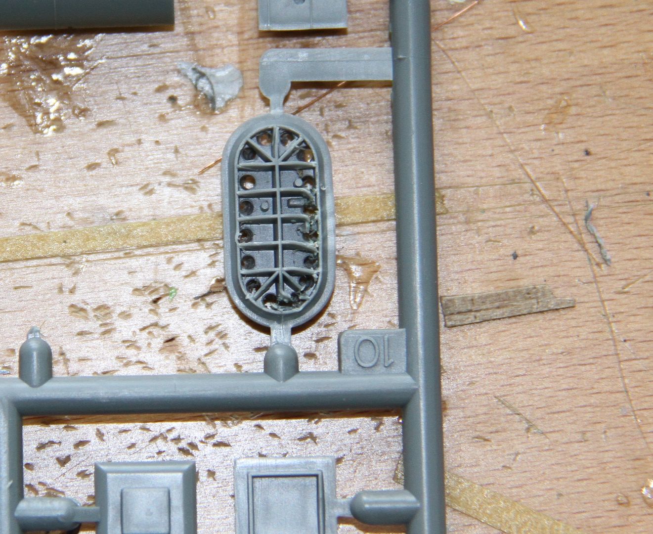

Each funnel has it's own interior detail, the after funnel has a walkway.
The rear section of the platform has been removed since the above photo was taken to make room for the etched replacement.

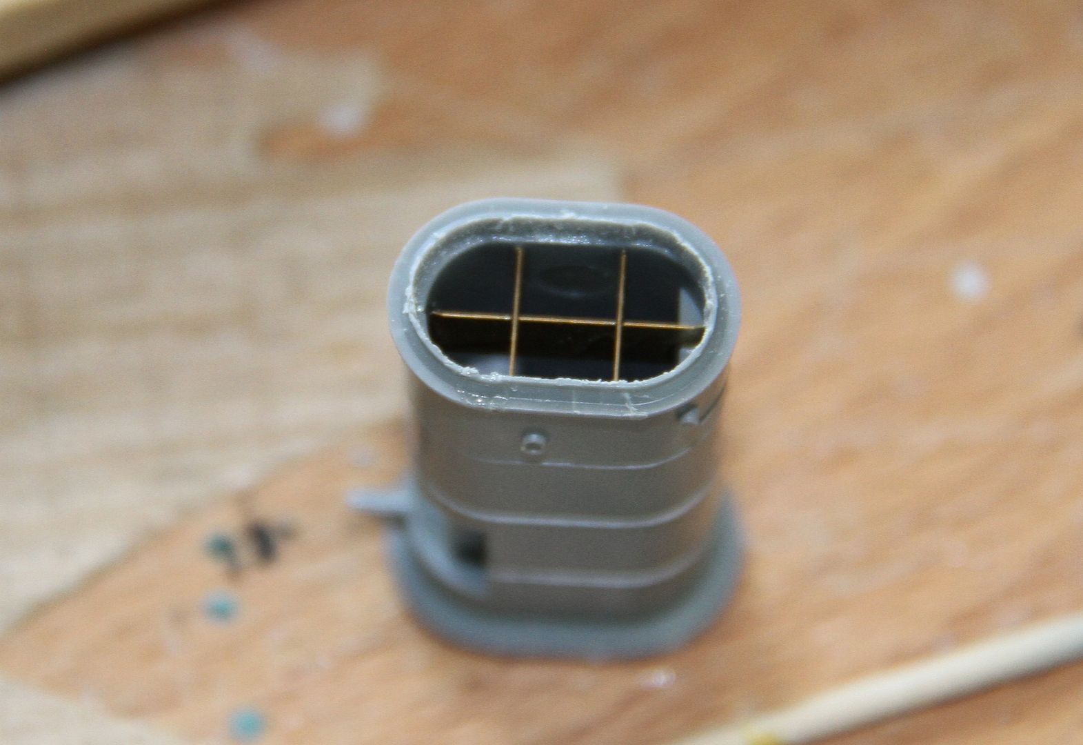

The forward funnel as a grid.
and fitted along with the opened out cap.

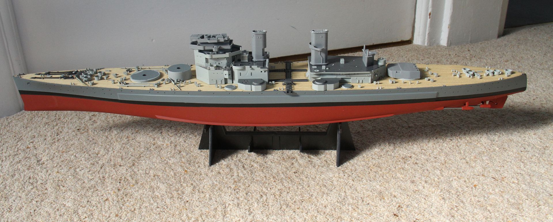

Finally a view of the project with all the partly finished sections in place.
A long way from done, but starting to look like a KGV.
