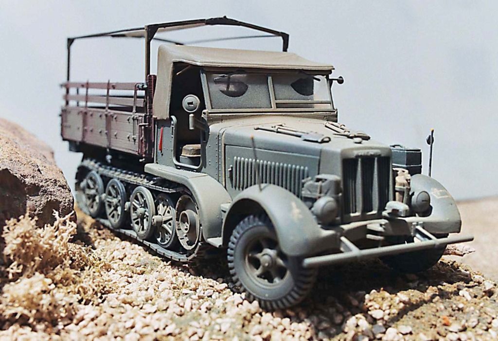

I suggest using small diameter Evergreen rod for your width markers. The soft plastic is way more elastic and "forgiving" when bumped into than either the molded kit part or brass rod.
Dip the lower end of the rod in thick paint several times and allow to dry thoroughly to form the lower fennel base. Same process for the white "vision" ball on the top of the rod. The plastic rod will accept some forming and bending (not unlike fine wire) if to need to bend an angle into the marker.
Drill a small hole in the vehicle fender and apply glue from below to mount the markers.
You can manufacture hundreds of these markers for practically no cost and in whatever diameter and/or length your model calls for.
Regards -- Mike
p.s. A small plastic disk forms the rearview mirror if desired.
(See photo below)
(I have only had to replace one marker due to breakage in the last eight years since replacing them with Evergreen rod.
I now do the same thing with all those L-O-N-G review mirror stalks on all the US CCKW's I build!)
