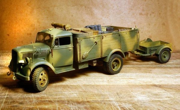

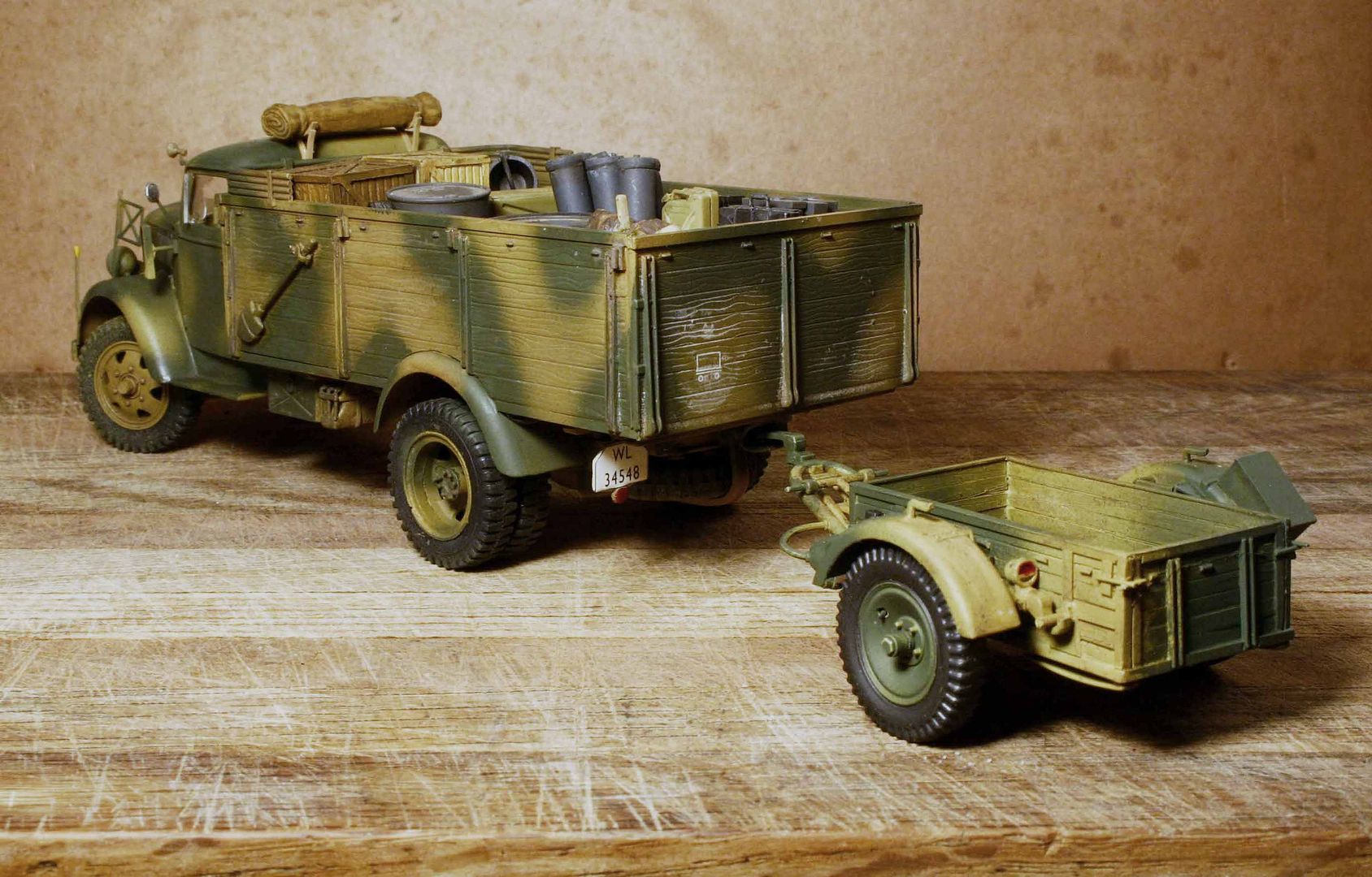

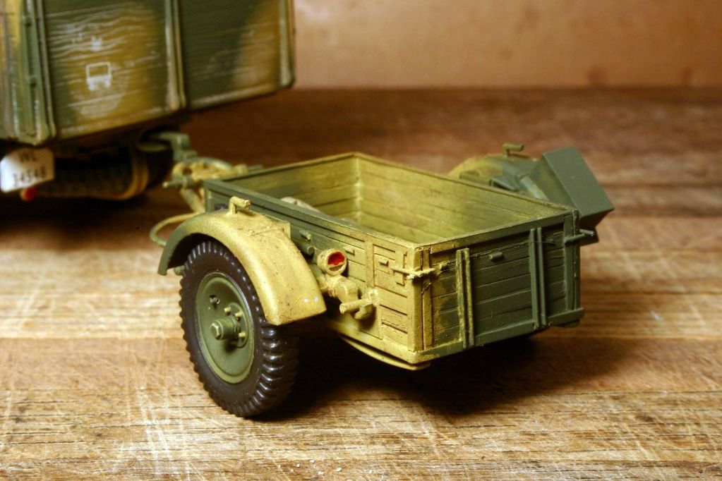

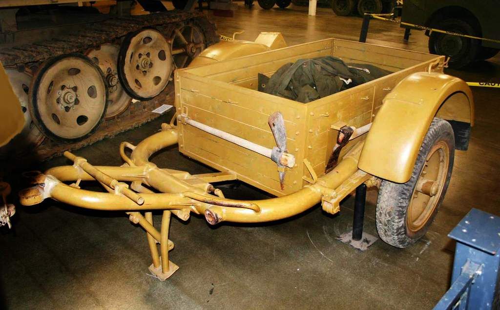

A simple small scratch project as a "starter":
Open top German box "tool" trailer on a standard Sd. Ah. 51 flak carriage. Maximum load capacity rating 3/4 ton.
Reference photo from Victory Museum, Auburn, IN. ( Copyright Michael Koenig 2005 )

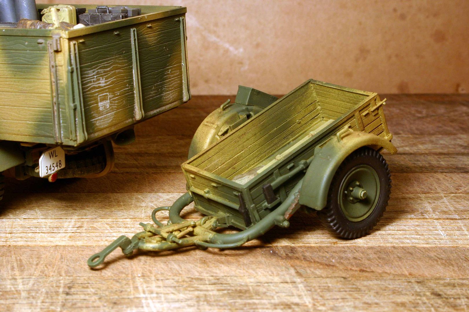

Photos of finished model:
Individual board on board model construction using Evergreen strip stock distressed by dragging a hobby saw lengthwise over the plastic to create the wood grain affect. Some Evergreen angle, U channel and rod stock also used.

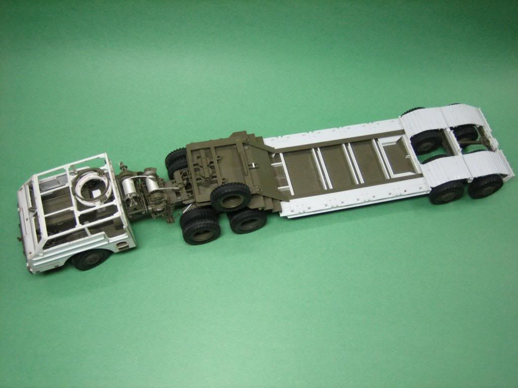

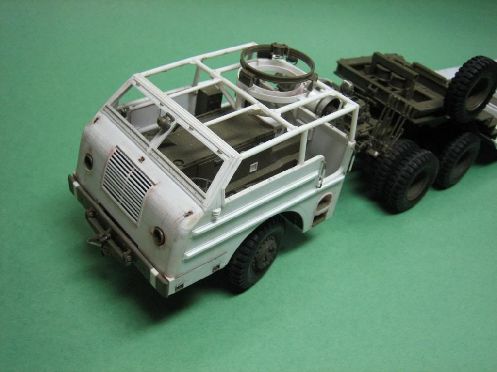

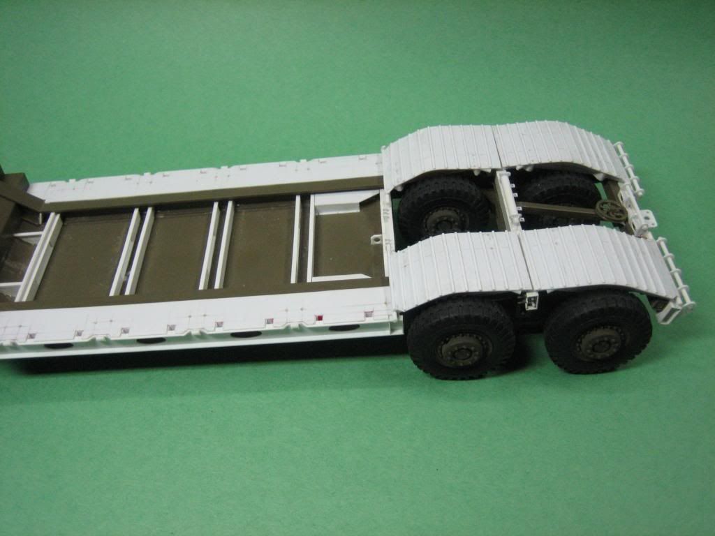

Here is a link to Ralph's (Call sign Mech) scratch builders album and also some photos of his work on the post war soft cab Dragon Wagon:
http://s1301.photobucket.com/user/scratch-builder/library/?sort=2&page=1
(Both the link and the photos below are reproduced with permission.)

Beautiful work I would certainly like to emulate.
Be sure to check out Ralph's other fine scratch work on the link!

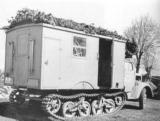

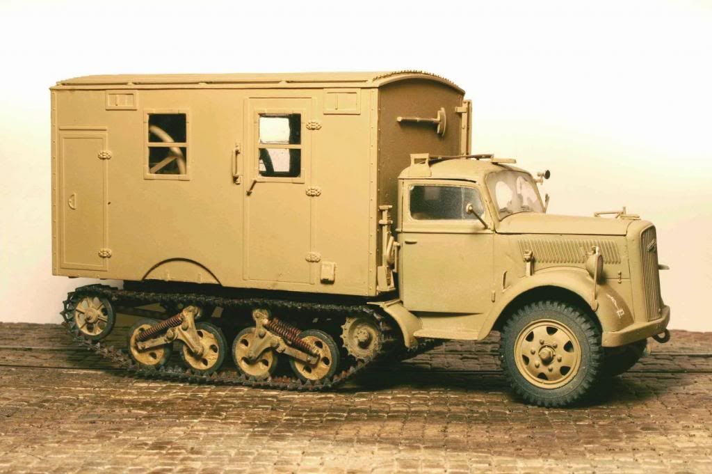

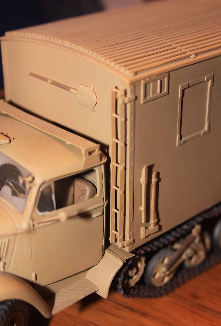

Fairly easy conversion of Blitz Multier (Mule) to V-2 Cable Service Vehicle. Add Radio Van house body to Mule, then some small scratch built parts. (Homemade road wheels are optional.)
Or just start off with the relatively new Dragon Mule Ambulance kit and you are 90% of the way there! You will need to remove the raised center clerestory and re-cover the entire roof with a piece of plastic sheet stock but that is easily done. If you do not feel like scratch building the correct back wall of the shelter box them perhaps you have an old copy of the Italeri Blitz Radio Van lying around. You can get the nearly correct real wall and the correct roof from there.

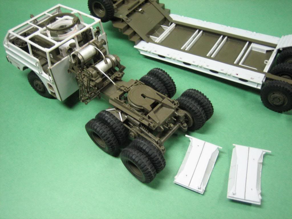

Hi everyone
I forgot to mention that the soft cab on the M26 is removable so that I can finish detailing the interior and paint it and I sill have a lot of detail on the M15a1 trailer and the cab to do especially the trailer ramps over the wheels.

Ralph,
Your M26 "soft" cab is very nice. There was one out here in Arizona, not sure where it ended up. Once you stand next to one you get a feel for just how huge they are. The oil from the chains left a trail wherever it went. The chain was so covered it almost looked more like a belt.

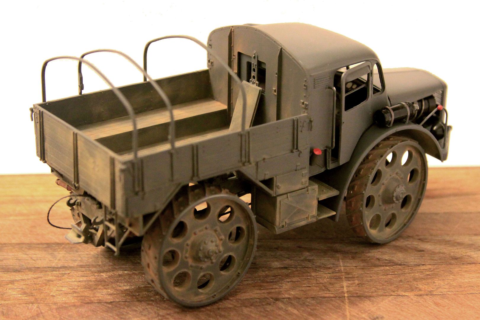

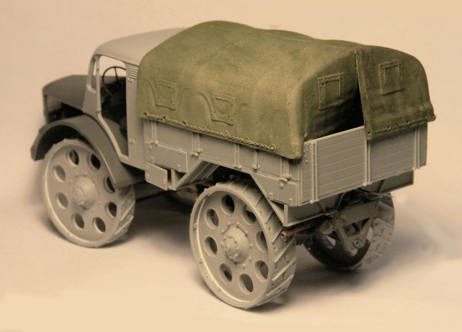

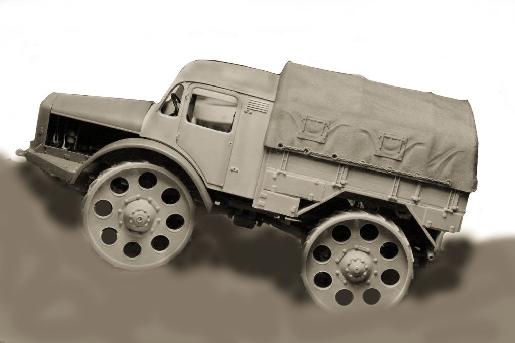

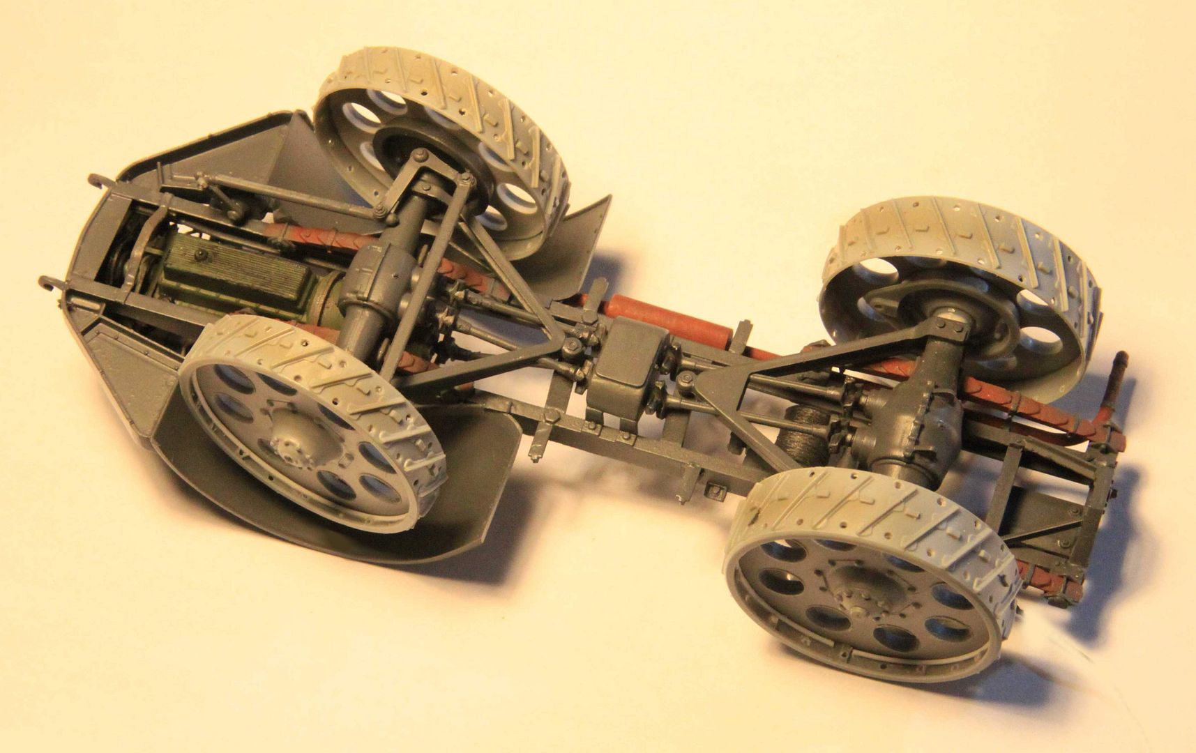

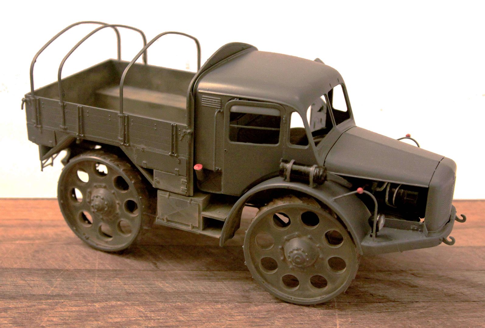

I do hope in-process conversions are also acceptable:
Converted Skoda RSO to back date it to look like the original prototype with perforated wheels, relocated air intake, more storage lockers and slightly changed drivers windshield treatments. Also I slightly altered canvas tilt for a bit more visual interest.
Build log on this RSO can be viewed at:
http://armorama.com/modules.php?op=modload&name=SquawkBox&file=index&req=viewtopic&topic_id=205790
(Prototype photo Skoda Manufacturing/Capricorn Publishing - shown here for discussion purposes only.)

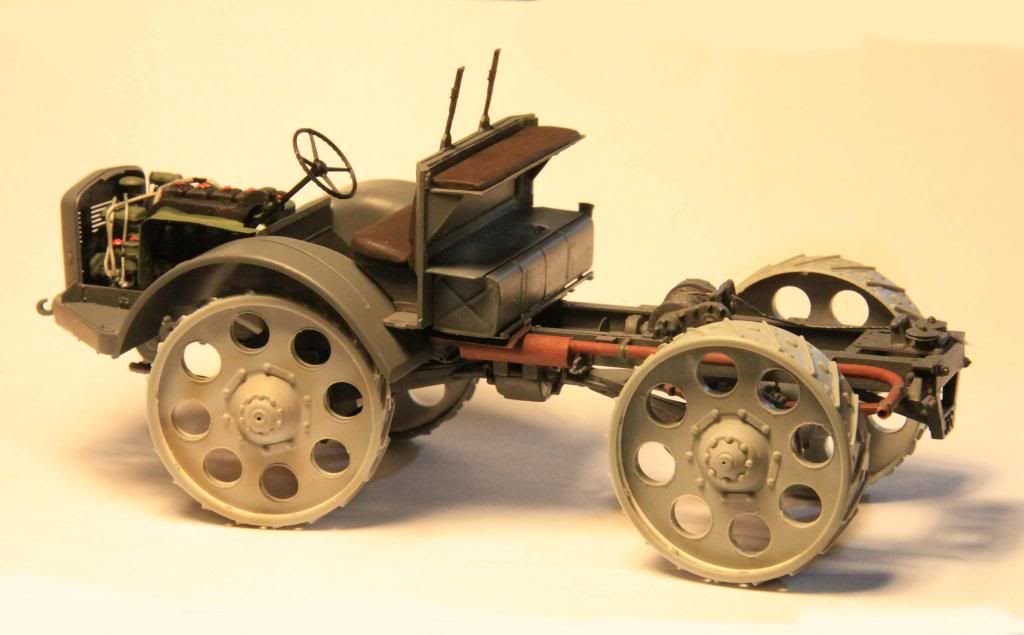

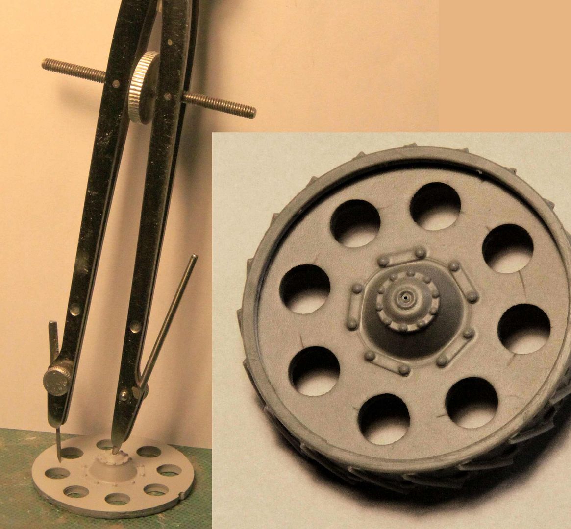

Don't think drilling out eight wheel holes times four wheels didn't make for a couple of very nervous hours!
I drilled a very small hole in the center of the wheel. (to be filled in again later.) I then used a compass with a cutting blade to scribe a large circle representing the circular centerline of the eight holes. After that I used a set of dividers to find the radial center point of each of the equally spaced openings. Fun (because it WORKED!) but nerve racking!

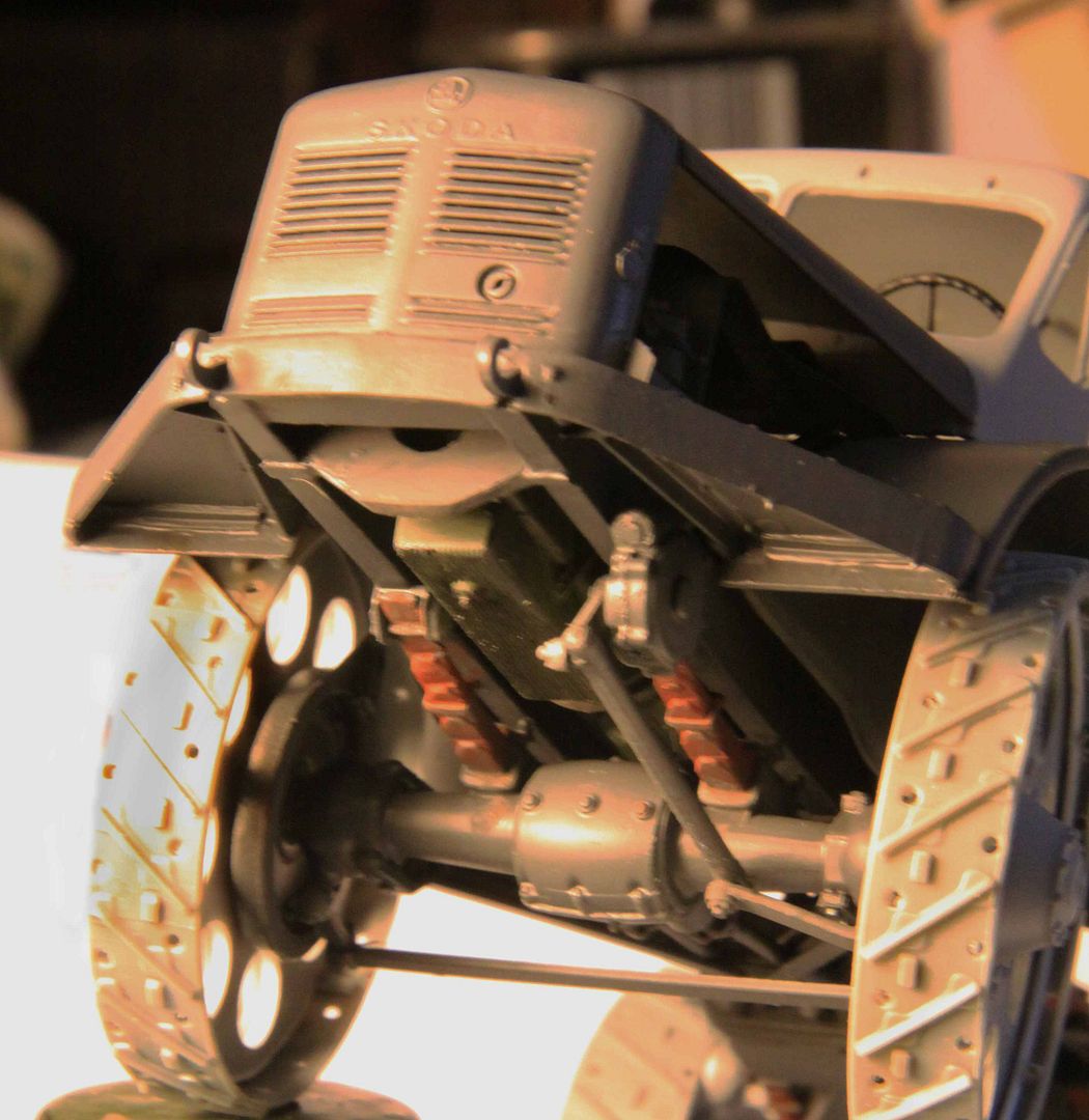

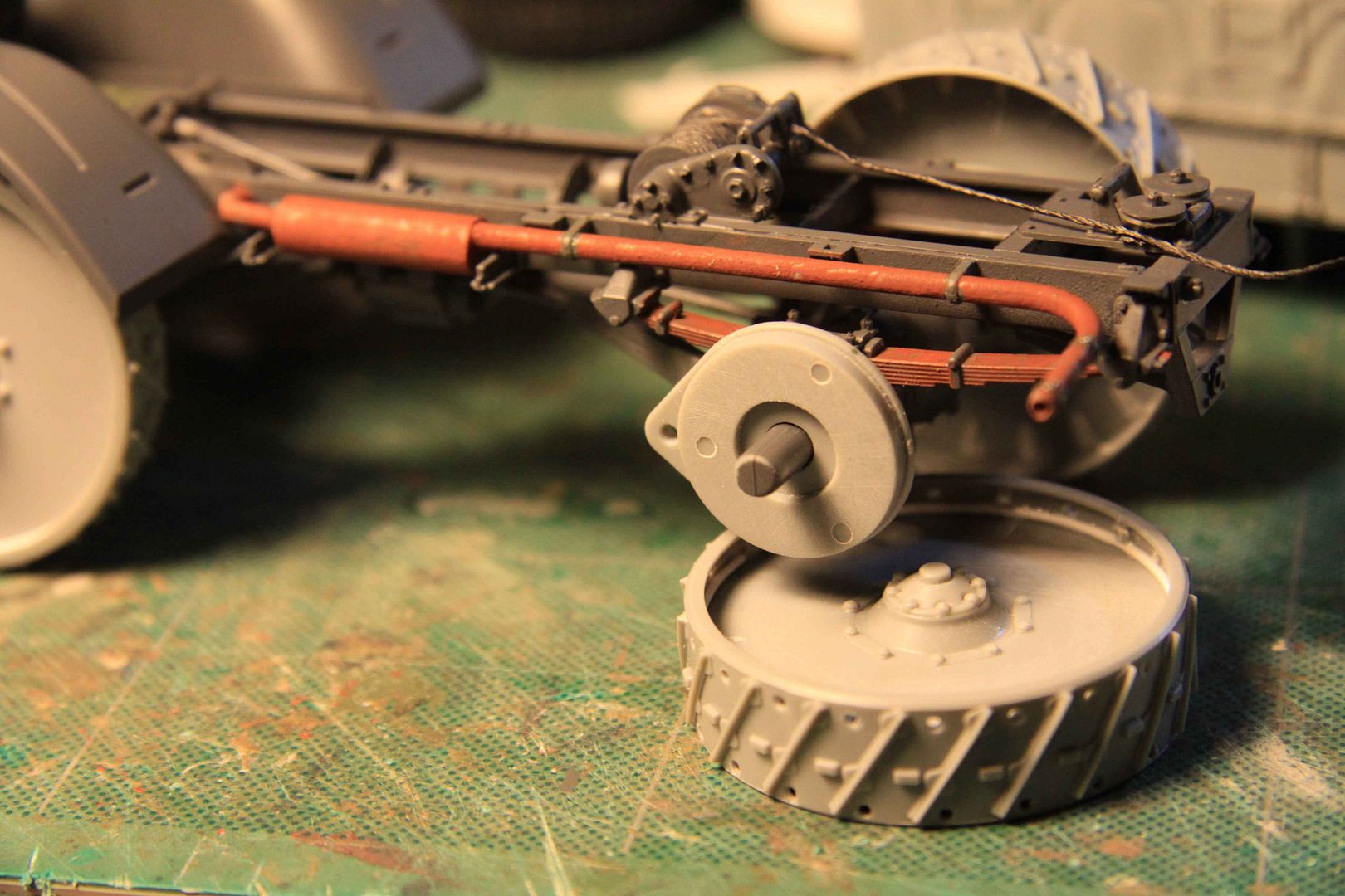

The undercarriage with some additional frame details of course. ( Added missing front engine mount cross member, missing front brake drums, brake linkage, relocated muffler and included the support frame for the gas tank. Will also be building the additional storage lockers present on each side just below the cab. )
The muffler on kit is too high to clear bottom of cab and gas tank. Must be moved downward just slightly to clear. Exhaust pipe now exits out the top end of muffler whereas before it was centered.
Front engine mount frame cross member missing from Riich kit
Current construction progress.

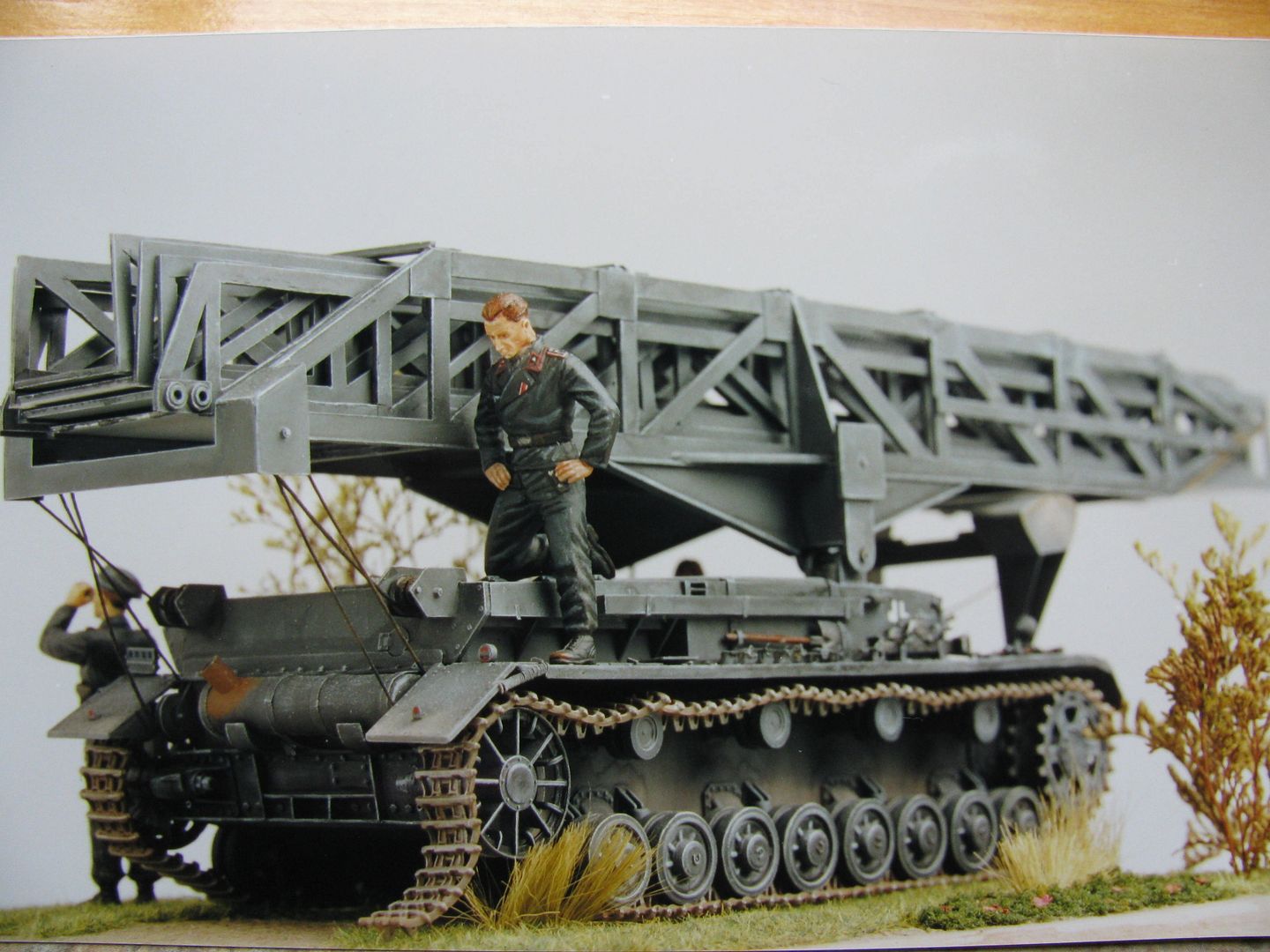

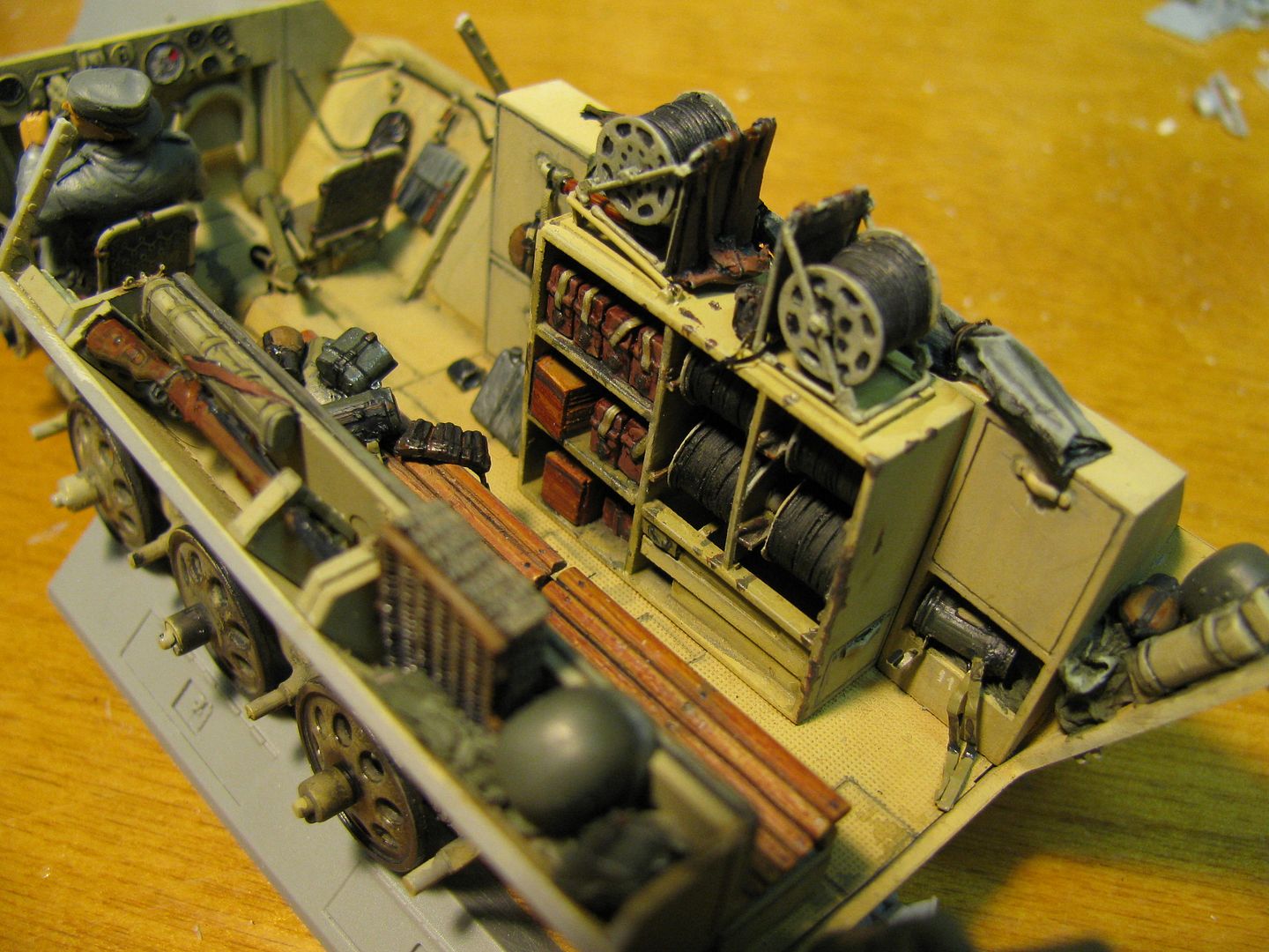

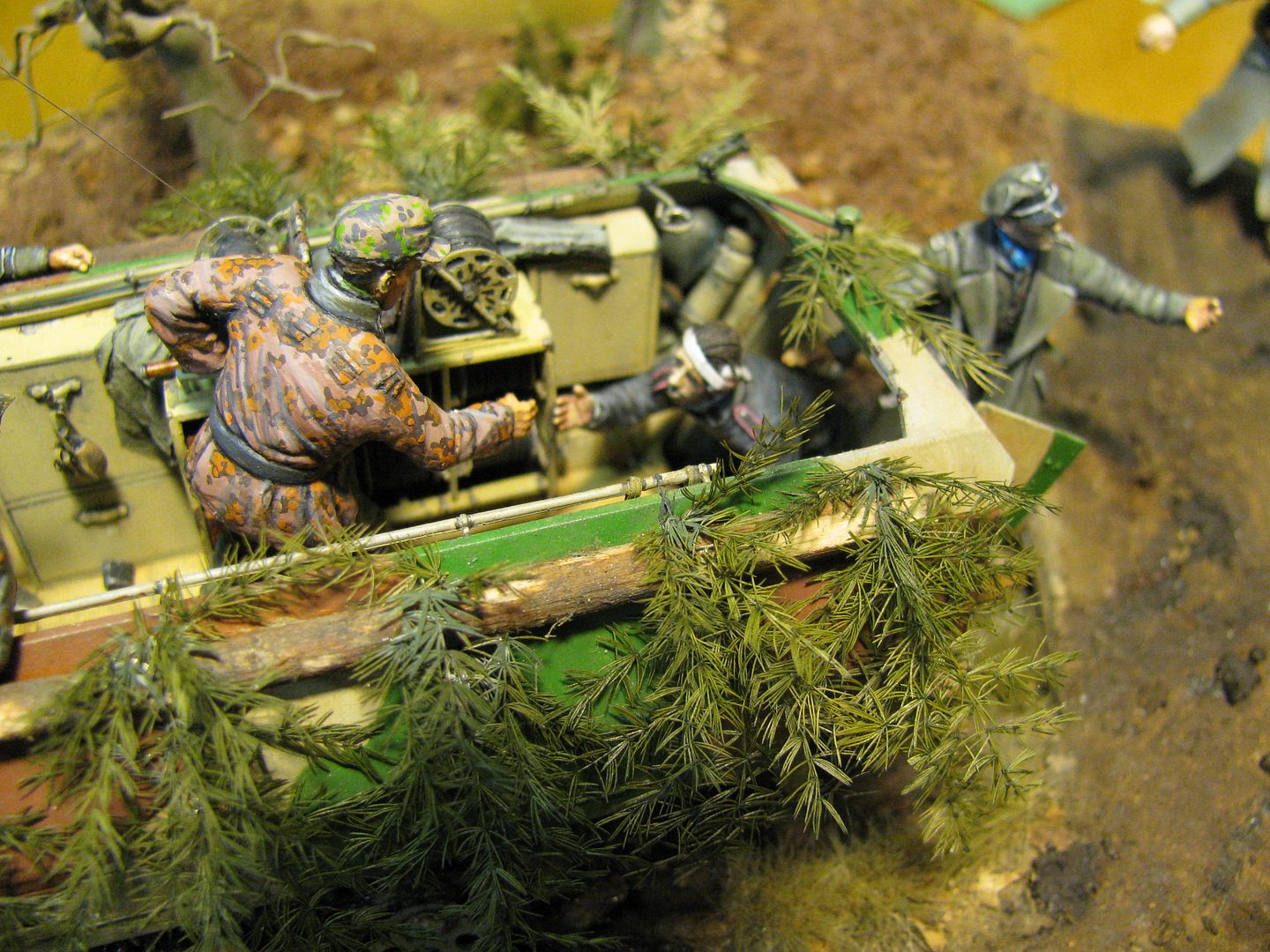

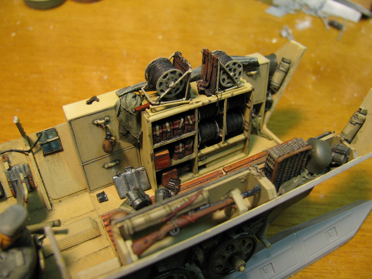

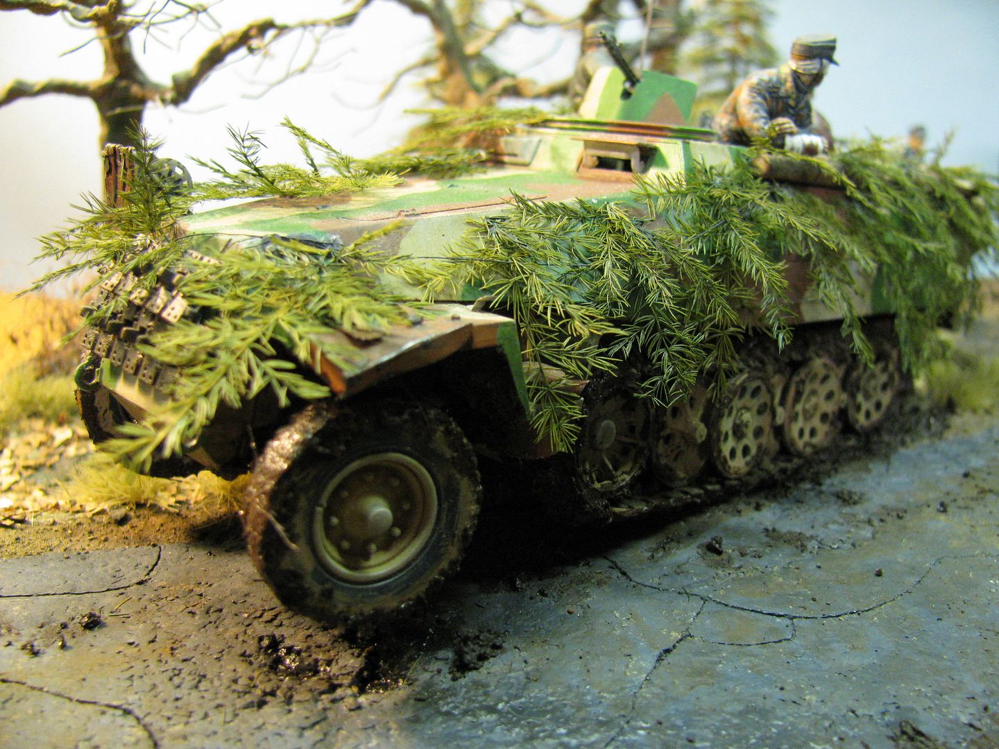

OK,my humble contribution to this thread would be this 251/11 telephone commo vehicle. Interior
exterior
Infantry assault bridge from about 20 years ago!!!
Completely scratchbuilt artillery limber for the late style LFh 18/40
I confess,most of my scratchbuilds were airplane related and so not relevant here. Also a u-boat conning tower in 1/35.

J, I very much like that signals interior in that 251. I myself am a Signal Corps person (photographer) but for the other side!
Thanks Jerry for your contribution!
Posted: Saturday, June 18, 2016 - 09:56 PM UTC
I thought that might be at the MVPA convention. Everything looks "new". I've been a member since around 1987. I was looking at the chain drive.
The signals 251 is nice. I had a German field phone once, it was black bakelite. A friend had one that was pysodelic yellow. German bakelite had some strange colors.
Posted: Saturday, June 18, 2016 - 10:02 PM UTC
[quote]
quote]
You did a good job.
quote]
You did a good job.
Posted: Saturday, June 18, 2016 - 10:24 PM UTC
Thanks - I was really amazed that I didn't mess up drilling those wheels in some way shape or form! I have a small adjustable speed drill press that made things easier but things still could have gone south in a heart beat!
One unseen benefit that came out of it all was that the drill was running at just the right speed to raise that slight little flange/shoulder around each hole. I noticed later that the real wheels had just that same small flange.

One example is on the Skoda RSO above: that shot where you can see the steering gearbox under the front axle. It clearly has a big seam down the middle but hey, in reality it was cast as two pieces and then bolted together with a seam (and a gasket) running around the centerline of the entire gearbox!
Another example is the transverse mounted leaf spring on the front of the Famo! We are in real danger there because the model piece has a center seam line running all the way around the spring. The first thing we would say is "Oh, gotta remove that" but the Famo actually had some sort of seam line running around the leaf spring like that. Perhaps the entire spring had a molded rubber boot on it to keep dirt and water from getting between the leaves????
Anyone else have a opinion on this or have had a similar occurrence?
As model builders we all spend more than a little time on the work of removing seams from our models. But what about places on our models where there are SUPPOSED to be seams? Ever remove a seam you knew was supposed to be there because you thought a competition judge might mark you down for "not removing it"?

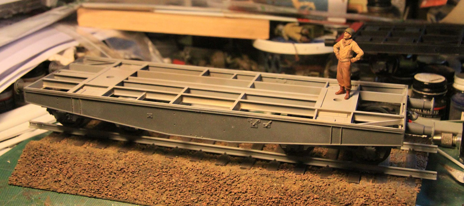

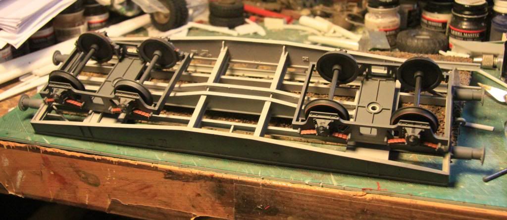

This rates up there with the questions about do interiors or engine and drivetrain corrections constitute a conversion?
It really bothered me that Dragon's heavy German rail flatcar was a gutless wonder, meaning that it offered no underbody detail at all! So of course I had to correct that. There is also a full air brake detailing set coming from LZ Models (Mirror) to add even more detail.
I'm afraid I could find no reference showing just how the underbody was framed up on the German flatcar so what you see here is a free-lanced "imagineered" design based on standard US railroad practice for freight car underframe design.
