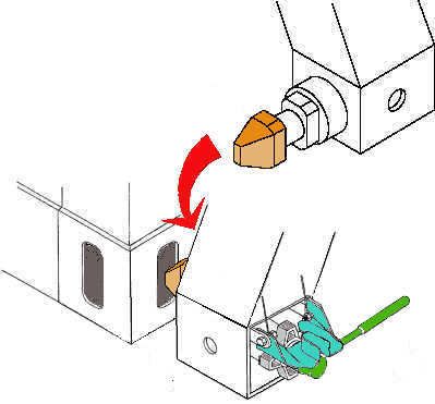

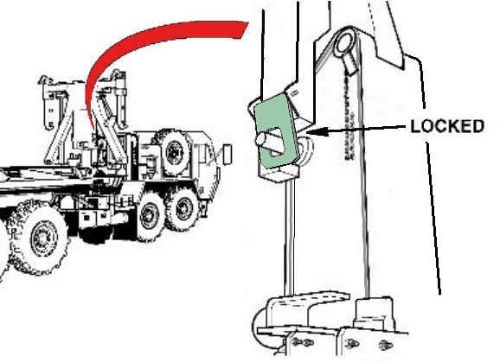

Some info into how the lower "Rotalock" locking pins work:
Lift that spring loaded retainer plate (Blue) and shift the handle (Green) to the horizontal position. You now have the Rotalock in the locked position. Finally turn that star shaped knob (Gray) to tighten the lock and take any slack out of the connection.
______________________________________________________________________________________________

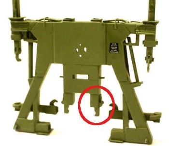

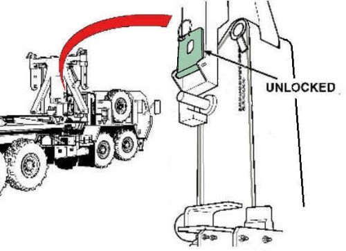

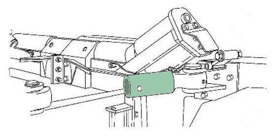

More reference, this time on how the the CHU can be locked to the lift arm when NOT attached to a container for transport:

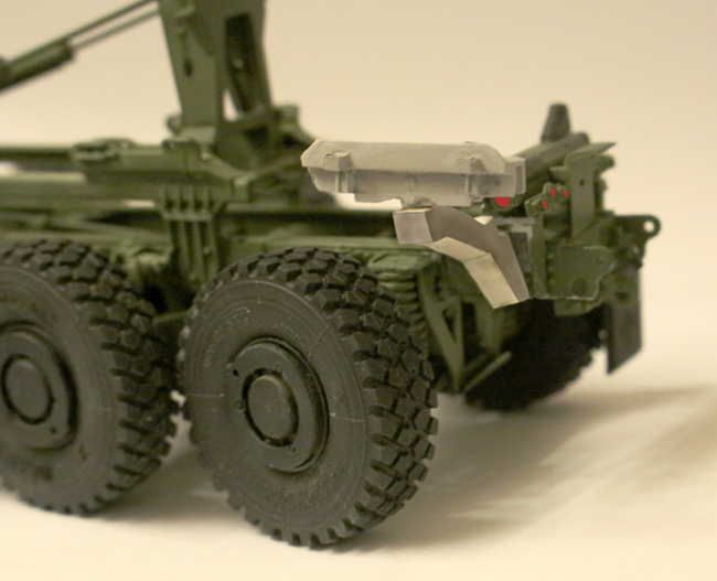

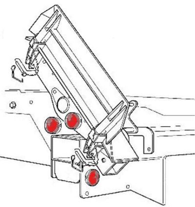

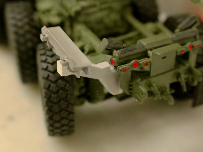

Still progressing on the
Container Support Guides for the rear of the truck.
Given the complexity of the folding support arms and the angle arms behind them, I think I am going to build these structures as fixed rather than actually have them fold up.

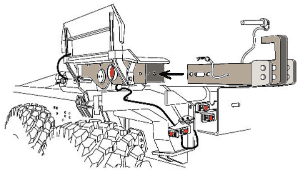

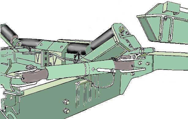

Posted: Tuesday, November 07, 2017 - 09:29 AM UTC
A little more reference on the guide tray:

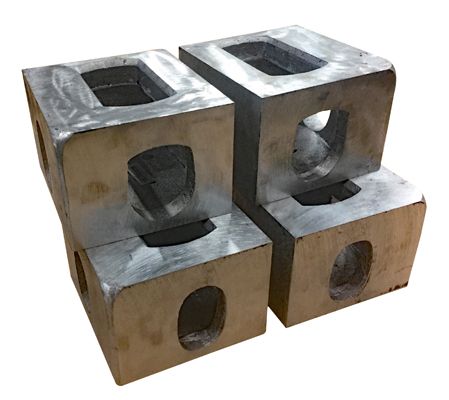

Coming soon from Mike Goldberg and Shapeways:
Corner key blocks for building your own custom containers.
The real deal: cast aluminum -

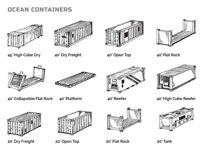

Looks like I might have to stay with a full-height container to work with the CROPS.
QUESTION: Does this look like a full-height container to you? I know it is not a half-height. It is clearly too tall to be a half-height. Cannot find any info on other height containers. The only two I find are the full-height, 8'-6" tall and the half-height, 4'-3" tall boxes.
Is there such a thing as a 3/4 height container?

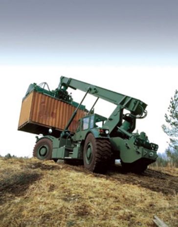

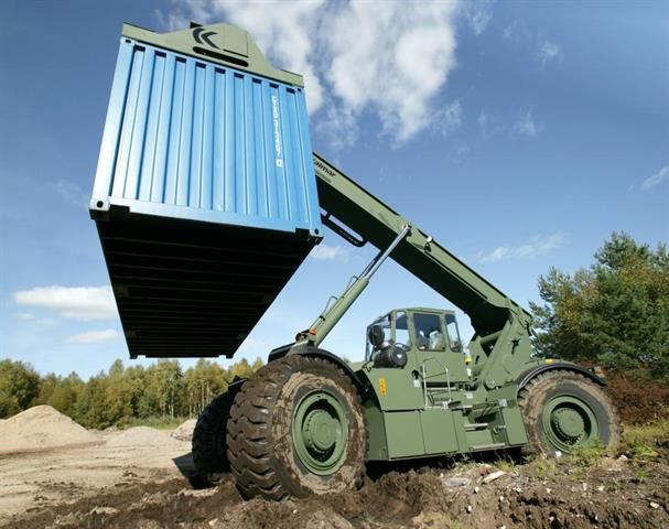

Posted: Thursday, November 09, 2017 - 04:22 AM UTC
Just a little bit off topic!

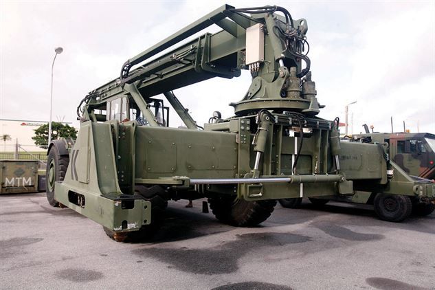

This one would truly hog the real estate on the display shelf but if someone decided to make this monster in 1/35th plastic I would have to have it!
(Photo by Kim Welch - Senior Project Mgr. - Army Corps of Engineers). . . . . . . . . . . . . . . . . . . . . . . . . . . .
I would pose it spotting a 20' container onto the back of my HEMTT or Mk 8x8 LHS.

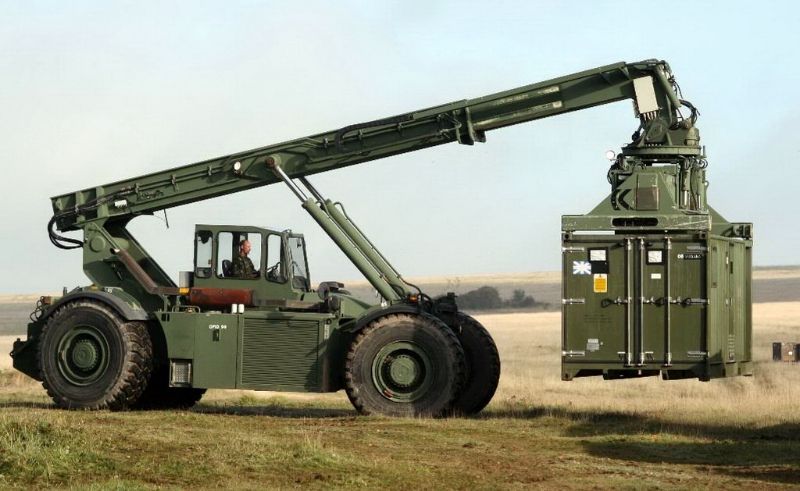

Posted: Thursday, November 09, 2017 - 06:04 PM UTC
There is the German version by Takom that includes the container lifting rack in the kit (top view on the box, in white UN markings).

Posted: Thursday, November 09, 2017 - 08:32 PM UTC
Aah, but Gino, that German forklift is such a pale substitute when you consider that other big monster. I know now how I would pose it; a dio recreating the center photo - all four wheels fully canted as the whole thing forges it's way up that muddy hill!
Posted: Thursday, November 09, 2017 - 08:48 PM UTC
p.s. Just learned - that vehicle is a Kalmar RT240 Reach Stacker:

Posted: Thursday, November 09, 2017 - 08:57 PM UTC
Sorry to correct, but the Feldumachlaggerät can`t handle containers. The FUG offers four possilbilities, short forks, lanog forks, a lifting hook and a snow/dirt blade for levelling the storage site. For Containerumschlag, we have the Geländetelekopstapler ORION V.
https://www.youtube.com/watch?v=mbctKG86nFA CAD Images mean nothing.
