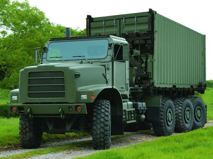

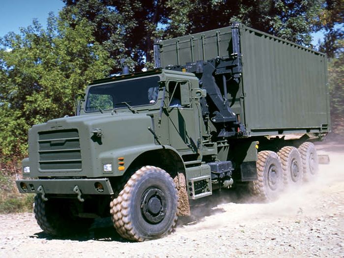

Mk ?? Conversion in 1/35th scale;

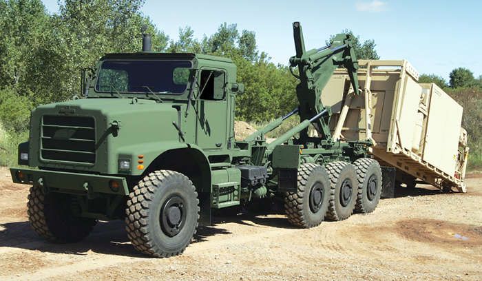

16.5 ton LHS - experimental offering from Oshkosh -
8x8 full time all wheel drive with six wheel steering:
I am starting a conversion project using the popular Trumpeter USMC & Navy Mk23, 7 ton, 3-axle MTVR truck kit. I intend to use multiple kits to produce the 16.5 ton 8x8 variant with Load Handling System (LHS).
Given the modular style construction of the Oshkosh TAK-4 suspension units employed by the Mk 23 this conversion should be fairly straight forward with the necessary frame extensions being the most challenging aspect.
Oshkosh Defense/Pierce Fire Equipment: Independent Front & Rear Suspension:
The 16.5 ton LHS vehicle employs a full time eight wheel drive with three of the four axles steering.

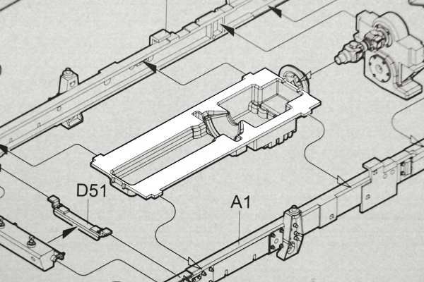

Posted: Thursday, November 10, 2016 - 11:33 PM UTC

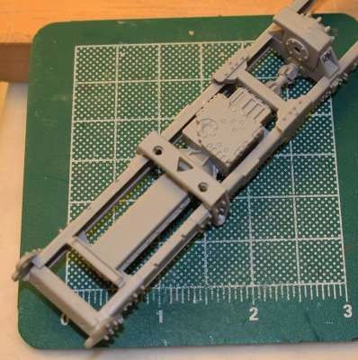

While on the subject of the model lacking an engine; a closely related complaint of mine is the inclusion of what I will call the low profile "splash pan" or "oil pan engine". This is where the model manufacture simply encloses the bottom of the engine area with a flat undetailed plate , I guess using the idea "who will notice anyway"?
Posted: Thursday, November 10, 2016 - 11:41 PM UTC

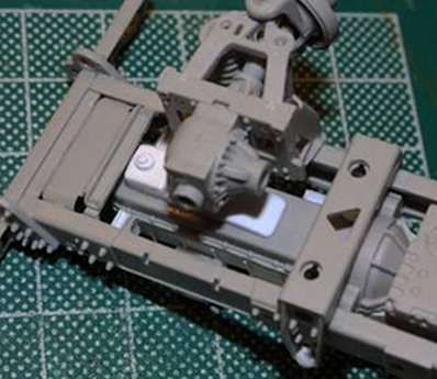

Whether you are building the 7 ton or the 16.5 ton version of this truck, right away I knew I would have to do away with the "splash pan engine"!

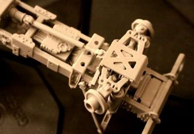

As you can see I cut out the "pan" but still left six "engine mount" attachment points.

I have a habit with my models that even when I don't build a full engine I will build a "low profile" silhouette engine to increase the depth of the visual affect when the vehicle is viewed from below.
I admit these changes are completely freelanced and not based on any actual research but I do feel it enhances the 3D affect of the engine area when compared to the "flat pan" treatment of the original model.

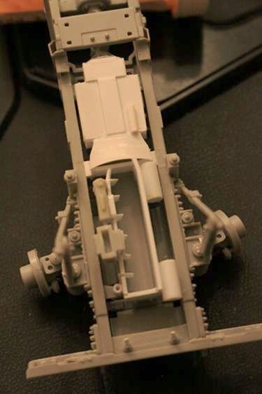

Current status of profile engine/transmission:
Shame that someone still has not come out with a resin engine, in that the big engine bonnet on this model could easily be posed in the open position.

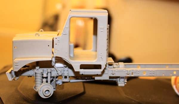

Posted: Friday, November 11, 2016 - 02:33 AM UTC
Front drive steering/suspension unit completed:

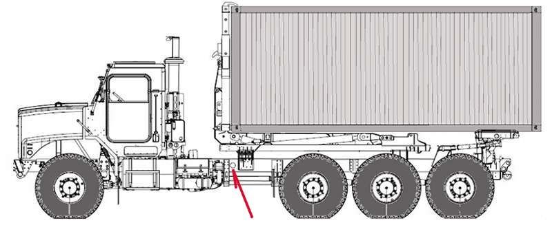

Stock Mk 23 6x6: (Drawing by Oshkosh Defense)
16.5 ton LHS 8x8: (Drawing by Blueprints.com - Unfortunately without dimensions)

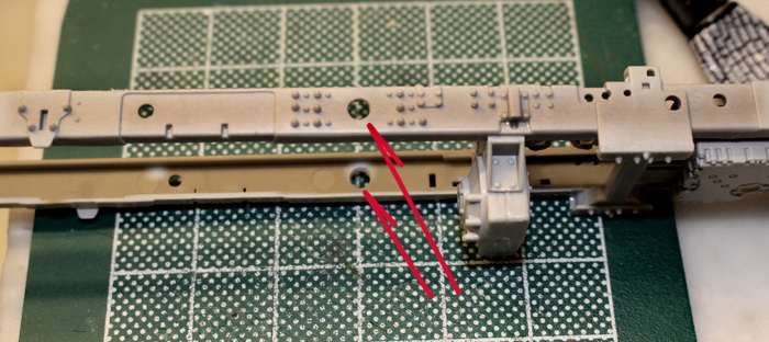

Red arrow indicates landmark perforation in frame rail that will be used to compute frame extension length.
(OSHKOSH Drawings reproduced here for discussion purposes ONLY.)
Posted: Friday, November 11, 2016 - 04:43 AM UTC
Again red arrows indicate landmark perforations also present in the model frame.

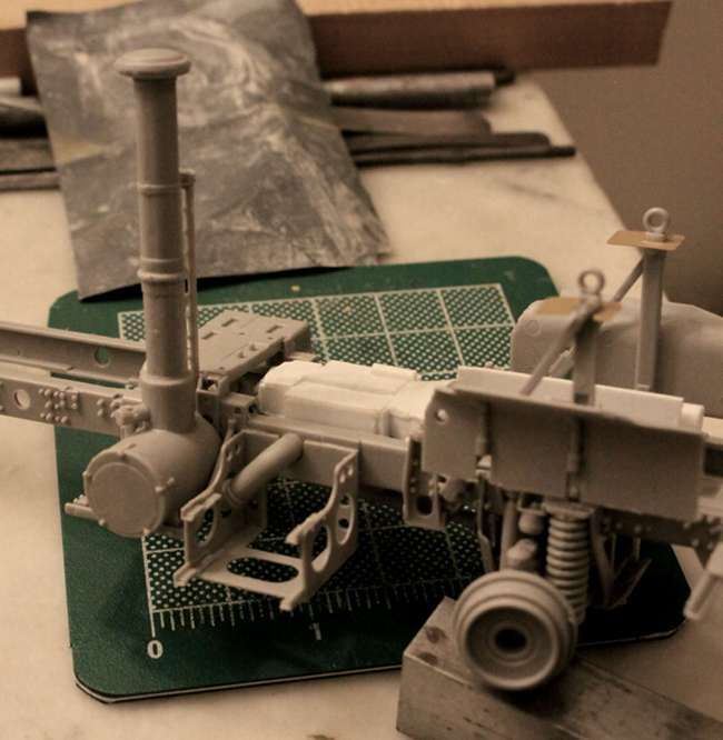

A little more progress this evening:
Lots of detail added: air filter and intake stack. On the other side, the battery box.

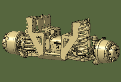

Drawing of powered front, #1 steering and drive axle:

In the TAK-4 suspension design EVERY axle is set up with what looks like a steering spindle at the wheel hub. However some axles are set up to steer while the others (in this case the #2 axle is locked down so as NOT to steer.
