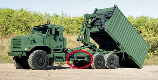

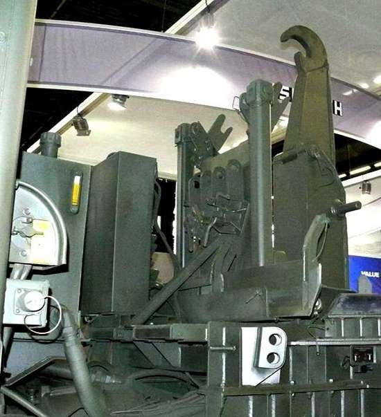

Maybe it is a version they are offering to the European market. Still not sure what is between the cab and lift mechanism though.
___________________________________________________________________________________________________________
That is a support to hold the X-Frame container loading fixture (CHU) when it is not in use. Then there is also the modular (electro-hydraulic) LHS control box behind it. It is the same one used on the HEMTT LHS

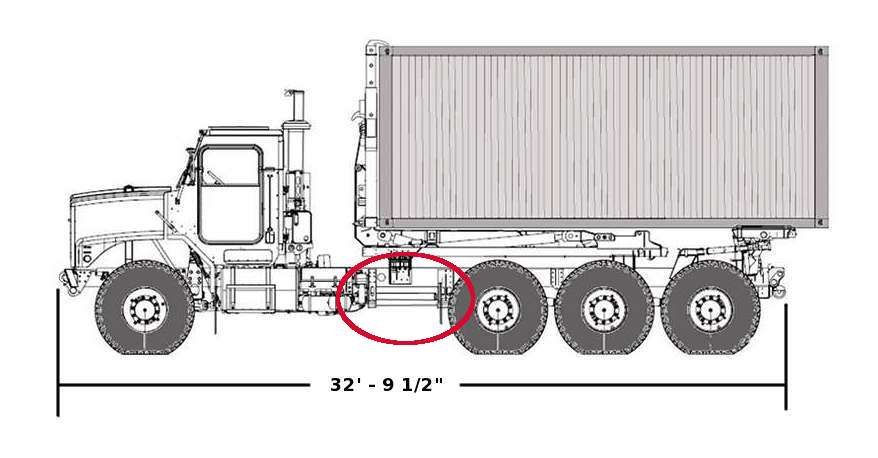

Anyone happen to know what this structure might be?
I thought it was torsion bar suspension for axle #2 and then I saw the third image and that changed my mind. How I don't know what this bar might be.
These are frame stiffeners, used by Oshkosh on all the longer frame Mk23 series vehicles.
Purely conjecture, but could it be a stiffener for the frame? Maybe that section of unsupported frame with the weight of the hoist/load at that point has a tendency to fail, so they added a bit more beef to that area.

Gino - I just do not know what to make of that structure. Doesn't look like the 8x8 has it so for now it doesn't affect me.

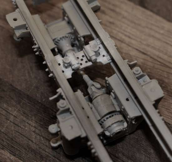

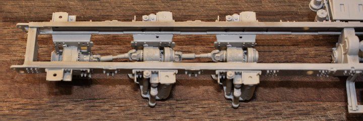

OK while I am waiting for the second truck kit to arrive from China here's the plan:
First: Add the rearmost cross member to the existing frame. Once the glue is hardened back there I will cut that part of the frame and shorten it a scale 14".
Second: Use the existing frame and kit parts to build the last two steering axles. Mount the two axles to the existing frame and set the wheels at a proper steering angle. Then build the frame tray to hold the two rear steering gearboxes.
Third: When the second kit arrives use those parts to build the #2 fixed, non-steering axle plus pass thru differential and use parts of the second frame to extend the overall vehicle to it's finished 32' - 9 1/2" length.

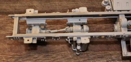

Step One: Shorten rear frame 14" - ROUNDS COMPLETE!
Posted: Wednesday, November 16, 2016 - 08:26 PM UTC
Step Two: Building the two rearmost axles and modifying them to steer. Off to a good start.
These three photos are real - no photoshop here.

You probably know these drawings already....
Full size

Once again this is photoshop and NOT actual cut plastic but the picture gives a good idea what is going to happen. What the final look of the steering gear will be, however, is another matter. (But I have an idea forming in my mind.)

Posted: Wednesday, November 16, 2016 - 10:20 PM UTC
Frenchy - thank you very much!!!!!
I have been trying to find this very drawing of the Mk23 4x4 without any success.
This is perfect timing as the last few days I have been wondering/planning just how I might cut the frame and the load box to build the shorter 4x4 bobber out of the left over spare parts from the two kits. WOW!

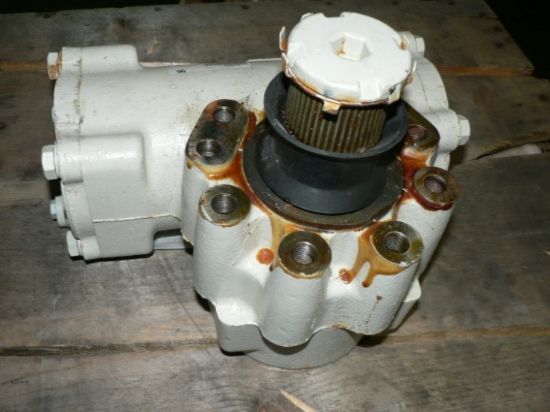

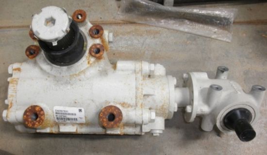

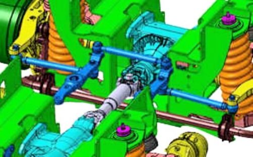

Talking about steering gear on the Mk23:
Main driver controlled steering gearbox.
Secondary slave steering gearbox.
Posted: Wednesday, November 16, 2016 - 11:39 PM UTC

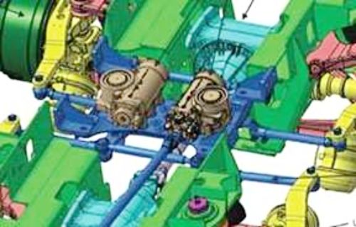

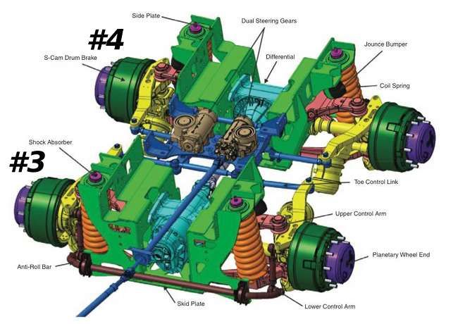

A Pierce Fire Equipment image we have seen before - the two-axle "rear steer" structure:
Close-up of the steering gear deck:
Close-up of unequal pitman arms with steering deck and gearboxes removed.

Steering gear deck installed:
I used the steering gearboxes here that were originally intended for the front axle. I will finish the steering work on the front axle assembly when the second Mk23 kit arrives.
