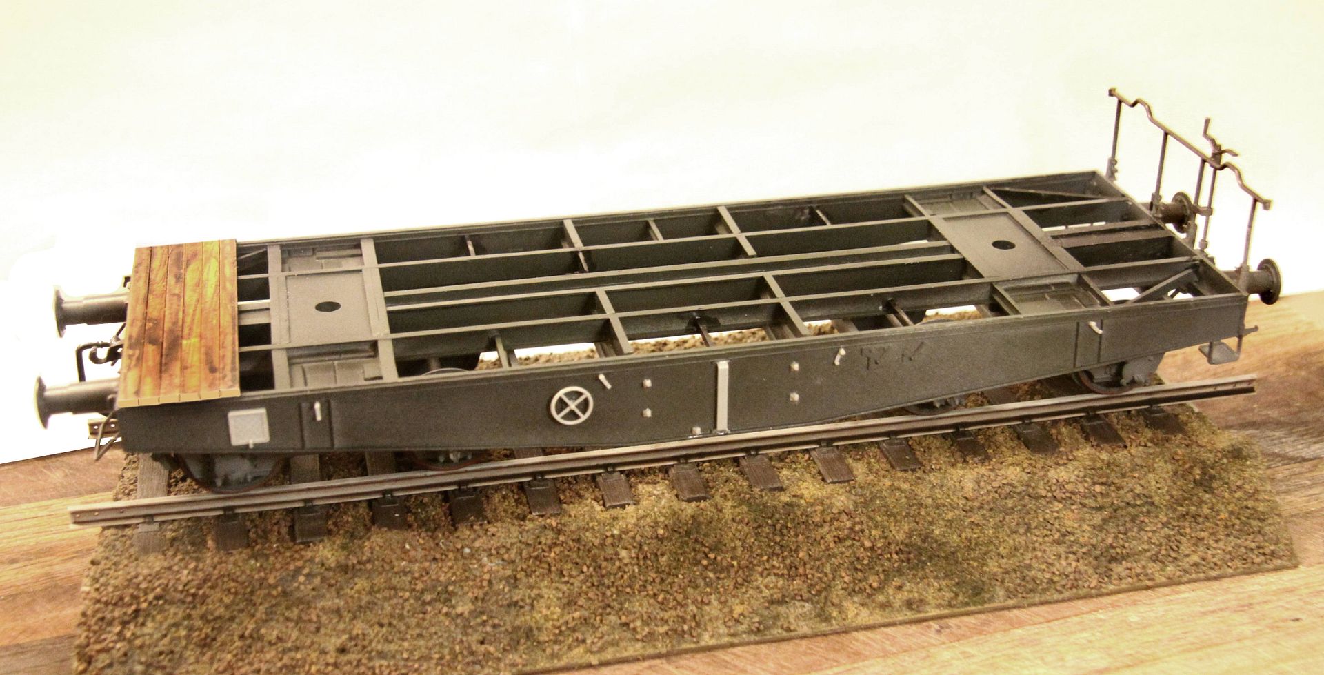

As mentioned, I made a start today. Kicks off with scribing the underside of the flatbed. Used the parts that fill the tapered, a double planked part, as a guide.
Plastic is quite soft, so it went real fast doing two sides.
First plastics to glue on are the base plates for the bogies. some scraping and sanding was needed to get it all flat.
Rest is pretty straight forward, so I finished the first 3 steps today.
Tomorrow the steps will include the cross sections and the fronts.
I will need the sides to figure out if all is square and lined up.

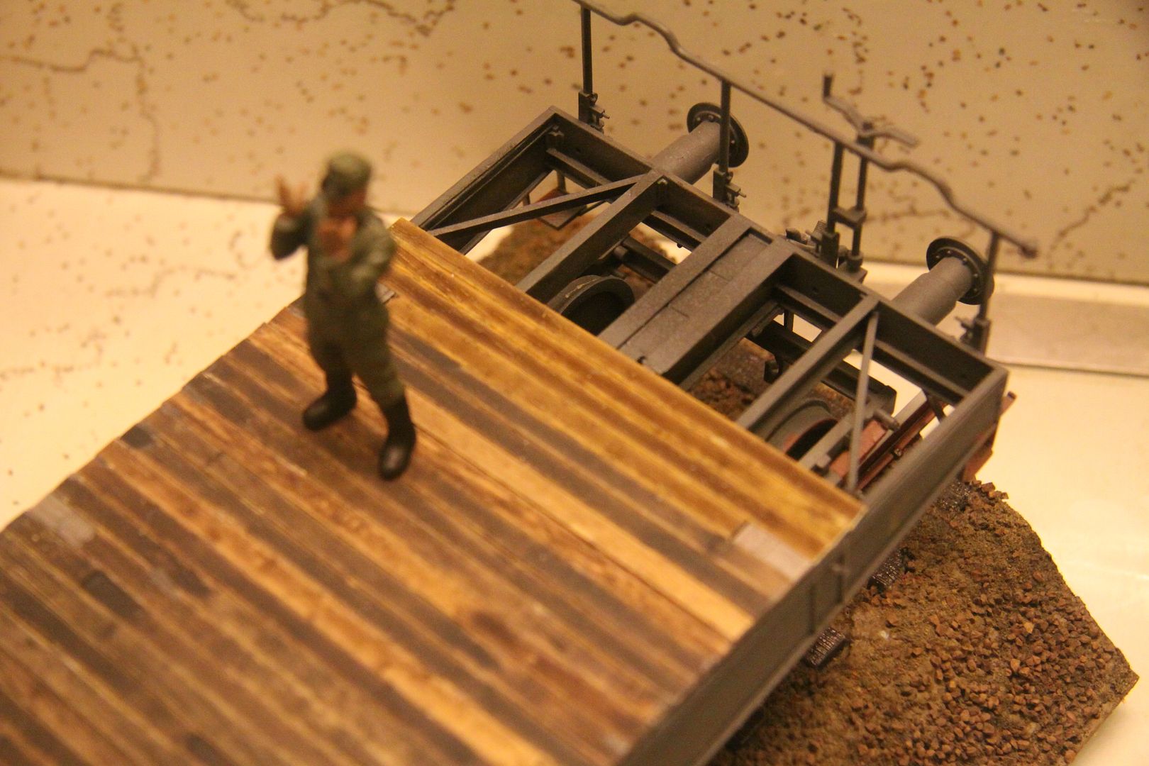

You might substitute "distressed" and stained strip plastic, or even real wood strips for the flooring.
(You have probably considered and discussed this elsewhere in this thread, If so I apologize for the repeat.)
Heavily modified car under construction.
Individually stained and distressed deck planking almost complete.
Underside view of stained deck planking.
