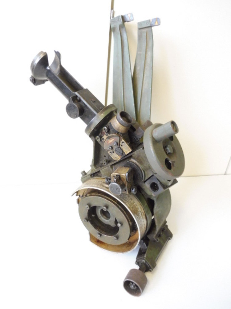

I read somewhere that (German WWII) artillery sights were dismounted and stored while transporting the guns to avoid damaging them.
However, I have not been able to find a good image of how it looked and which part(s) were removed, as either the photos are blurry/dark there or the area is covered with a tarpaulin.
I am looking for the leFH18, but I guess other German guns would be similar.
Anyone can help? Thanks in advance!

Here's the Panoramic Telescope Rbl. F. 16 (Rundblickfernrohr 16 (Rbl. F. 16) ) used with the 10,5cm le FH 18 :
http://www.questmasters.us/sitebuilder/images/German_RblF_16_Optic_Sight_with_Box_001-827x520.jpg
http://www.questmasters.us/sitebuilder/images/German_RblF_16_Optic_Sight_with_Box_002-365x520.jpg
and here's a view of the sight mount :

And where was the gunsight box kept during transit...strapped to the inside of the gunshield, or stowed in the towing vehicle?

I'd vote for the latter, as I don't see any mounting brackets for the box on the shield...

Look her for the complete gun sight in its transport box:
https://www.kpemig.de/Wehrmacht-Rundblickfernrohr-16-im-Behaelter-dieser-ueberlackiert-Klare-Optik
Doesn't look like something I would attach to the gun when it is shaken around during transport.

I wonder if the Zieleinrichtung 34 was also dismounted or kept in place...
