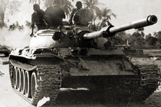

found this picture on Bing search
https://img.etimg.com/photo/56124150/1971-indo-pak-war-tank-bccl.jpg
ChiefGunner
Setubal, Portugal
Joined: July 24, 2010
KitMaker: 205 posts
Armorama: 203 posts
Posted: Thursday, September 17, 2020 - 11:43 AM UTC
Hi Ted
Thanks.
This is a T-55?

https://en.wikipedia.org/wiki/Indo-Pakistani_War_of_1971#/media/File:T-55_tanks_in_the_Bangladesh_Liberation_War.jpg
This is a Wikipedia image of a T-55 with a dummy bore evacuator at the midpoint of the barrel, simulating the British 20 pounder seen on Centurions.

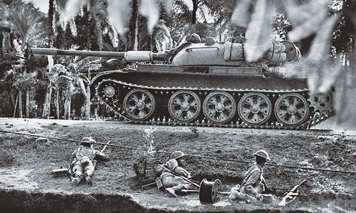

Posted: Thursday, September 17, 2020 - 08:30 PM UTC
Just a few period pics :
Full size
Some tanks retained their fake extractor after the war.
This picture has been taken at the army's firing range in Ahmednagar, Maharashtra on 02 January 2006 :
Looks like there are several variants of the fake extractor, and its location varies as well...

The fake bore evacuator and oil drum at the turret tear, were to distinguish them from T-54/ 55's in Pakistani service.
