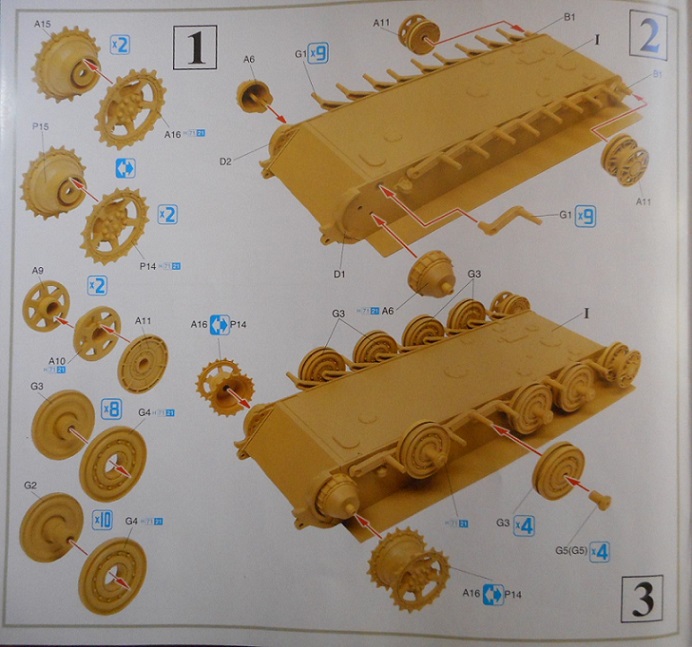

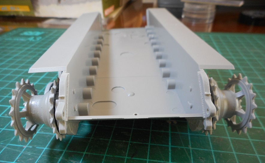

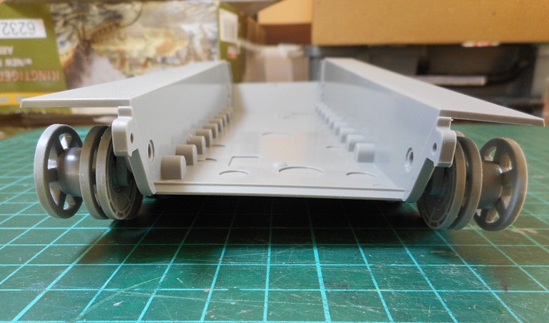

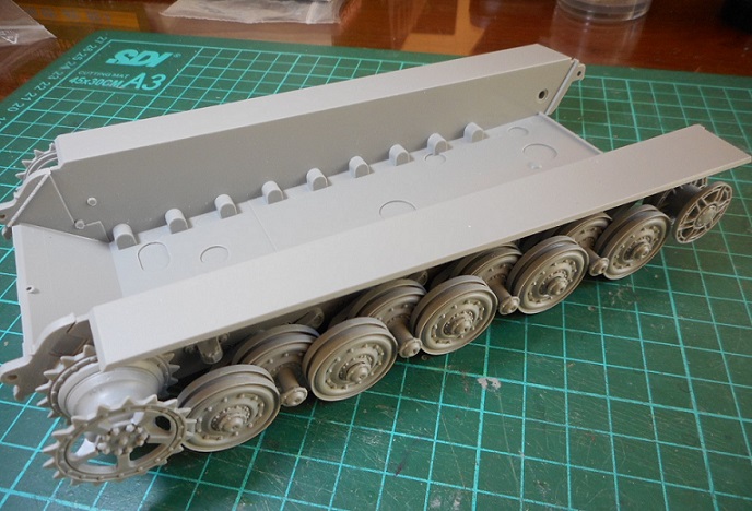

Hi All, I present my new project, It is a King Tiger, Late Production of Dragon, The number of the kit is a 6232, a kit of 2004. The model is acceptable, it present some marks of injection, the first advances:
Regards, Omar

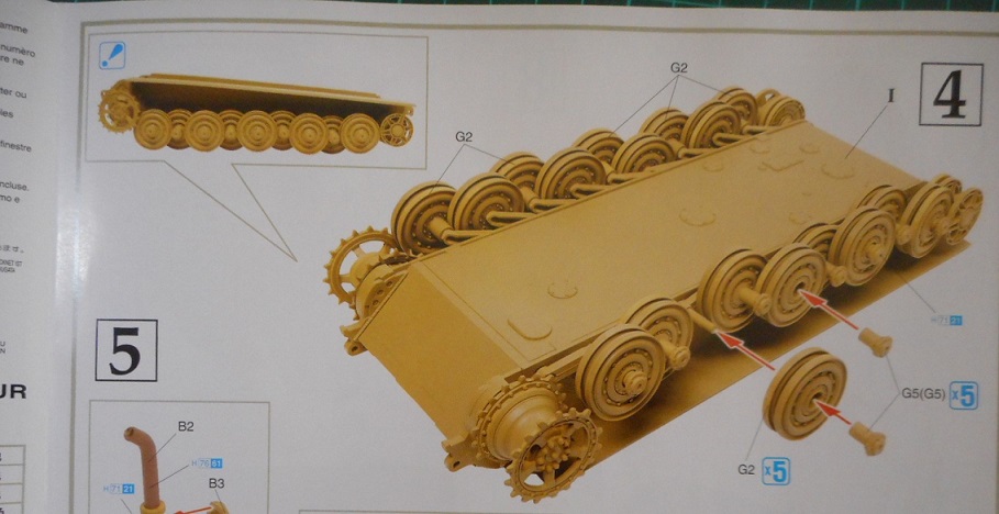

Hi All, more advances with the King Tiger, steps 6 to eleven, with yours comments I have decide to change the Unit of the model, It will be the Tiger II, PzAbt. 511, in may of 1945, the pics:
I found this pic, of that tank, and in the osprey book (KONIGSTIGER) has a draw too, that I can use like a reference...
Regards, Omar
