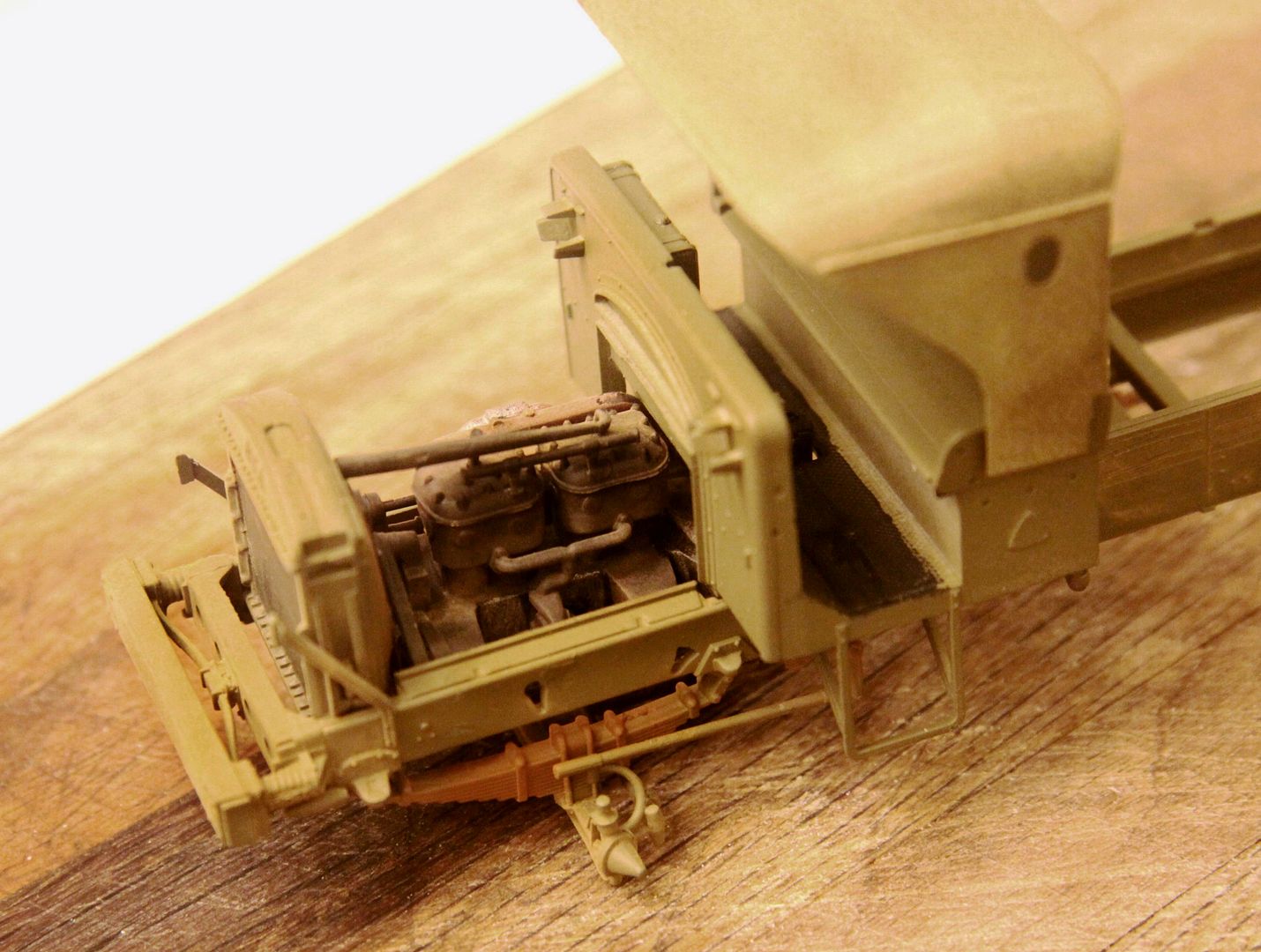

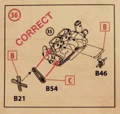

IN STEP #36
The instructions would have us attach the main fan pulley to the main engine crank shaft. To do this would prevent the engine block from mounting in the forward engine mount. In this truck the starting crank attaches to the main engine crank shaft and the fan pulley attaches to the forward engine auxiliary gearbox.

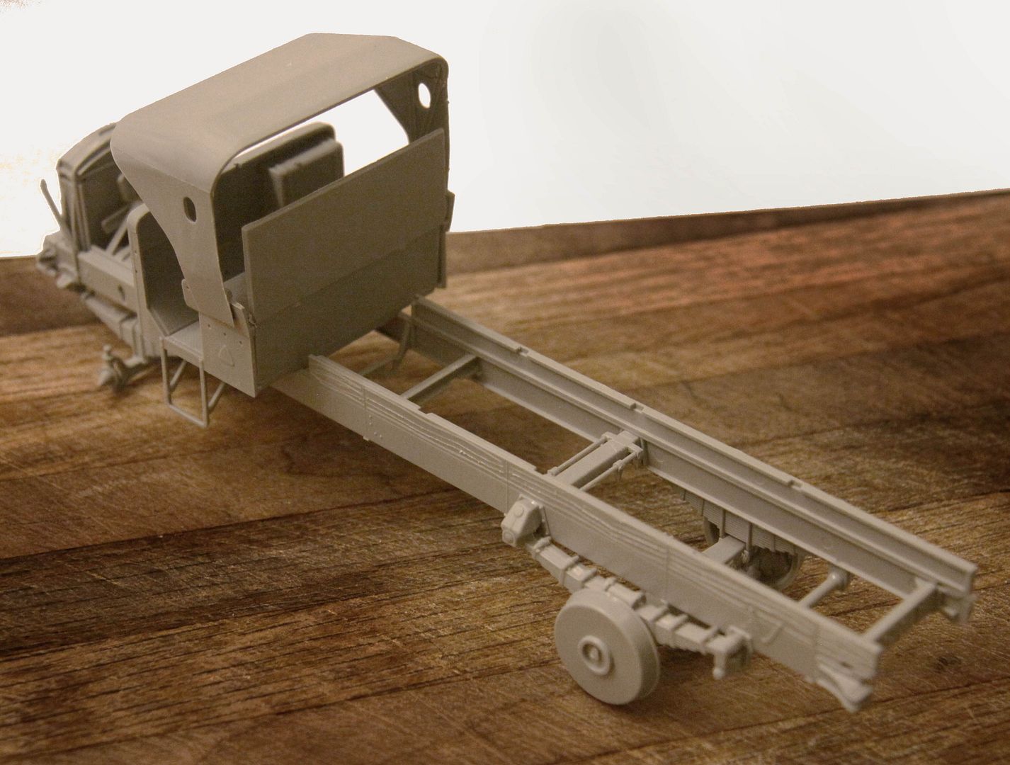

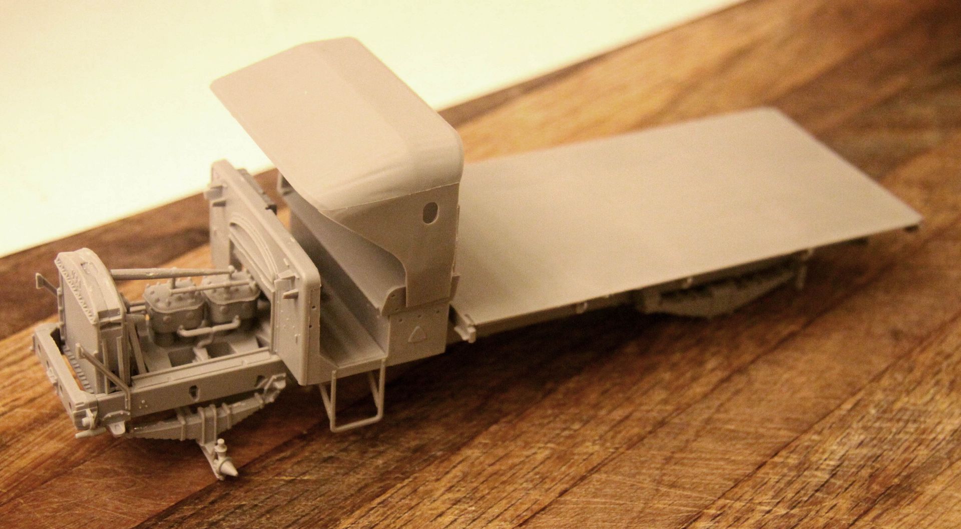

The Liberty B uses the typical ladder frame construction and ICM chooses to make up the chassis from separately molded side frame girders and cross members. While this requires a bit more care in construction it yields a much more highly detailed result.

I told myself I would make this a one and done, straight out of the box build but I am more than a little concerned about the absence of a back wall to the cloth cab. That omission does not make a lot of sense to me. The reference photos that John R. provided clearly shows a cloth rear cab wall on the truck at Ft. Eustis. Beyond that even the ICM box art shows a cloth wall in the rear of the cab WITH A WINDOW EVEN. So I am now mentally working out how to create one for my Liberty truck.

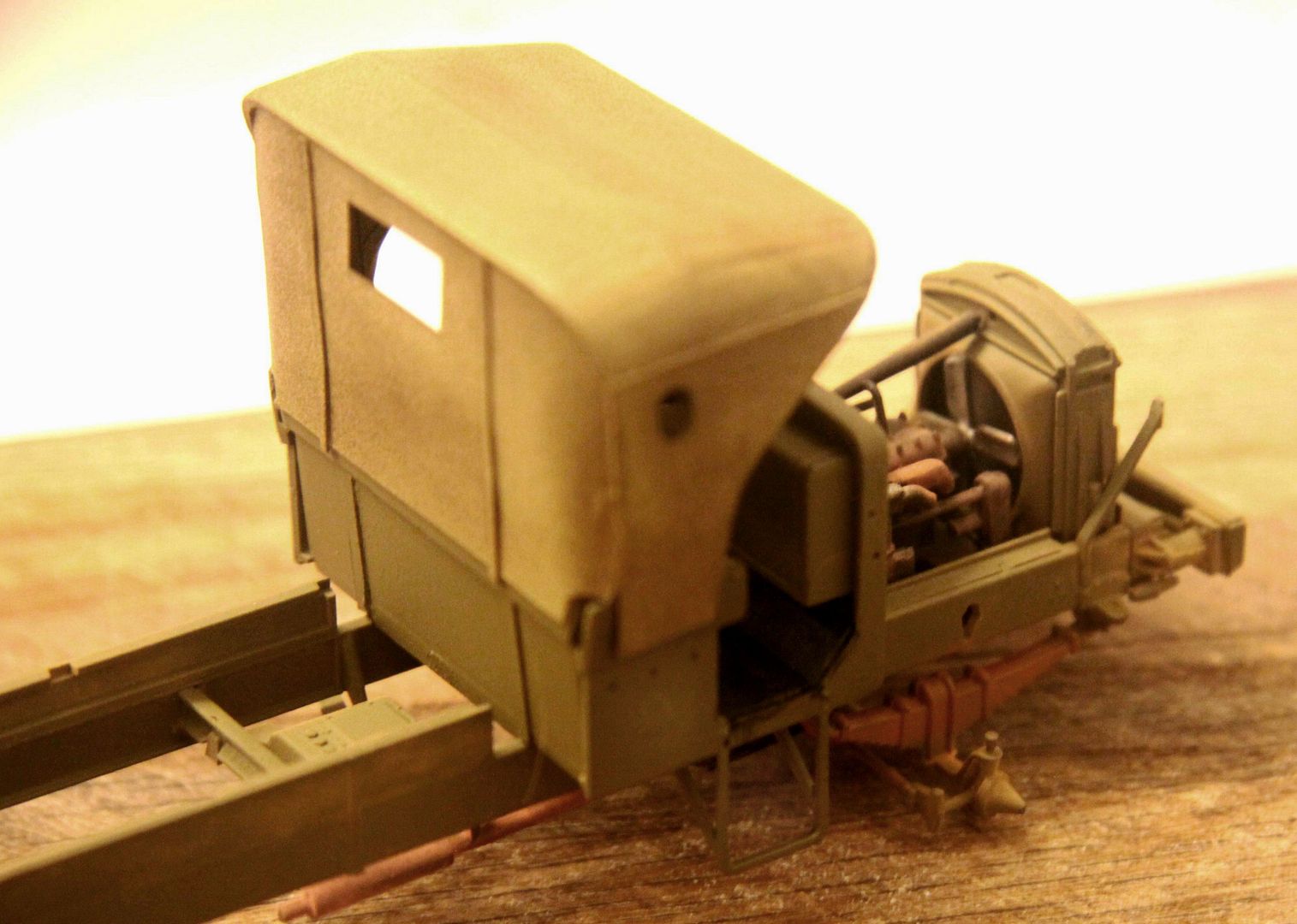

Here is where things stand as of close of business Sunday night. A little paint and a little pastel weathering have been added.
(Sorry for the questionable quality of these photos - it was very late/very early!)
p.s. "Steering" those wheel hubs was just a matter of grabbing the spindle with a pair of small pliers and very carefully adding a small twist. The front axle and hub assembly is very accurately molded and the kingpins can easily be rotated ONCE with caution!
