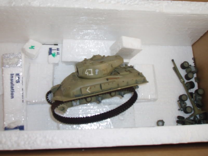

I'm packing up all my models right now, and have a different method
Plastic shoe-box, Styrofoam, lots of cutting, peanuts, and glue needed -certainly more labor intensive.
Line the bottom with a thin layer of Styrofoam. Use a thicker layer on top (glue it), with a hole in the middle cut out in which the tank/model smugly fit (usually the running gear takes that little pressure)
Cut other pieces so that the turret, gun tube, etc secured by them, and unable to move, and it fills out the box (so that these Styrofoam pieces cannot move by accident either).
Fill up the remaining space with peanuts.
I have to say, it takes a while, but it does not let the piece move. I can upload a few photos if someone interested.

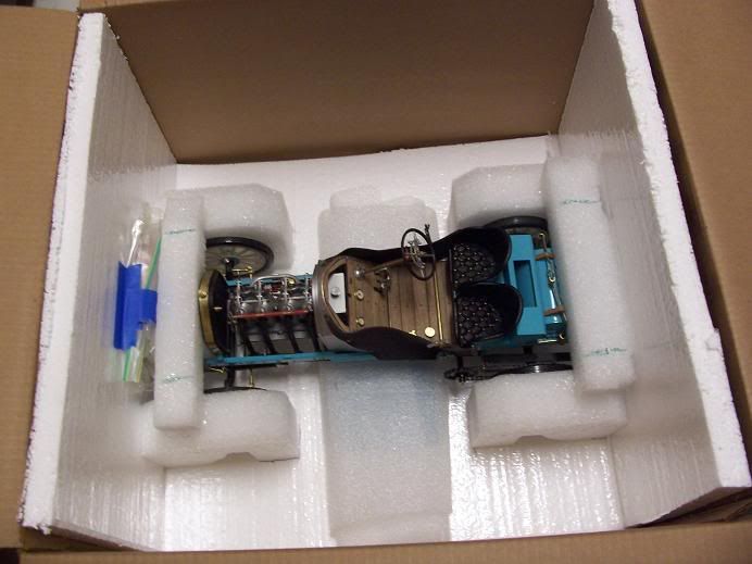

When I do it if I sell anything from afv's to ships, to $1000+ pocher builds, I use styrofoam bases. I either wire it down or built a frame to support it with foam and hot glue(this takes practice with foam). Then build supports to anchor the 'base' up the sides so it can not move. Essentially the model 'floats' so even if it is inverted its ok. This is always double boxed so no impacts hit the box with the fitted base directly. The heavier foam used for this Pocher (24" long, $900)was from computer equipment. And all the new owner had to do was lift out the vertical side panels and snip the foam on the 4 green lines with scissors.
It's trickier, but I've even shipped 1/350 battleships with hundreds of pieces of etched railings, masts, and whatnot. I would 'frame' out the shape of the hull so it can't slide around, build 'bridges' over the turrets with foam, build pieces that sat on the turret tops(the only place not covered with etch), and support the bridges to the box edges so it can't move around.
